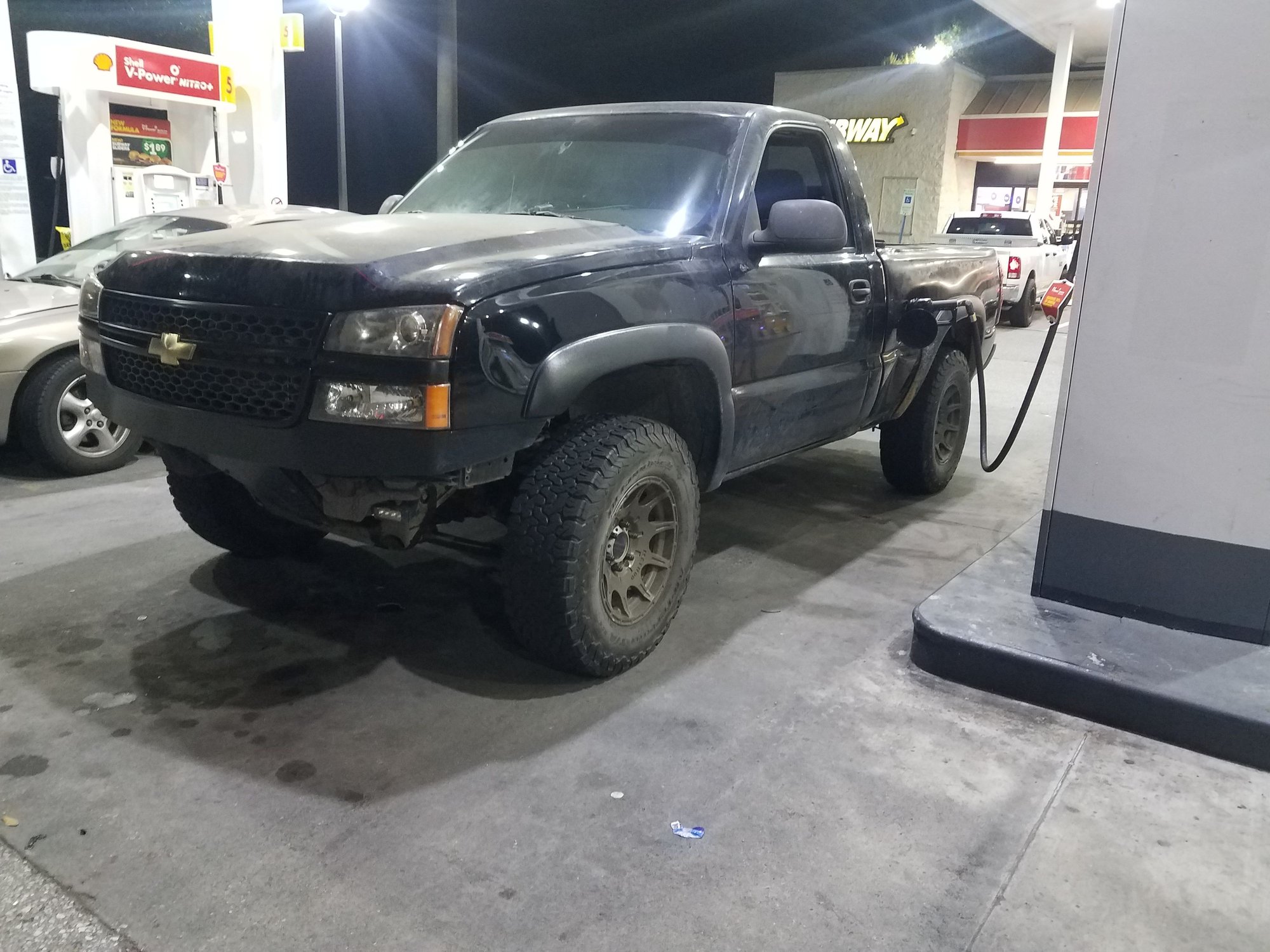

Wrangled enough neighborhood drunks to get the bed and tail lights on. Needed gas badly so drove it to town and even made it to a taco shop about 35 miles total.
Yes I know the body looks like
