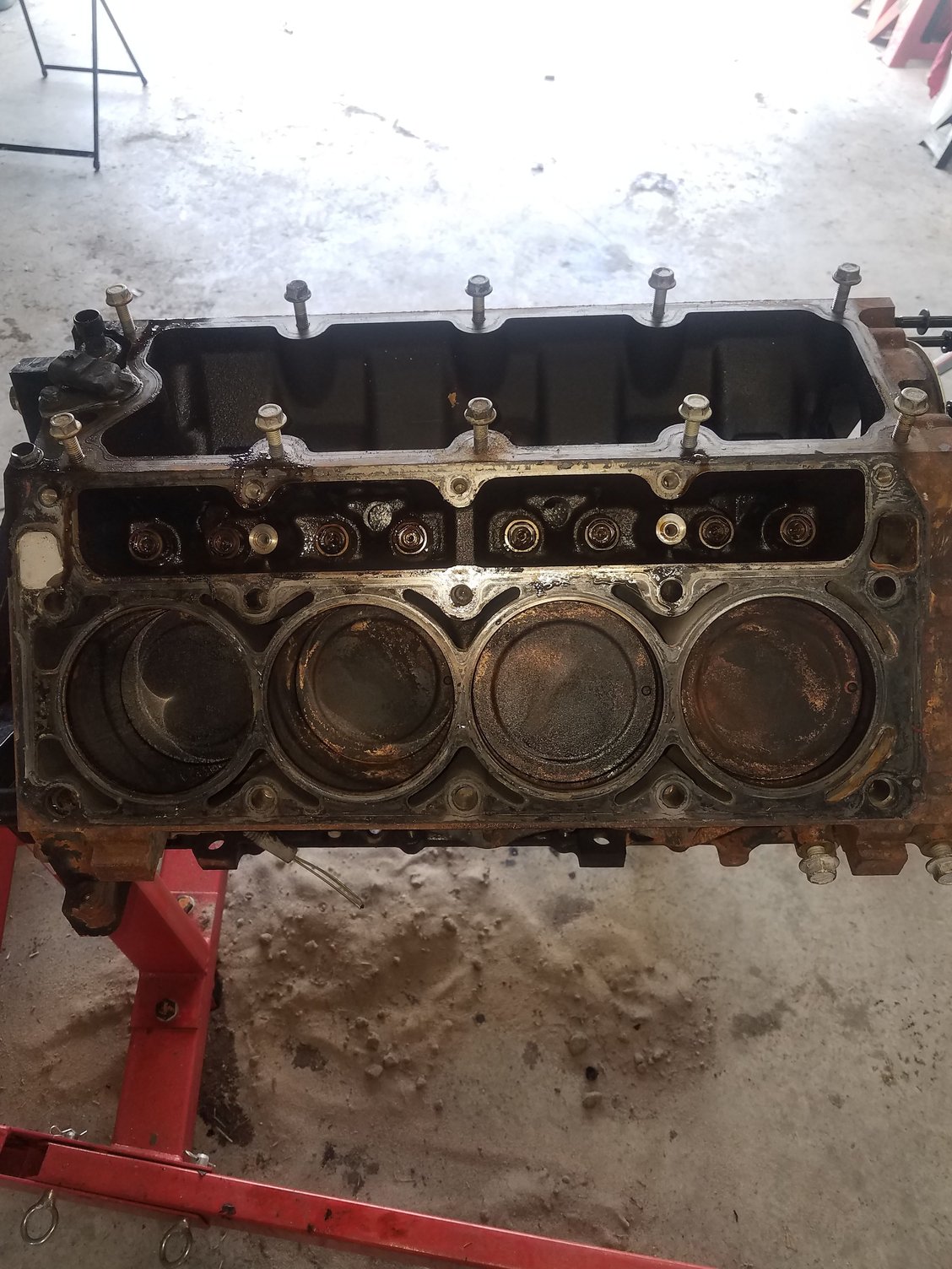

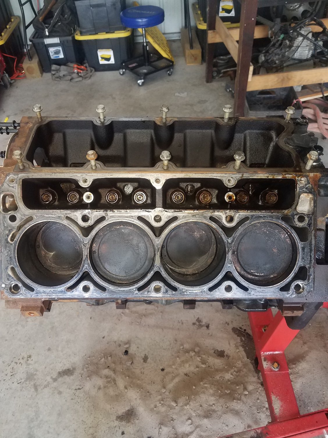

Well tonight I was pulling the cam everything was cruising along great and about the time I had the cam halfway out it seemed to hit a wall. I had the 5/16 wood dowels in place and the rockers removed completely before I ever began to pull the cam. I also spun the cam around multiple times to make sure it pushed all the lifters up. I tried for a few minutes wiggling and pulling but became concerned. So I flipped the motor over pulled the pan and windage tray to see what was going on. It looks to me like a bearing somehow came out and is wrapped around the cam stopping it from coming out anymore. I wish I could get a good picture but my phones too big to get a decent angle.

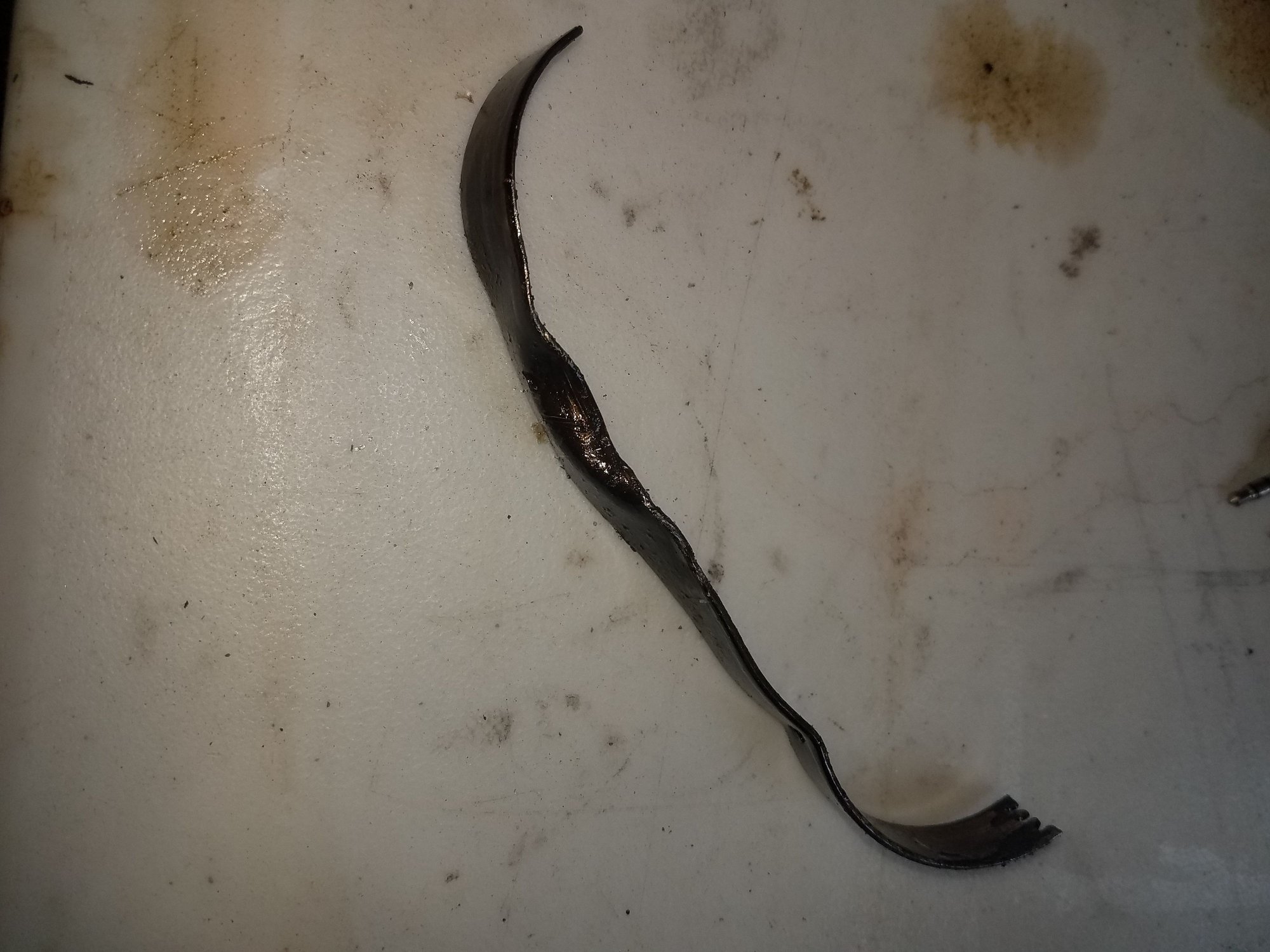

Ended up getting a hold of the bearing and pulling it out with long needle nose pliers heres some pics.
Is that mangled thing indeed a cam bearing?

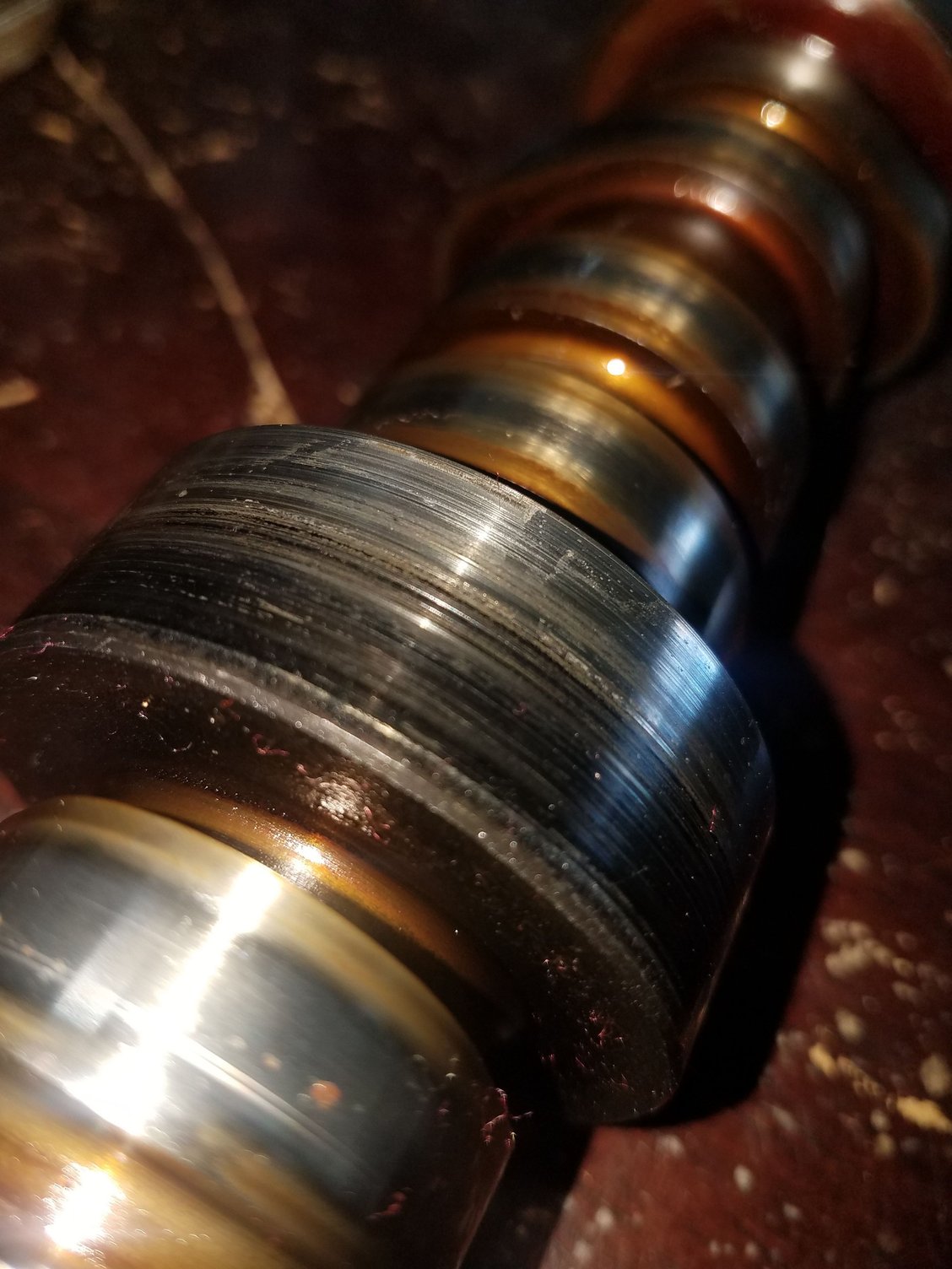

The cam bearing was already Bad. It already spun in the block which is why the cam journal was scoured on the cam as well as the bearing being thin and black.
The real question is, did it damage the block? The machine shop will have to measure and inspect it. Likely it will take a new set of bearings. but occasionally you can get one that damaged the block and will not clean up. These are not like a traditional small block where they can hone it it out either. If it's damaged to the point it won't hold a new bearing, the block is junk.
You can get a ball hone and another set of bearings and hone it out to the next size up bearing. Only works if it's not position 1 or 5 but those ones aren't the ones that usually spin anyway.
