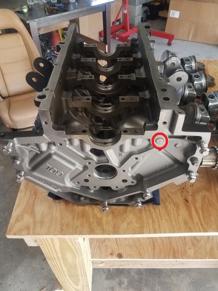

I realize pictures can be deceiving. I hope you pulled the old barbell out and cleaned all the oil passages prior to assembly. I also hope you installed a new one as well as the plug in the front.
Thank you for the help!
I actually have not done either of those things myself. This is the first I've heard of it. I'm hoping the machine shop did since he hot tanked everything for me. I will have to check that out tomorrow.

They usually miss that barbell and installing a new plug in the front is the end user/ assemblers responsibility.
Same with cleaning the oil gallery passages. It's the responsibility of the end user/ assembler.
I have that book and it's been a long time since I read it. I am not sure if they cover that topic.

I also may have missed it I didn't go over the machining chapter as much as I did assembly.
What is the recommended cleaning process for the oil galleys?
A set of brushes, warm soapy water, and some compressed air. I usually follow up with WD40 Immediately after or the block with flash rust.
https://www.lsenginediy.com/ls-engin...aration-guide/
