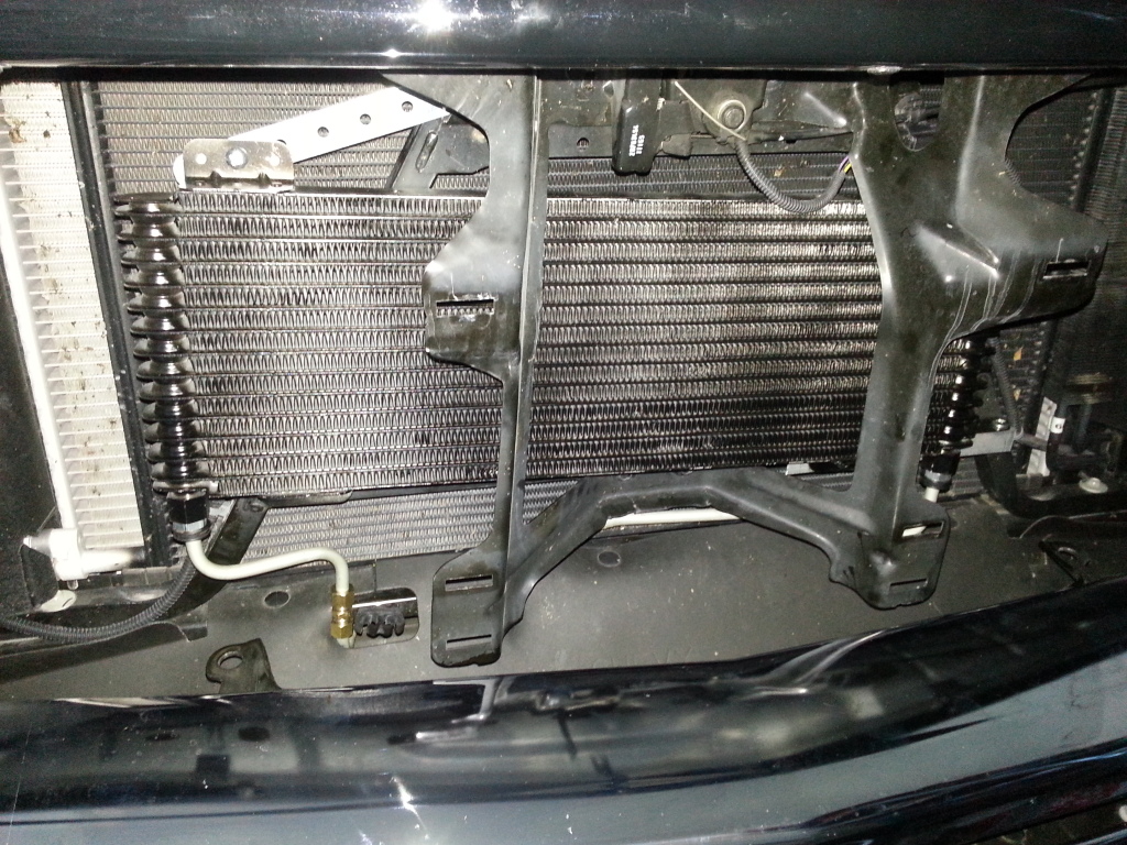

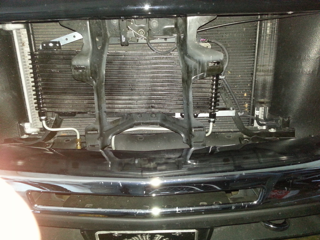

I got mine on, pretty much the same as the nbs trucks, 3/8" compression fitting and the Dorman 800-605 I think it is. I couldn't get it centered and I had to relocate the ambient air sensor, otherwise just pick your favorite mounting bracket and location, fairly straight forward. I used 1/4" aluminum angle on bottom right and one of the supplied straps on top left. Can't figure out posting pics from my phone, I'll get a couple up soon.
