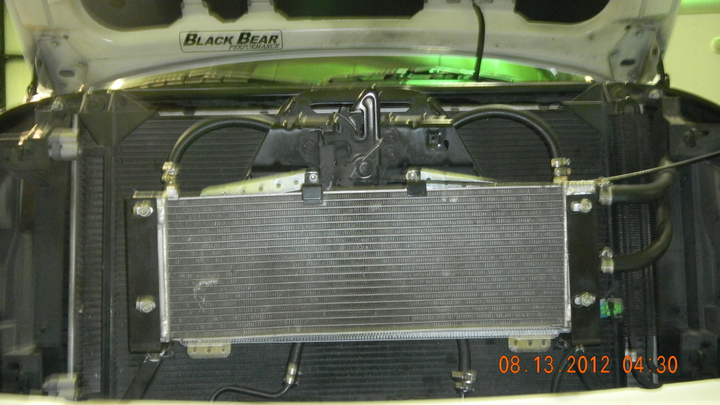

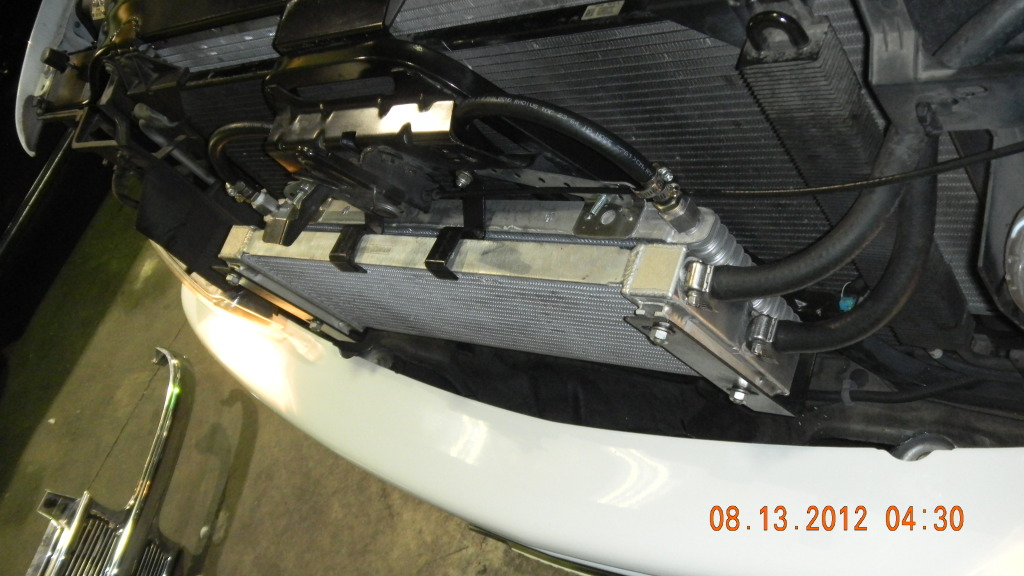

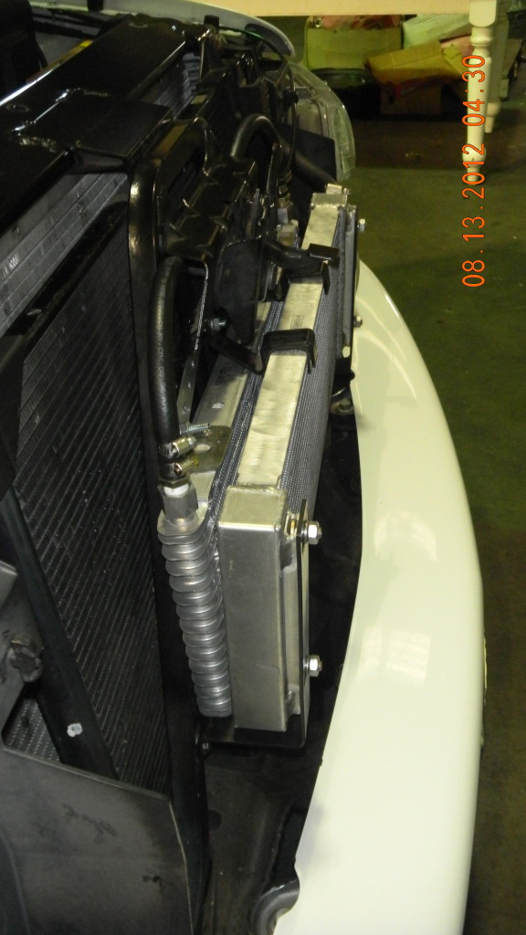

Hey guys i just installed my tru-cool Transmission cooler, i had a rough time mocking it up due to my Radix Intercooler, i think the out come came out pretty good, What do you guys think ?

Looks badass trav1eso!!
