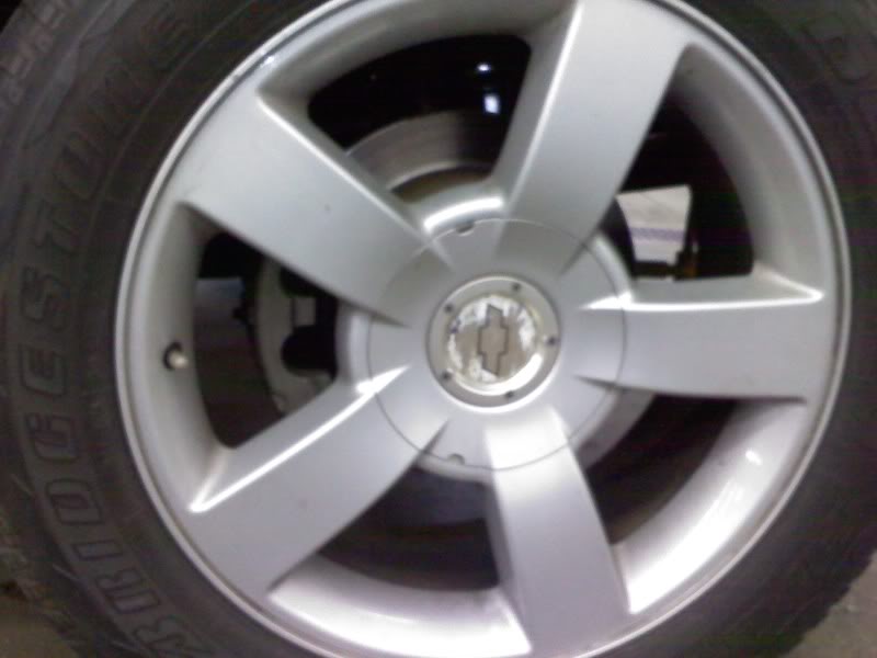

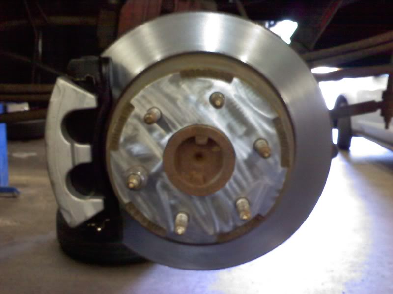

work was a little slow yesterday and I did a rear brake job on a Suburban. The customer wanted new rotors but tere wasn't anything wrong with their old ones. so I machined the rotors, called NAPA and got some loaded calipers for a suburban, and slapped it all on my truck.
I needed rear brakes anyways, because my rear rotors were delaminating like crazy.
here's before:
and after
brakes feel much better now, i'm guessing its mostly due to the old one pulsating like crazy and not having much pad to rotor contact because of the condition of the rotors. but why put stock stuff back on when you can upgrade?

yup, everything else is the same. I didnt even have to cut the backing plates. you just need:
rotors, calipers, caliper brackets and pads.
I bought loaded calipers and they came with everything.

Trevor, 00-06 SUV. and yes Quik, the SS Silverados are the same setup.
dual pistons with bigger pads, and the rotors are twice as thick.
rel3rd, the rotors were from an 05 Suburban Z71, but they are the same for Tahoes, Escalades, Silverado SS Etc.
and yes, the brackets use the same mounting holes and the hoses fit without and issue. e-brake stuff is all the same as well. you can trim the backing plates a little, but mine fit behind the caliper bracket without interfering with the movement of the pads, so i left it.
I believe the 05+ brakes are the same type of bolt on upgrade, but i haven't measured the bracket mounts yet to verify the spacing is the same. I think more than a few people on here have done it on here. i'm sure theres a thread
