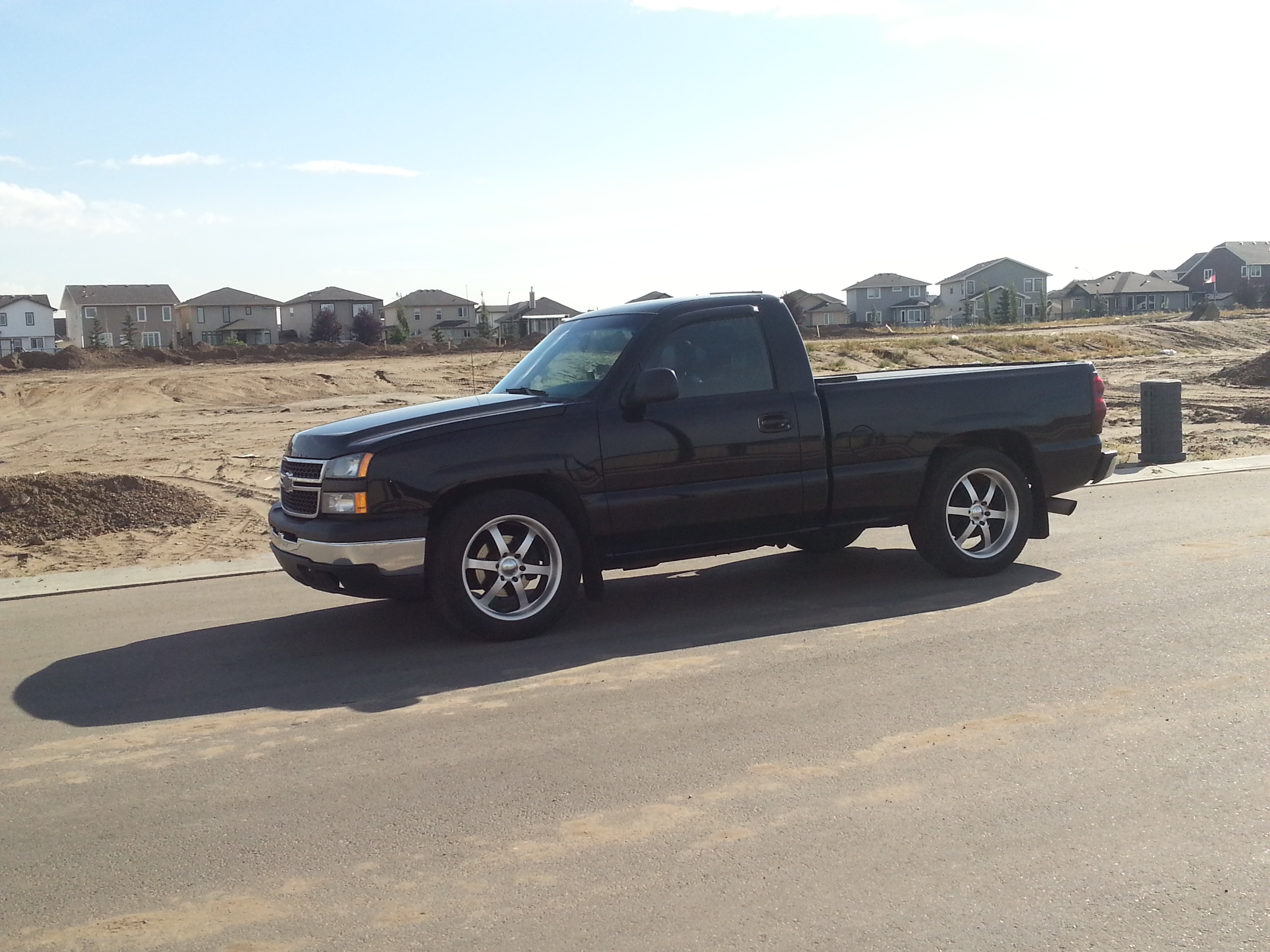

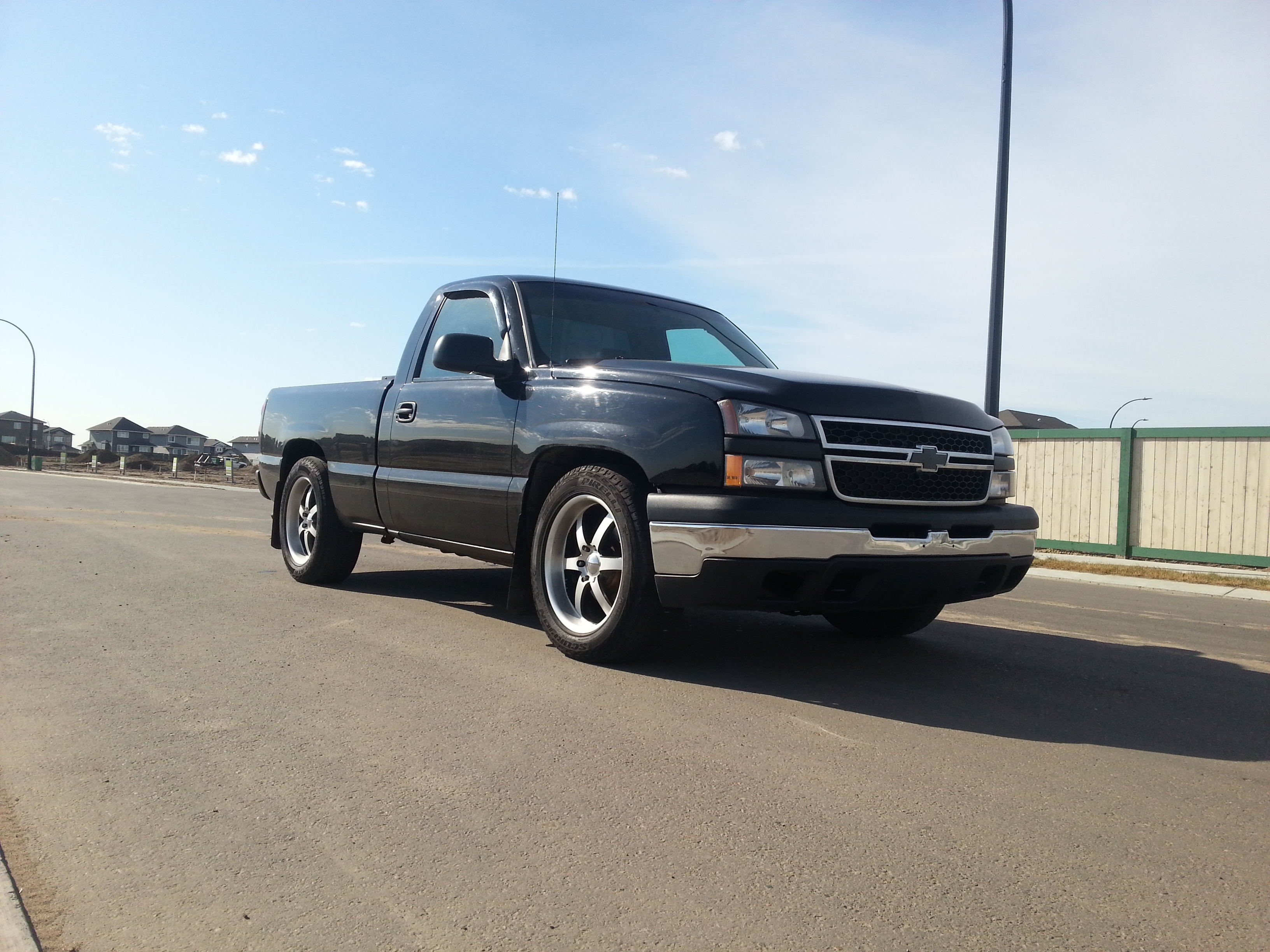

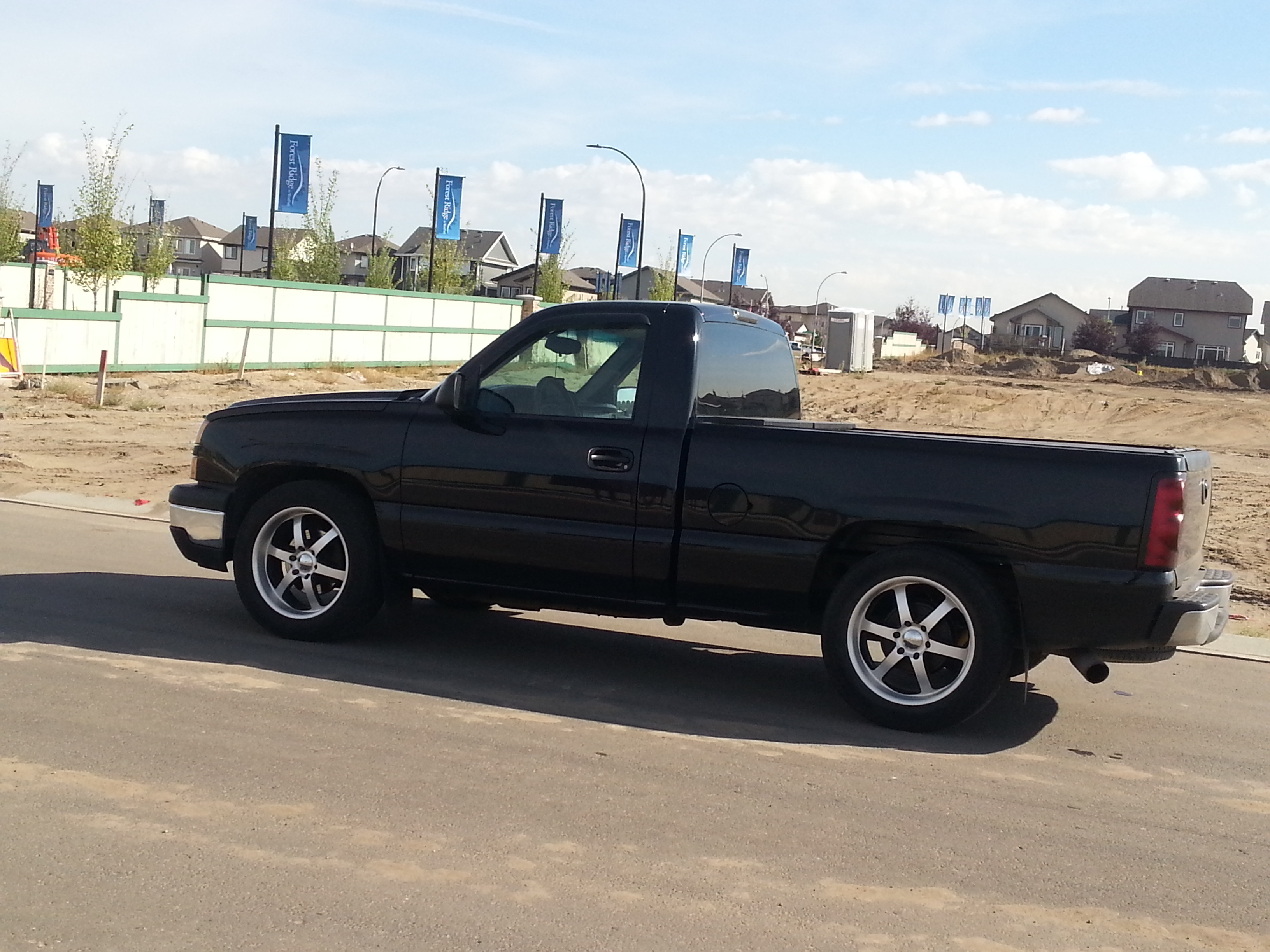

Here's my 06 RCSB 4x4 I picked up for a work commuter, just installed lowering keys up front and the rear has the blocks removed and drop shackles.
The drop shackles were already installed so I didn't have a true starting point, but I'm guessing it's around a 2/4 drop. Current fender measurements from hub to fender are 18.5" up front and just over 20" in the rear. I like how low the front is, but I would of liked to have it sit more level. I'm thinking about turning up the keys to raise the front end a bit.

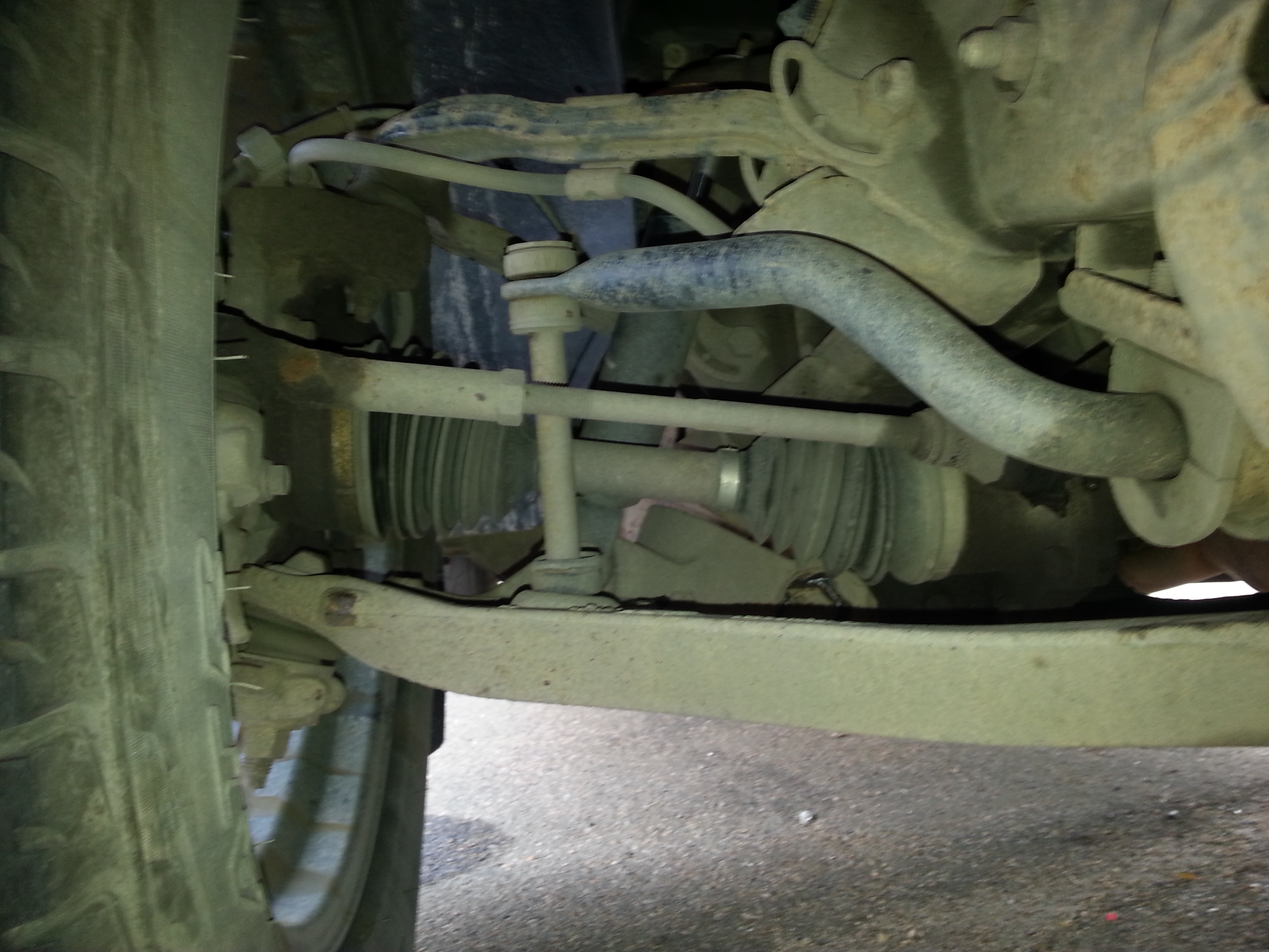

Here's my CV axles:
Don't really want to invest in a flip kit/c-notch or do hangers at the moment so the back is kind of stuck at that height. Only other option is to clamp the overloads on the rear springs... I've "heard" that if you do it at the front it will give you about an extra 0.75" of drop and not change the ride drastically. That would leave me with around 1" of rake if I leave the front end alone. A little rake probably won't hurt as I'll be adding a couple sandbags to the box for extra traction in the winter months.
