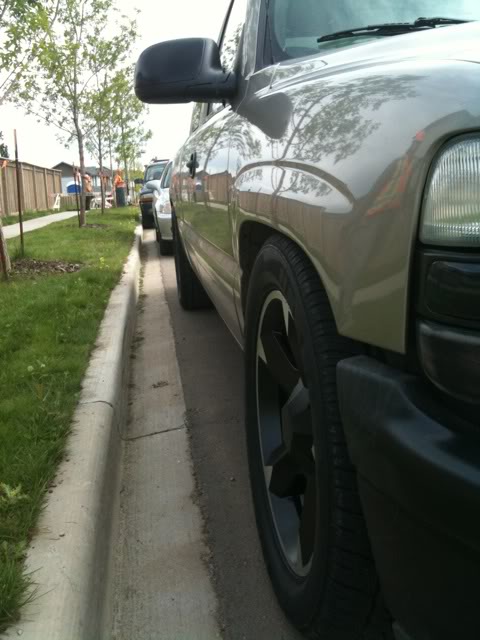

Frostflowz's Avatar
Joined: Dec 2011
Posts: 37
No actually it's very firm. What happened was I mounted them to high on the frame because my goal was to tuck my front a little along with the back. They sit @ about 40 psi when I'm tucking in the back. HOWEVER, plans changed after and I went for a wider offset of summer rims. So to tuck in the front I'm gonna require some fender rolling and flareage.
As seen here;
So that's why I run them very high psi.. so the back isn't lower then the front at the moment, can't stand that!

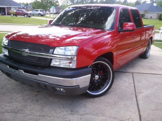

Here is mine...looks hi cuz I bent down to take the pics but sits nice on the 22s. I also had to get a custom driveshaft made!
Front:
MOOG offset bushings to help alignment (good advice from mr shredsled...thanks man)
Belltech 2" spindles
Adjusted lowering keys
Rear:
Blocks removed
Belltech 4 inch drop leafs
Stock shackles
With tow bags going in this week!

Old May 13, 2012 | 07:02 PM
  #37
Joined: Nov 2004
Posts: 1,051
From: ODESSA, TX
Originally Posted by ShredSled
And a quick picture of how it sits more recently...
How does your launch feel in 4wd?
I didnt realize you could go so low with 4wd, your truck looks dam sharp!

Old May 14, 2012 | 10:23 PM
  #39
ShredSled's Avatar
Joined: Aug 2009
Posts: 789
From: Michigan
hey thanks.
She launches nice and smooth in 4hi. Grip is insane on the street, LOT of people don't expect it to hook like that in a lowered pick up truck. Especially if they first see me just messing around in 2wd where it only lights'em up on hard launch and doesn't goanywhere, then I switch to 4hi and scoot!
CV angle actually improves upon launch at this height, esp vs lifted, or even stock, where many people seem to get chatter or hop.
