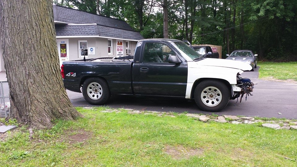

ShredSled first off killer truck! your and black04 were my inspiration for building mine. I had the McGaughys with djm upper and lower control arms and stock keys. I didnt like the minimal clearance between the cv axle and upper ball joint. these belltech spindles 2508 do they give more clearance there?
this is how it sat on that set up unfortunately I had to get rid of that truck but im in the process of recreating it but want to right parts first time!!
