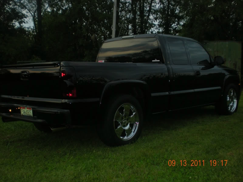

I'll start with the poor mans lowering method.
Front stock keys lowered all the way down, rear is belltech 2'' drop shackle with rear block removed.

Mild lowering job on my 2002 Z71. Handles a lot better. Ride is smoother than stock, and still can haul roughly a half ton without bottoming out...
Also on the lower end of the cash outlay scale...
SpringTech 2" lowering spindles
Stock keys
Rear block removed
2" BellTech shackles
KYB Monomax shocks
With 20's and 275/55's (as it sits right now):
http://www.fquick.com/images/vehicle...1203355966.jpg
and with stock later model 17's and 265/70's (winter setup as this is my only 4 wheeled vehicle):
http://www.fquick.com/images/vehicle...1203342735.jpg

rel3rd 10-22-2011 08:56 AM
Originally Posted by AKlowriderZ71 (Post 4797158)
You still happy with those KYB's? :angel:
Well, yes and no...lol.
They seem to be a bit more temperature sensitive than stockers. Sometimes they seem a little "floaty" since it's getting a little colder here in the Mid-Atlantic region, but overall...yes, it was a good move. Thanks again for the recommendation. :D
