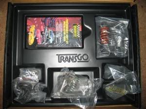

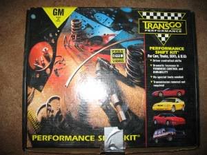

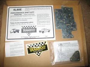

Hey guys.
I found a new in box 4L80E Transgo shift kit on my local Craigslist. It looks to be an older kit. It doesn't have a blue box like the HD2 kit has. Also, it comes with a VHS tape in the box.
Is this essentially the same kit as the HD2?
I'm looking to save money where ever I can, but if the HD2 kit is the way to go, I'll order that one.

This is what the ad says:
1 ~ TRANSGO 4l80e Transmission Performance Shift Kit. NEW IN BOX
Application:
Make: CHEVROLET
Transmission Type: 4l80e
Beginning Year: 1991-2001
Here are the pics from the ad:

I asked the seller if he know what the difference was between this kit and the hd2 kit. He didn't know.
Does anyone know what the difference between the kits is?

That is an old version of the kit that did not supply a separator plate and you had to modify a factory plate. The issue with that kit is installing the plugs. I have seen where they blow out or guys wreak the plate by bending it. The new kit comes with a plate but it has a downfall IMO. Its a stacked plate with three layers. The issue is when you go to drill the plate you have to be careful and drill slow to not create any burs between the layers. If you do you could cause cross leaks IMO. With either kit you can skip using their mods or plate design and just install the kit. Then there are a couple of mods you can do to the center support, direct drum and feed hole passage way in the separator plate to make a dual feed mod that kit features. I personally have been installing a modified TG kit in builds I have done and have been pretty successful. Like any shift kit there are things I add or leave out based on builder preference.
