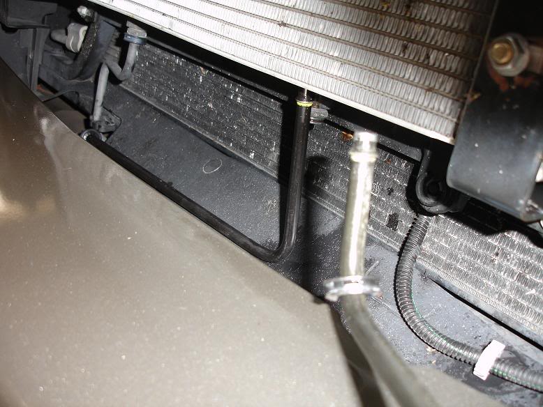

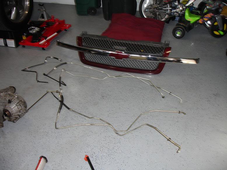

Installed the transmission lines. Not much to say.
Had to pull the front grille to get to the cooler. New lines on top, old on bottom. Get them unhooked from the radiator and cooler, small clips hold them under the engine. Unclip them there and remove a couple of clips that keep them tied together. Fish them out toward the front of the truck. Messy and and a puzzle.

It's not a direct fit so far. Guess where the 2500 sits higher on the frame. Anybody know of a tool to make these type fittings. I'd like to cut some length off the new line and re flare it.
New line in background. Old line in the foreground.

I have always took a tubing flare and flare the tubing then put 2 clamps on the trans fluid line but mine goes to soft line.

You could probably use a hydraulic 'olive' type joining fitting. We use them at work for air, fluids etc. That's what I'd use.

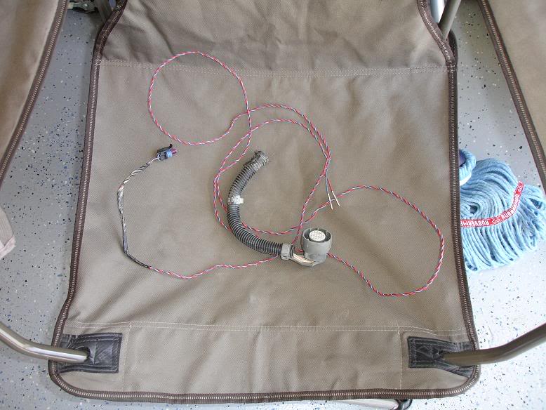

Just a note on your speed sensor....apparently the OEM speed sensor wires are a 'twisted pair' for reasons of warding off/blocking interference from other electrical signals within the rest of the wiring loom.
I don't know how important/true that is....but apparently the speed sensors are quite sensitive to interference.
Also....it doesn't matter which wire goes to which of the two pins at the PCM.
EDIT: easy way to make them a twisted pair....tie one end of each wire to something and put the two 'other' ends in the battery drill....pull the trigger. Voila...twisted pair.
I may wind up going soft line right at the trans cooler. Good idea to flare it with clamps.
I pulled the wires for the speed sensor straight from an old harness that had an 80e in it. Wondered why they were twisted. Good to know it doesn't matter about the polarity.. if it can be screwed up I can do it.
