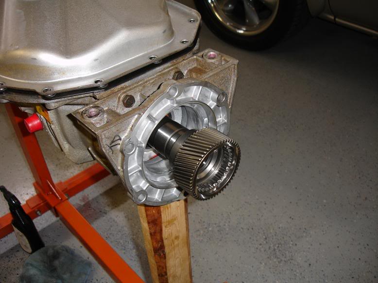

Originally Posted by KySilverado
Installed the transfer case input shaft today..... yeah I wish it was so easy. Cost 113.59 shipped. Seems all transmission and drive line companies are on the west coast.
Attachment 140085
Came with this extra bearing. Guess I'll figure out where it goes when I tear down the transfer case.
Edit: Found it. Input Gear pilot bearing.
Attachment 140086
