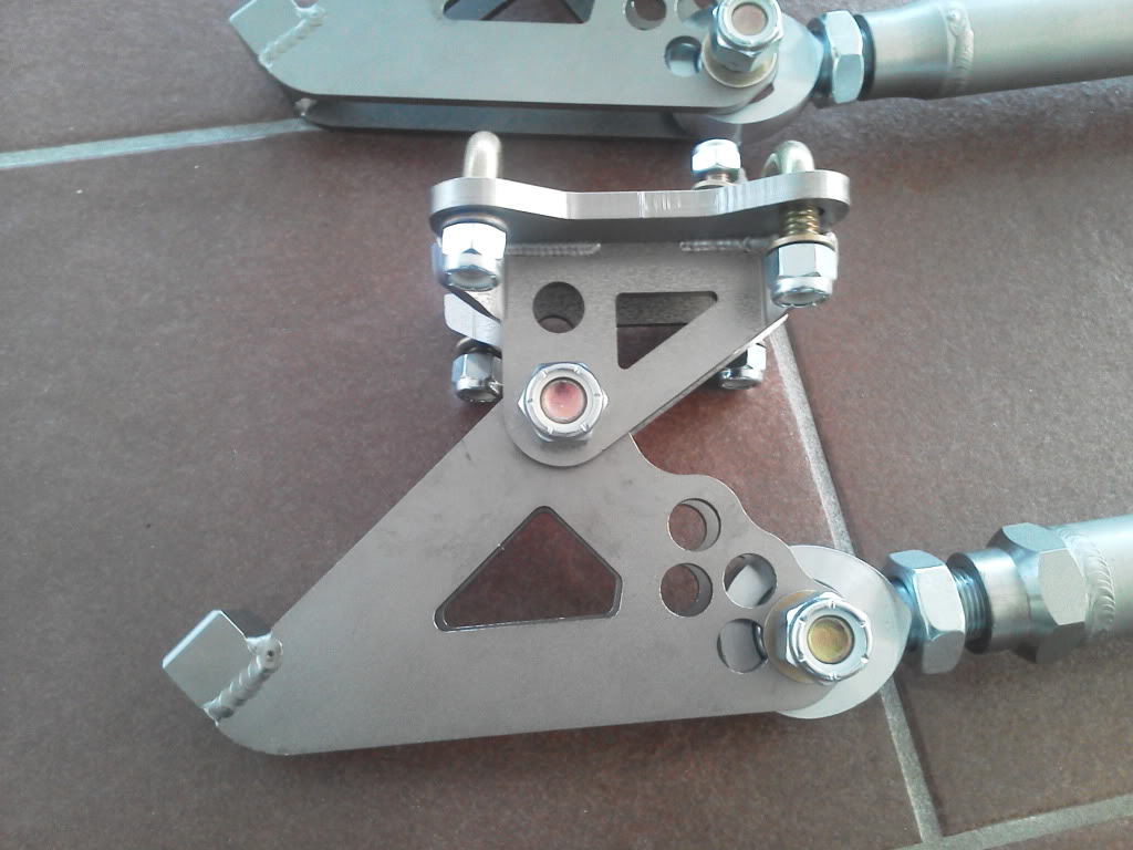

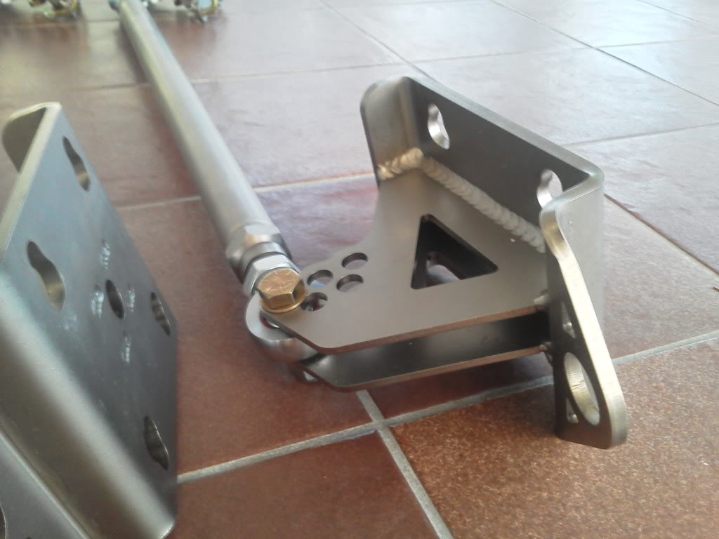

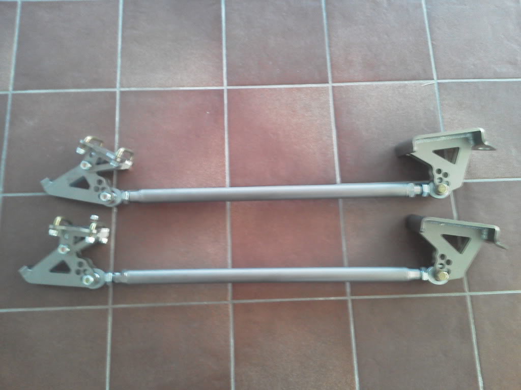

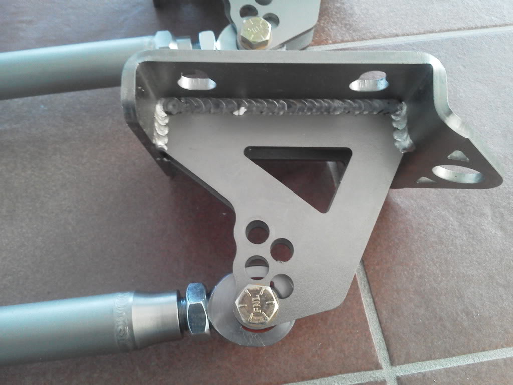

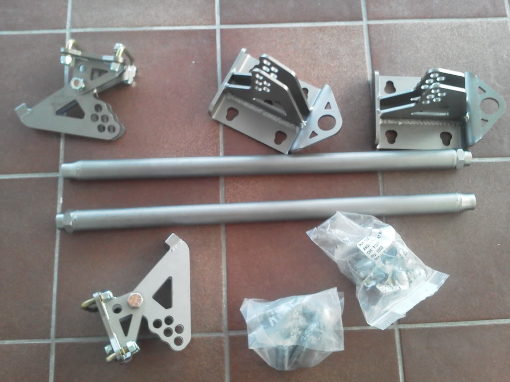

Have pics up in my build thread but since I was searching in here for advice on bars, figured i'd post up. Always like to give new things a try so I called up Smith Racecraft and got the last set of bars in stock, got them in a week.
These things look fantastic and are very well made. I saw chevrolade's install on an 08 with a flip kit and hoped I wasnt going to run into similar issues but unfortunately its same on the NBS.
- Second leaf in the pack is too long, has to be cut back so that the front mounting bracket of the bar sits flat on the leaf. I ended up reclamping mine after cutting.
- I knew the overload leaf was going to get in the way so it was either pull it or hack it. I went with the latter as opposed to trying to get the center bolt out of the leaf pack.
- The ubolt spacing on the axle mount is off so these holes have to be opened up a bit.
-The opening for the leaf pack center pin is a good inch or so off from center. I just redrilled it using the old flip kit plate as a template.

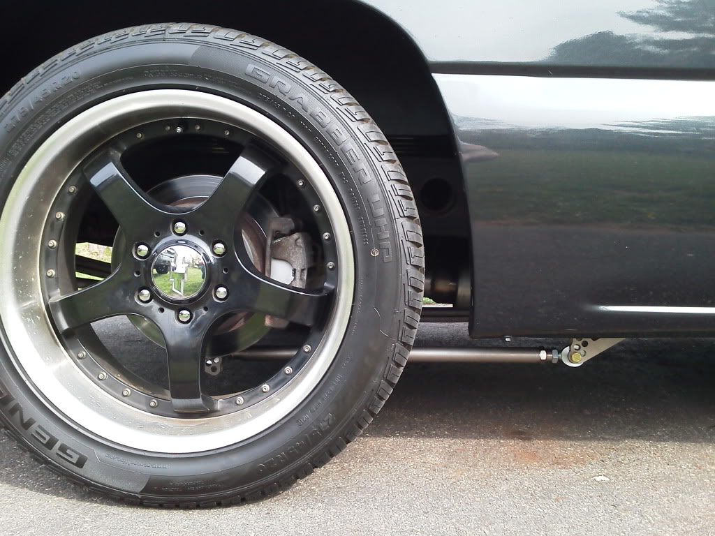

Installed

I opted to use the upper mounting hole for the front bracket for better clearance on the crappy NJ roads.

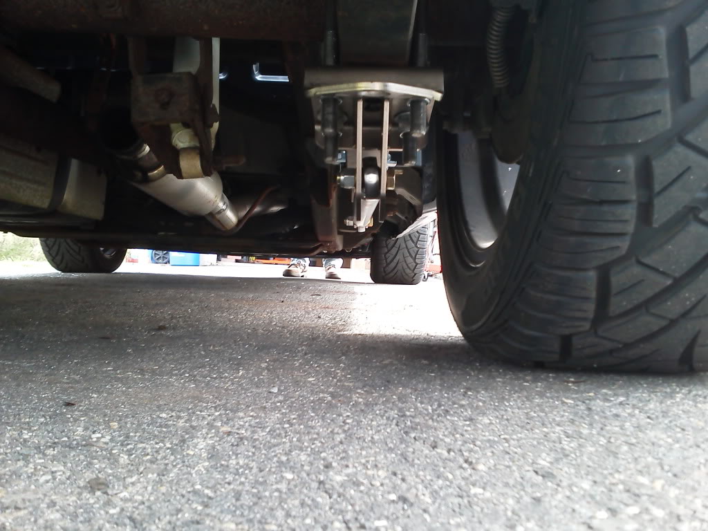

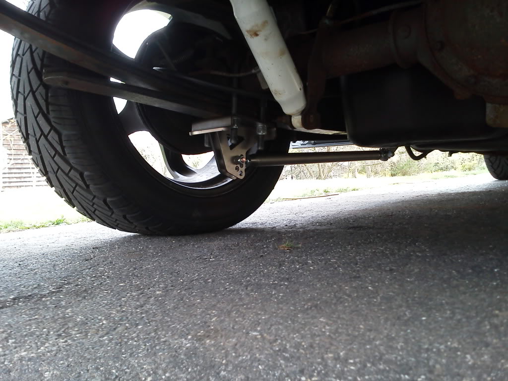

Ground clearance with the flip kit
I cant say anything for caltracs as I have never used them but these bars work great. I set them up level, put a quarter turn load on them and hit the street, reduced the tire roasting quite a bit and completely eliminated any wheel hop I had. Despite the mods needed to get these to work I would do it again in a heartbeat.
