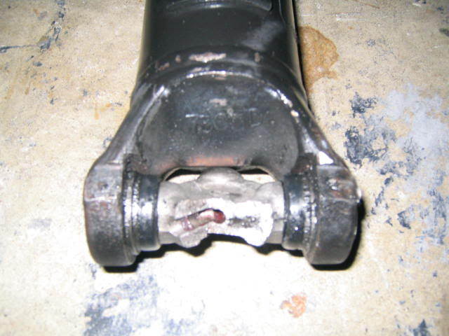

I was looking at Randy's Ring & Pinion website and noted that there were many different u-joints available. It got me to wondering if the rear u-joint for my 10-bolt is compatible with the 14-bolt or if I need a hybrid/adapter u-joint? Either way I plan to install a new one but just wonder which one to buy?
EDIT: Found my answer in a GMB product catalog HERE...it shows two different part numbers for the Yukon and Avalanche 6.0L (2500 series):
Yukon
Std: 210-3105
Perf: 215-3105
Avalanche
Std: 210-0178
Perf: 215-0178
Guess I'll either need to have my driveshaft modified or get an adaptor u-joint.

I have a hybrid joint on mine that converts the yolk of the rear (1350) to the driveshaft which I think is a 1320.
I believe it is best to remove the driveshaft and have a 1350 yolk welded to the driveshaft and have it high speed balanced.

Also, be sure to get a sealed solid u-joint. Do not get a greasable u-joint because they are hollow in the inside.
