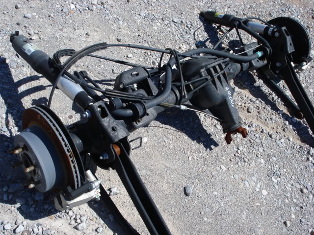

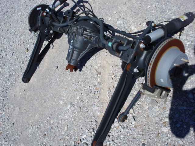

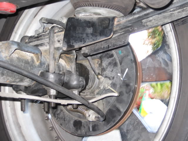

Here's pics of the 14-bolt Escalade rear sent to me by the salvage yard...he says it is coming as shown "minus the shocks". That is fine as I don't have the self-leveling and don't need them. I'll take some better shots after it arrives...

Whoa, get a picture of that cover. That doesn't look like the 14 bolt from that picture.
Yikes, it is hard to tell. I am leaning more towards it being the 10 bolt due to the "squareness' of the differential housing rather than 14 bolt 9.5" being very much an oval. Also, those rotors are 13" diameter, so in perspective to the differential housing/ring gear inside, it does look smaller in size, unfortunately. I'd get confirmation for sure, like Zippy mentioned a picture of the differential cover is all you'd need.
On second look, those axle tubes are mighty small in diameter also.
Ahh, now why ya have to go & say that? I hope it is...but I sent an email asking for a pic of the cover!
EDIT:

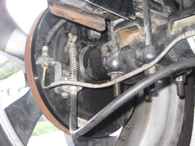

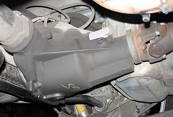

Okay, I went out and took pics of the Yukon's 10-bolt and manipulated the pic of the 14-bolt...appears to have some subtle differences in the housing, i.e., cast-in cross-bracing & rib structure for one.
10-BOLT:

14-BOLT:

Old Sep 16, 2008 | 10:23 PM
zippy's Avatar
Joined: Sep 2003
Posts: 4,534
From: Las Vegas, NV
The bottom of the diff should be smooth. I think the 8.6" has the bracing cast into it. It looks like someone got the rear diff and vin mixed up.
Old Sep 16, 2008 | 10:53 PM
InchUp's Avatar
Joined: Feb 2008
Posts: 939
Damn...this is getting worse. Zippy's second cell phone pic aint helping either for the reassurance part of this.
Old Sep 16, 2008 | 10:59 PM
GoatChs's Avatar
Joined: Jan 2004
Posts: 520
Likes: 8
From: Far East Bay - Norcal

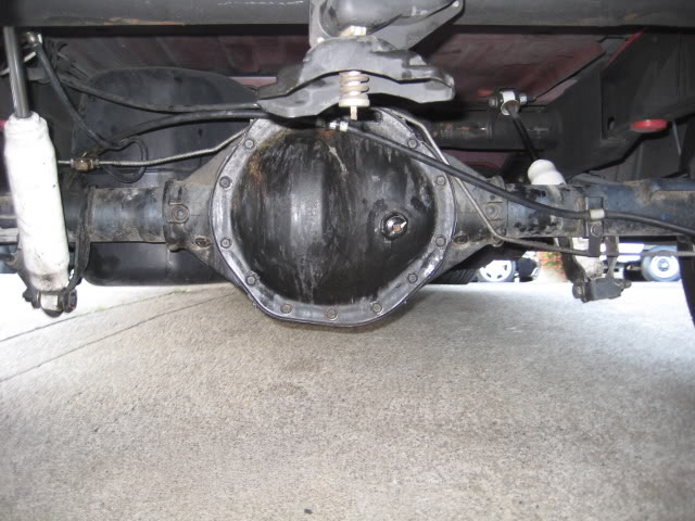

Just catching up after editing my post...the "smooth" diff is the 10-bolt currently in my Yukon. So, now where are we?
I'll feel alot better with a pic of a 14-bolt cover from the salvage yard!

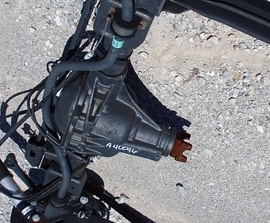

Here is my 14 bolt rear for reference:
