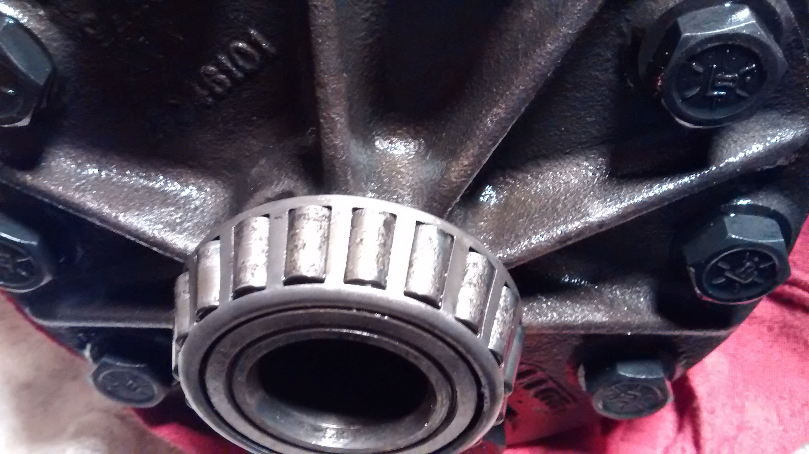

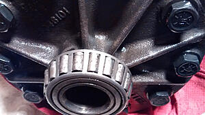

Did it look a little like this? (from my front diff)
