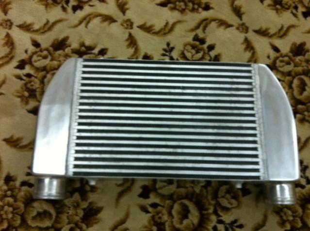

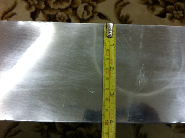

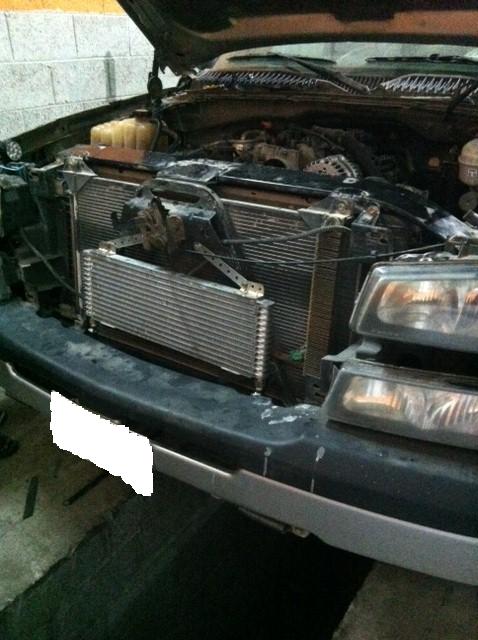

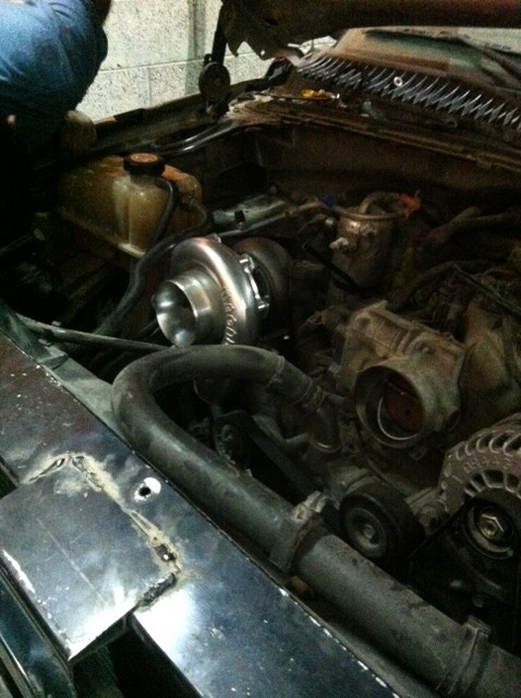

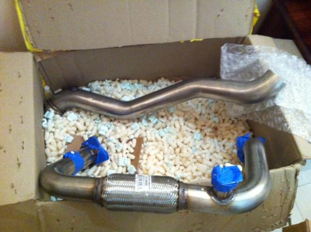

1st I have to give credit to Rick( TrickPerf) for delivering quality kit. I ordered stage 4 kit in August 2012 and it was deliverd on time in September 2012 in top quality packaging. He made me a custom FMIC behind the grill because my truck is 4x4 and I did not want low mount IC under the bumper. I ordered 4" IC because Chevy Silverado Truck has good amount of space behind the grill compared to GM Trucks.
I waited long for the install due to some circumstances not related to the kit.

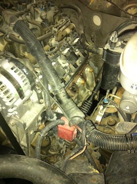

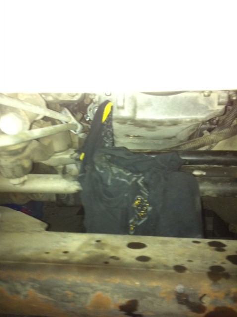

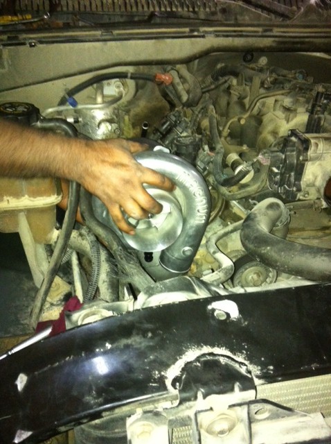

Started the install this week. Oil pan was removed while engine still in the truck. Lifted the front on jack stands and has to losen engine mounts and lift the engine little to remove the oil pan. Shop didn't want to take chances with drilling oil pan in the truck and getting mills in the turbo and oil system.

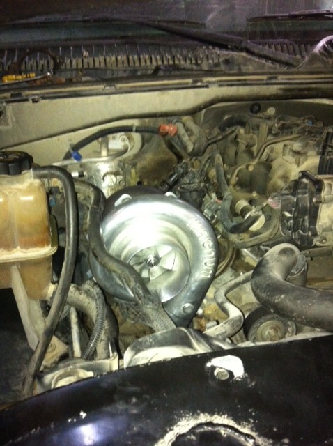

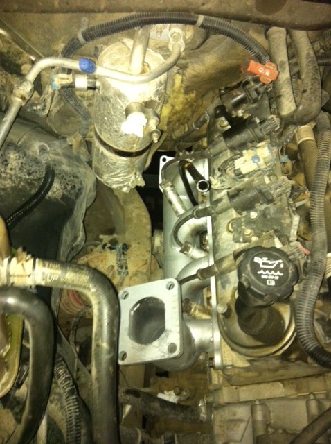

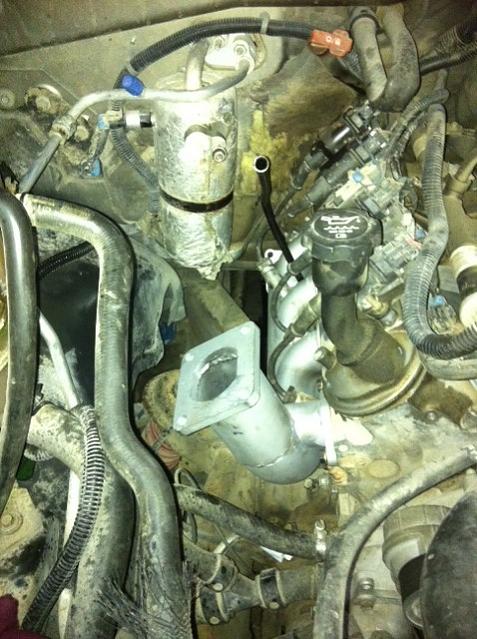

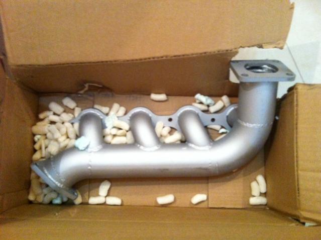

Removed the headers and mounted the stock driver side manifold and pass side turbo manifold.

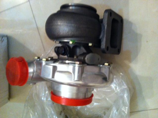

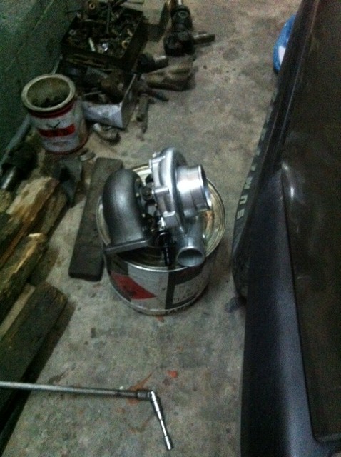

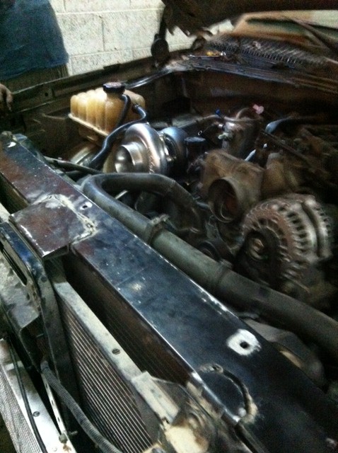

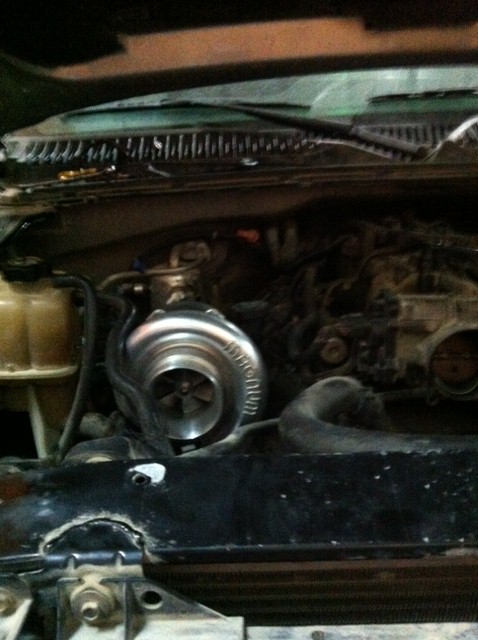

Clocked the turbo and installed it on the turbo manifold.
Mounted tru-cool 40K oil cooler.
Stay tuned for more update.

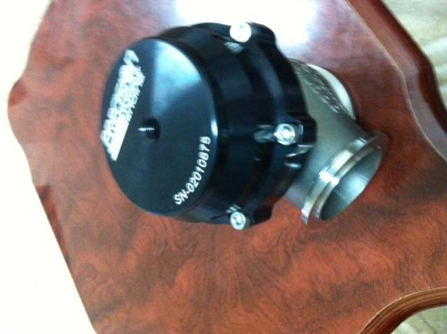

Attached Thumbnails TrickPer Turbo Kit Install...Here I come-image1.jpg   TrickPer Turbo Kit Install...Here I come-image2.jpg   TrickPer Turbo Kit Install...Here I come-image3.jpg   TrickPer Turbo Kit Install...Here I come-image4.jpg   TrickPer Turbo Kit Install...Here I come-image5.jpg
