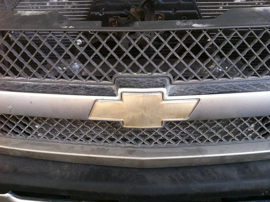

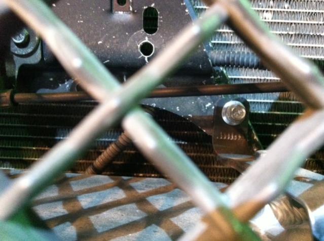

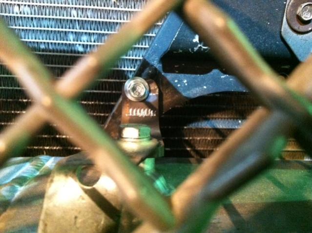

See pic.

Here is another pic.

Grills in the way.
Angle is good.

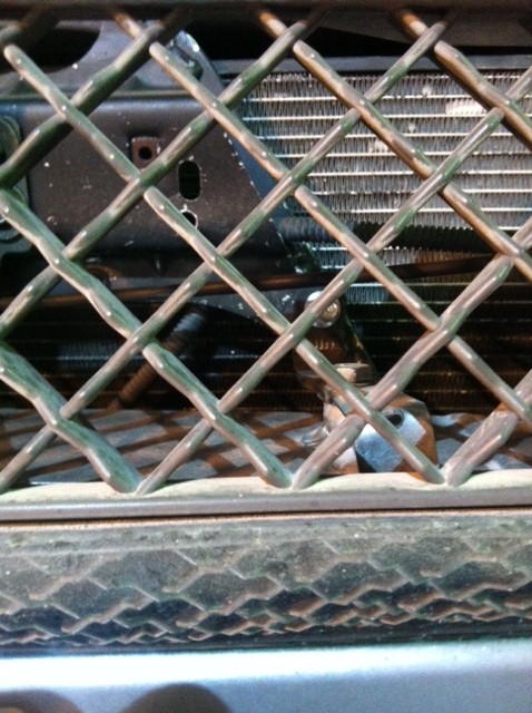

I can zoom in and get you two seperate pics, one for each support.
I still have the stock aluminum supports that came with the IC.
As said I think I can later raise the IC up an inch more or slightly less than an inch in future.
The cold pipe on the passenger side is around the beam with no space left. However, the driver side cold pipe have a little gap from the beam that can be eleminated by rasing the IC up.
Also, I have one comment about the BOV position. I think it is low for trucks specially 4X4. It would be good to change it in future kits to near TB on the cold pipe to be on the top.

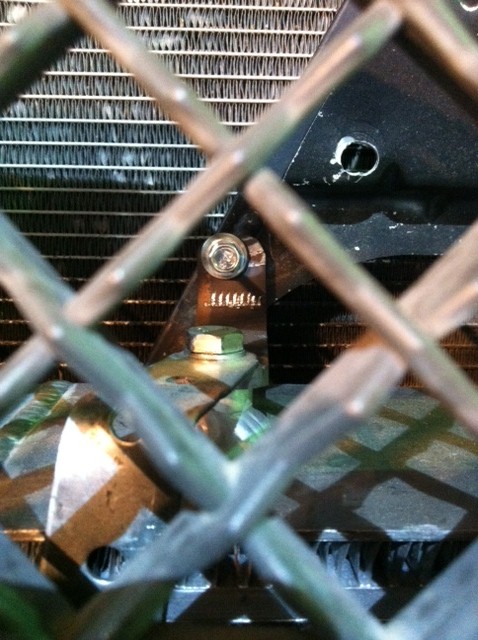

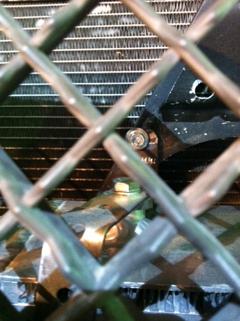

Here are close up pics of the IC mounting plates.

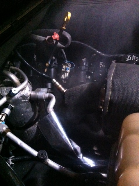

Another zoom.
And I pic for the AC line after cutting and re-welding.

Cut and weld.
Why did you cut that line.
It just needed to be pulled over for clearance?

My condenser bottle was replaced long time ago because of a leak and new replacement had the AC line aluminum connection exit vertical, so, it's different than stock. It cannot be twisted that easy to make it clear without breaking the line.

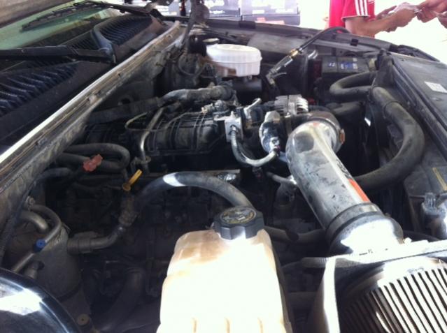

See pic of stock line before cutting and re-welding.

My ac line blew up because I didn't bend it enough.
380 bucks later I have a new one and freeon
