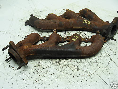

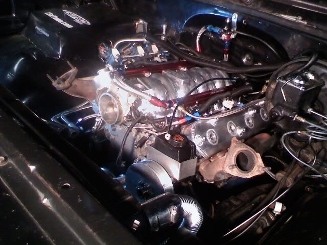

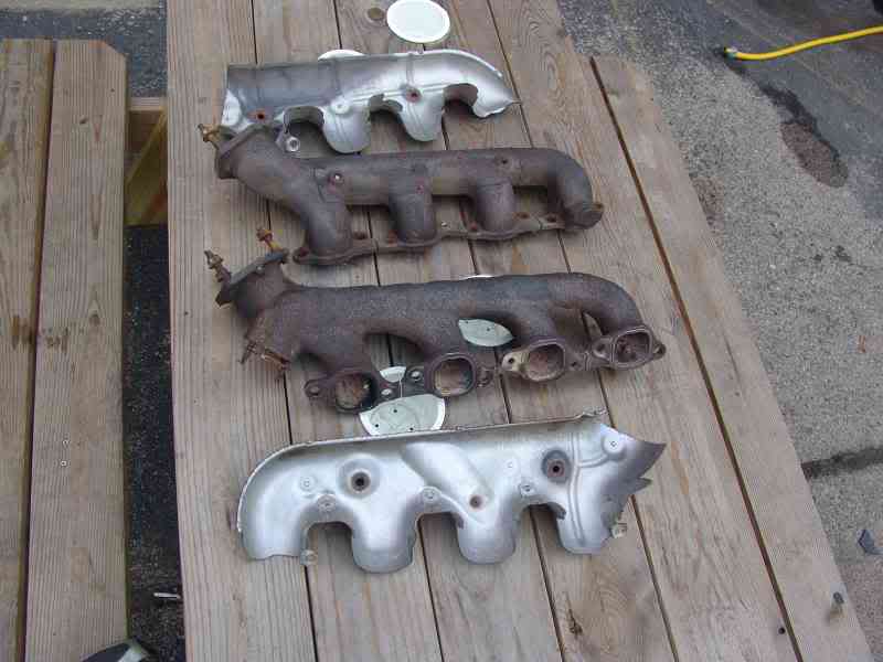

Old Sep 14, 2009 | 04:57 PM
Ender06's Avatar
Joined: Oct 2008
Posts: 771
From: Independence, VA
So the 'ends' of the manifolds look similar. I wander if they're the same.
These two pics are of LS manifolds
Here are a couple pics of the 8.1L manifolds. What do you guys think?
Old Sep 14, 2009 | 05:18 PM
Mangled03gmc's Avatar
Baltimore Whore
iTrader: (95)
Joined: Apr 2004
Posts: 16,820
I think that if you said you are tired of the lil problems that the sts is giving you, that trying to do a front mount set up is going to be a bigger pain in the ***, then fixing the problems with the sts...
