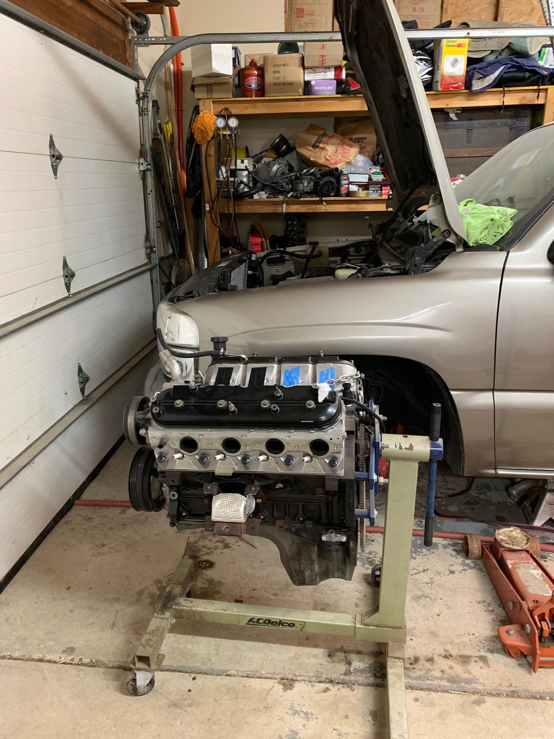

Finally got all my stuff together, new oil pressure sensor, knock sensors in, pinned crank... etc forward progress... sucks setting in by yourself and doing it from the side

Old Apr 5, 2019 | 12:43 PM
  #74
terravast4's Avatar
iTrader: (25)
Joined: Jul 2007
Posts: 3,187
Likes: 344
From: Austin, TX
like a glove. Good job!!

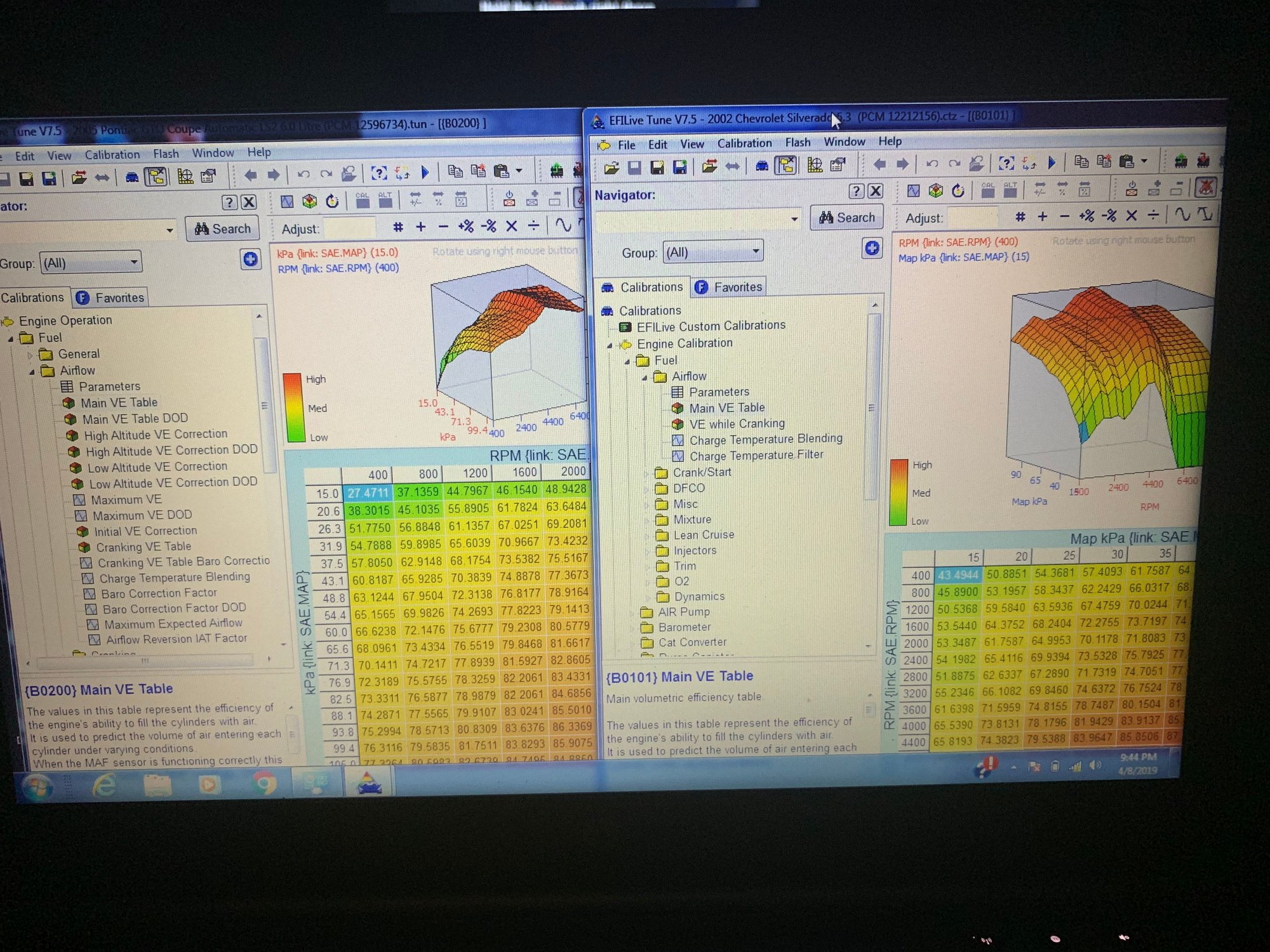

Holy cow I pulled the file on the spare pcm I had from a 99 truck. The VE Table looks horrible are all 99-00 ve tables this bad?
I was looking for a good file to cross reference like the ls2 but it has different table layouts- anyone have advice? Or a efilive file for a gen 3 ls2 setup?
99 5.3
02 5.3 vs ls2 ve table
