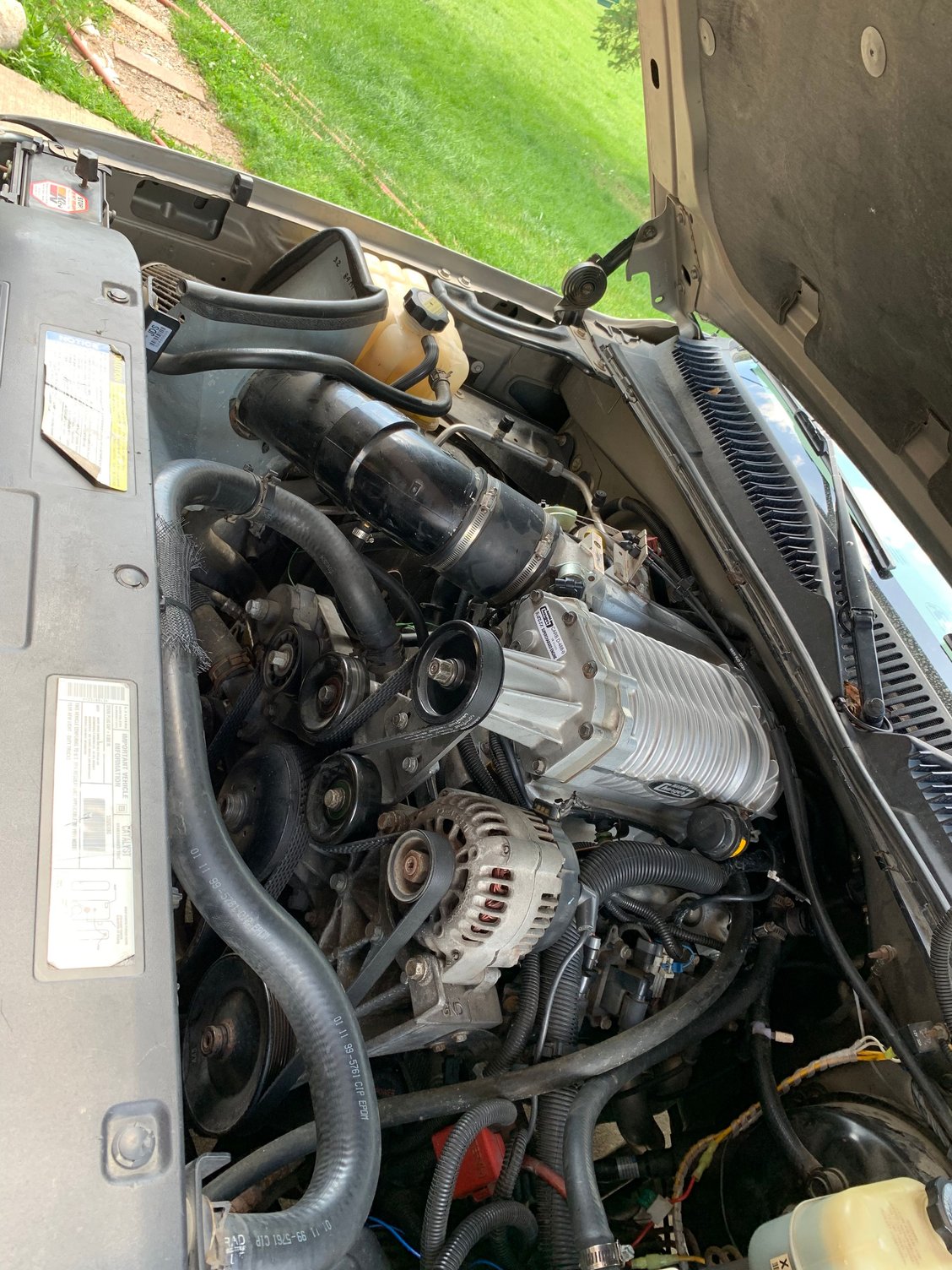

Well I had the day off this past Friday.... had many things to do.... but decided to do something a little less productive
less productive as in threw this 75lb aluminum thing back on the truck that was running very good for N/A .... back to retuning it.... Deka 60lb injectors are being a big pain in my *** to get this thing running right.

Lol hoping this 122hh will do the trick for now... low boost, hoping for lower IAT temps compared to before with the 5.3 seeing 190+
Is that measured via post rotor? That’s a crazy high temp.
I never saw anything remotely close to that at 14psi with the Whipple 2300.

That’s after rotor- these old radix get super hot when you pulley it down 3-lobe 70 degree twist vs the newer 4-lobe 160 degree twist
Sounds like you need to become a meth head. Lol
Is there a spacer for the 112 or would you have to spray pre?

Read up on that too- almost did meth, however some say it wears the rotor coating off and makes blower less efficient
soo I stopped there...

I think that is if you run straight meth

I ran it for years with zero issues.
