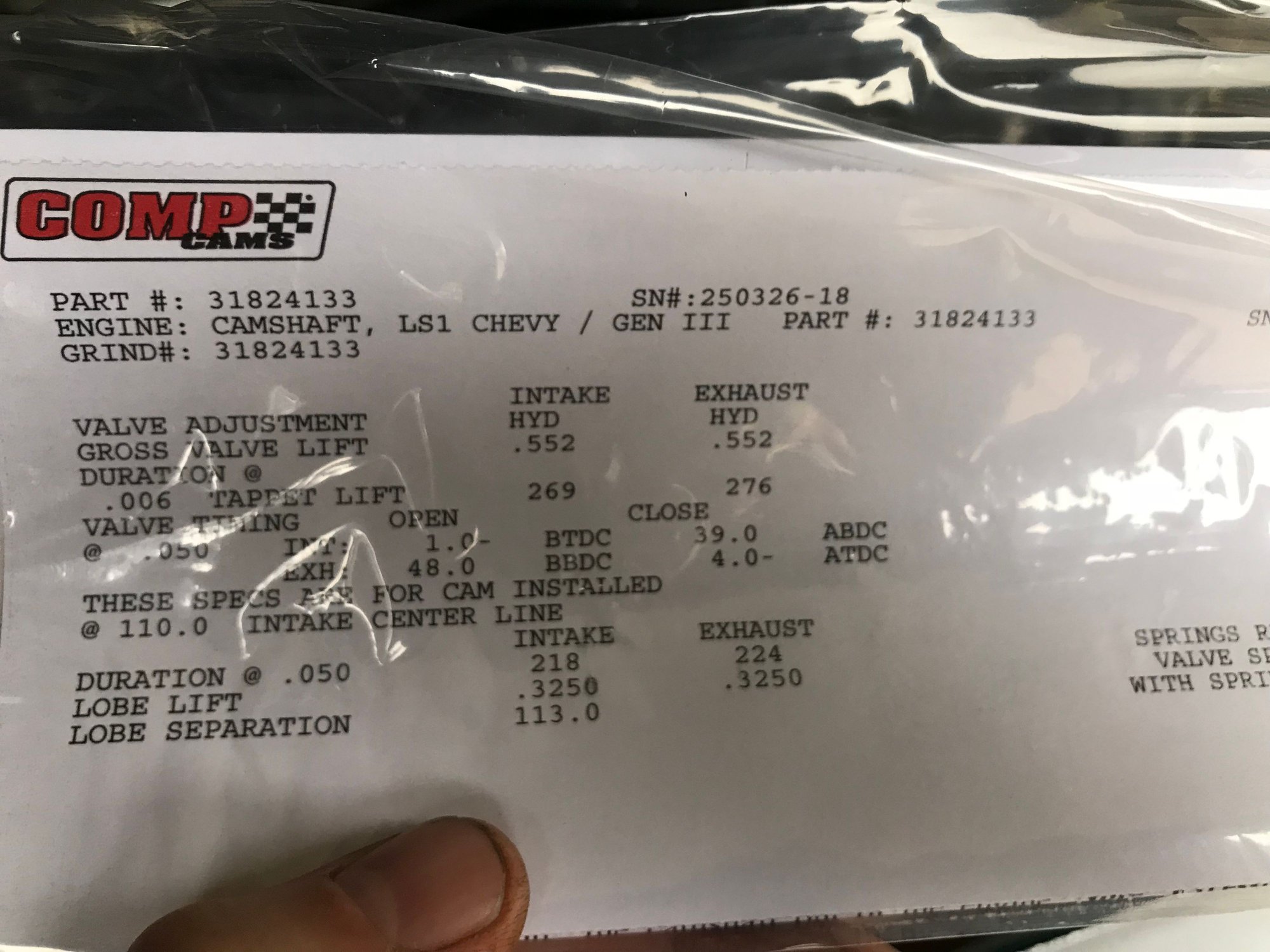

Was there a cam card in the box?

Originally Posted by terravast4
is it a stock lq9? why not a bigger cam? It is good to see you are getting back at it
i thought about going bigger for a while, but I was going into the 230 range and don’t want it to be a turd- so I started thinking logically heavy truck, go for more torque - was back and forth on blower or not- kid starting school this coming year- concrete I want in my barn - figure put the blower up for sale in feb, March

You tell BTR you were ditching to blower?
they didnt know I had one
I could be wrong but I think the 113+3 is the boosted application.

With the +3 in cam I’m moving my power band lower, for boosted apps I’m not sure, this was supposed to be there off the shelf n/a truck cam
with being 11:1 comp the +3 I may have some pretty high cylinder pressure

Call BTR on Monday and see if they can look into it. It's possible a mistake was made when the order went in to Comp. Wouldn't be the first time Comp screwed up...
so the sales rep for BTR says ....”The +3 will not be on the cam card if i looks at the intake center line it will be a 110 which is how i will get the +3.”

Yea thats 3* advanced.
Man for an iron LS2 with that compression I would have gone a little bigger... but this thing is gonna be one snappy bitch!

That’s what I was hoping for!! I seriously stewed on the cam for these past few months vs a tsp 228 or the stage 4 BTR - or staying boosted
Just need to get different headgaskets now, I had ls9 laying around but don’t want to really run them being a 4.100” bore and just being N/A
