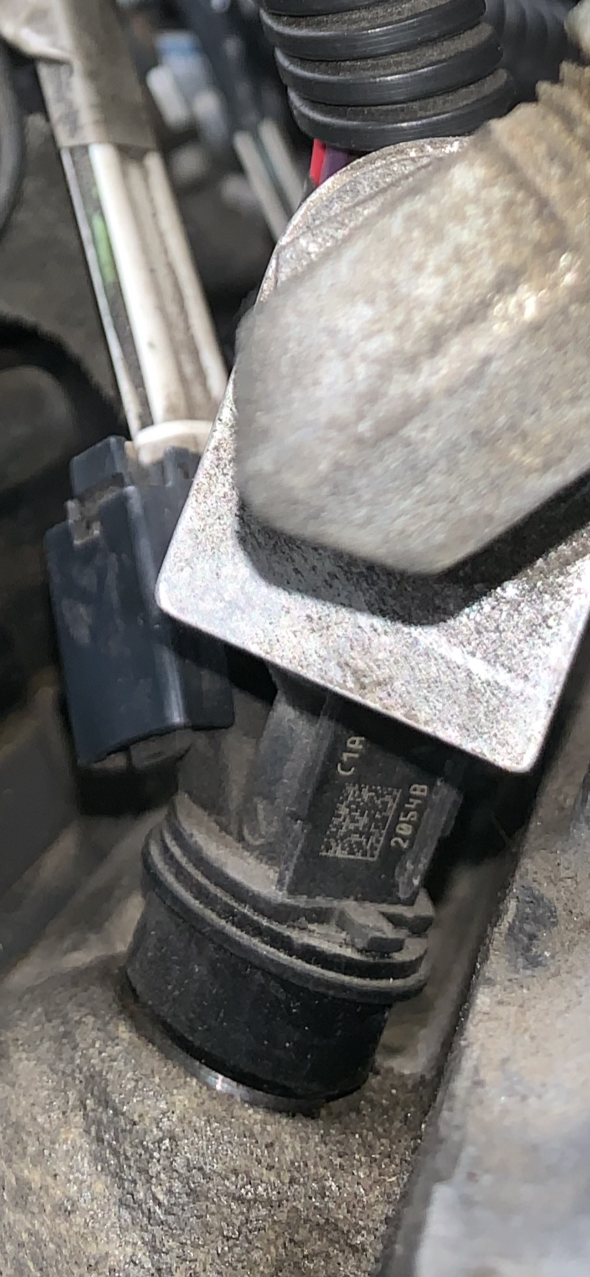

I got the PN off these injectors and am having no luck finding out which ones they are...it says this
C1A and below that 2054B
WHAT ARE THESE? Lol
Also when I do calc.maft process for ve table it says im lean in areas via wideband but still pulls more air out of ve in those areas im lean which in turn is making it leaner..... so my data I have is junk- back to the board of finding info on injectors

Dug through forums from back in 2008 from when my buddy upgraded these injectors- they are multec 2 truck injectors made by Delphi - now I need to find the data.. getting somewhere

Is there numbers on the other side of the injector?
Nope just on the back side, which I thought was weird-
