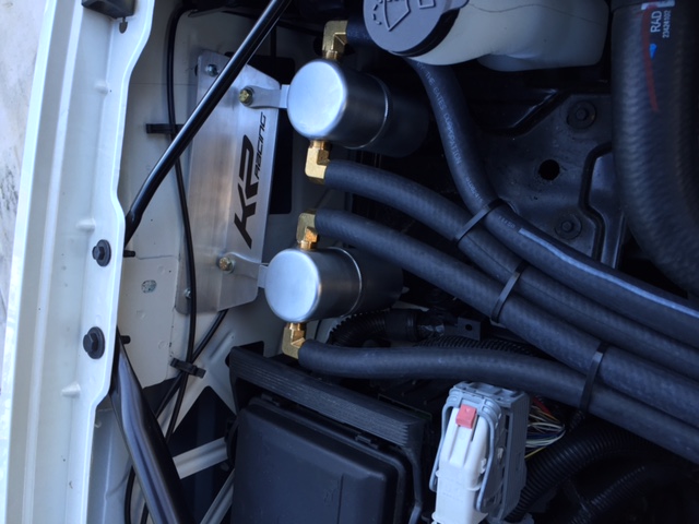

Default duels here 2015 6.2
This is my set up

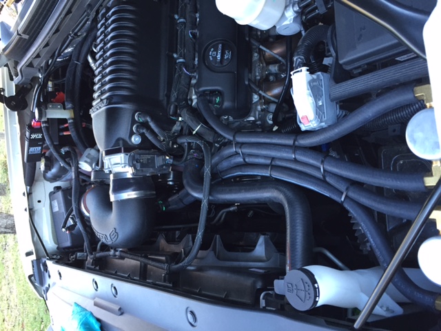

Default Catch Cans
Here is another view

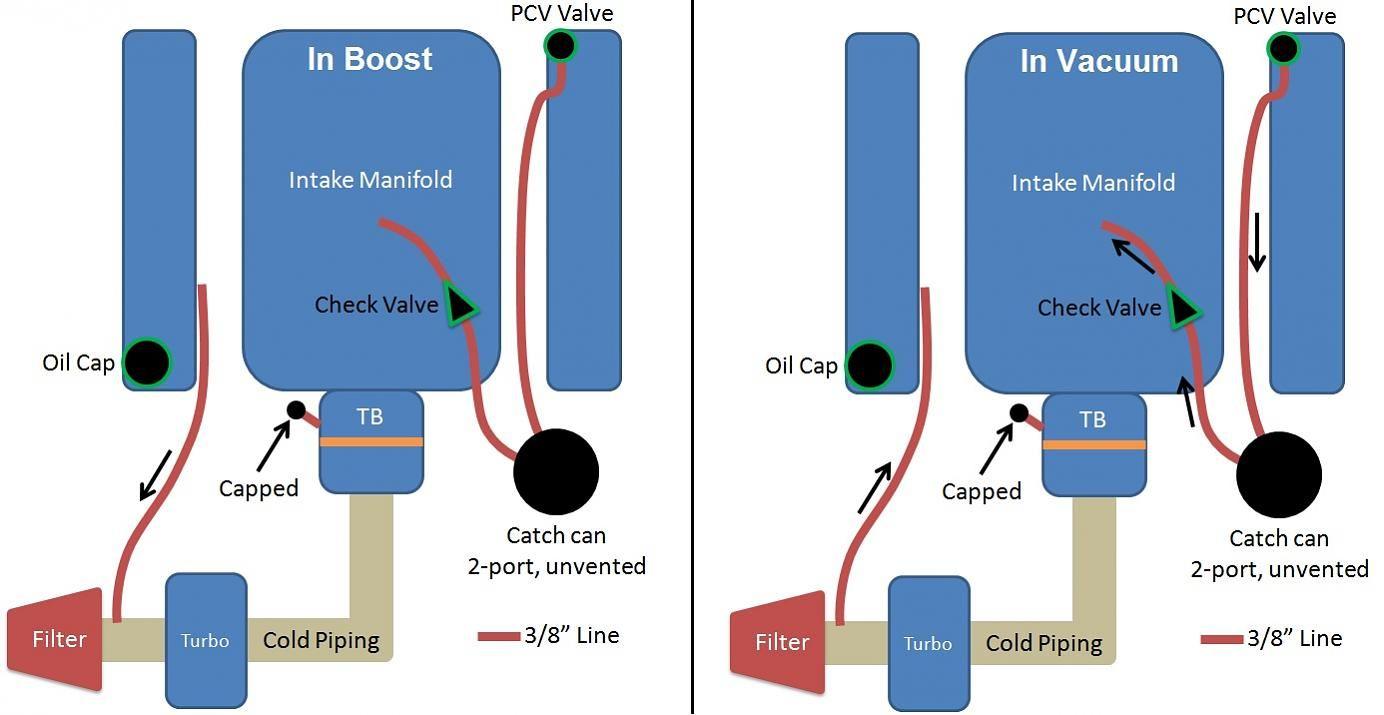

I use Elite's on all my builds.
This is the exact routing I followed:
The hose routing under the intake cover has a check valve GM part # 20861501 before it reaches the intake.
