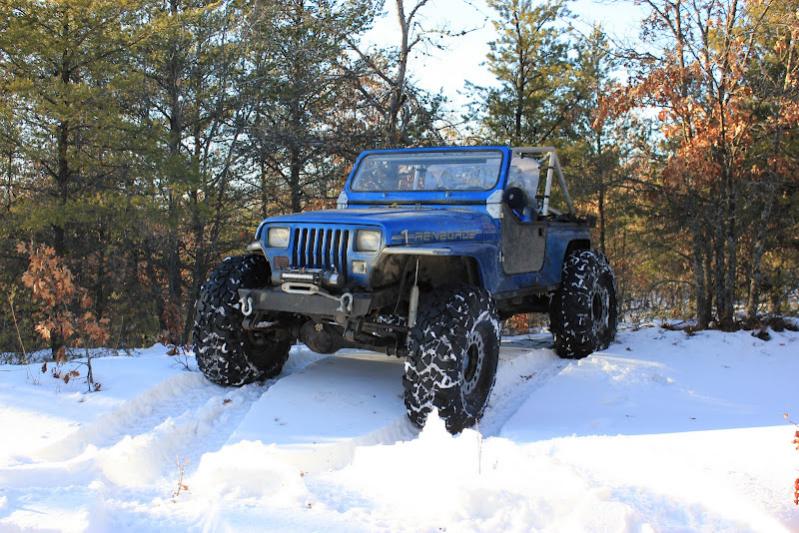

Pics bro!!
Well a single walbro 255 intank works for me, so i would think that pump would be fine for you, but i have little experience with in line pumps, i just know they need to be placed as close to tank as possible.

Pics of all the parts sitting in the garage? Sure I can do that! Attached is one of the Jeep earlier this winter.
As far as the pump, I'm already running the external pump with the stock 4.0 so that's why I asked. I have an RCI fuel cell in it right now which I guess I could get the walbro in tank pump and figure out a way to mount it.
