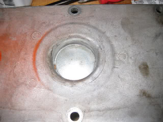

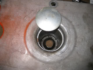

Check out my knock sensors:
Guess I need to swap mine over or find a cheap set.
