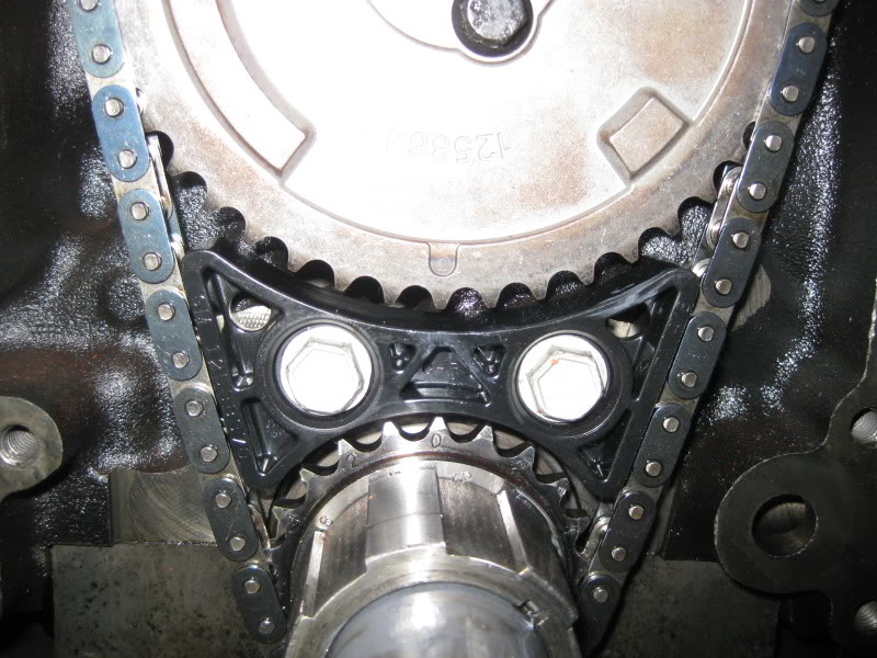

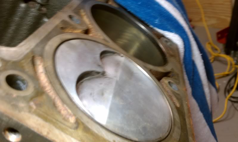

Got the cam in and timing chain issue sorted out. See the keyway at 45* and the "0" at 12 O'clock....#1 also at TDC.

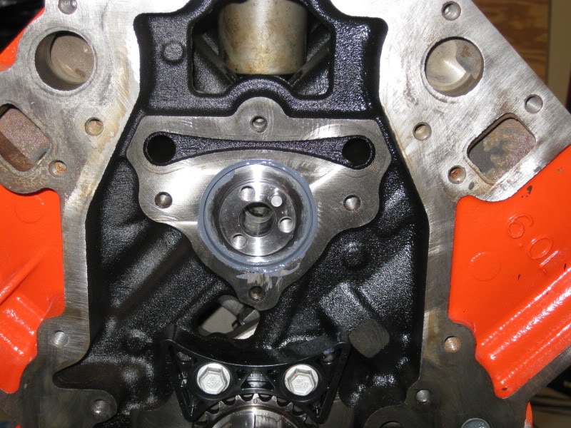

Found the oil pump O ring to be destroyed. Not sure if I did that taking it off or...so that needs to get bought tomorrow and replaced.

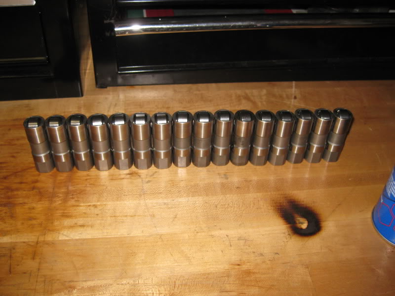

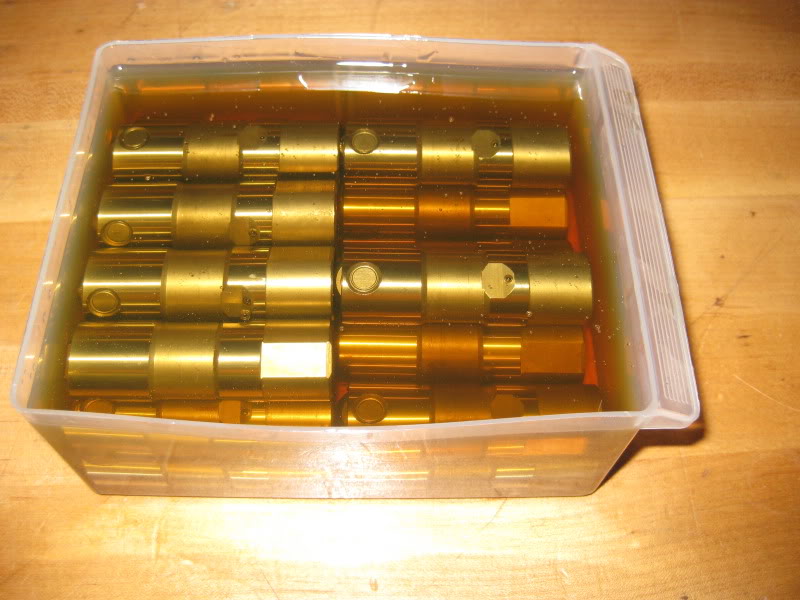

Got the lifters ready...

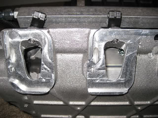

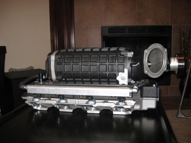

Do any of you have any pics of a2300 lower blower manifold? Is this the correct blower for my LSA/rectangular port heads?
And these aren't the right gaskets:
Size:  24.3 KB_____________

Dot to Dot.... Note to self?
Old Feb 19, 2011 | 08:58 PM
  #127
1SlowHoe's Avatar
Destroyer of Transmissions
iTrader: (28)
Joined: Feb 2005
Posts: 4,962
From: Orlando, FL
Ya, when I'm rotating the crank to tq the rocker arms. I put the front cover on before I put the heads on. Didn't really think that through.
The other side say 12 O'clock, to reference the cam gear dot.
I'm not really sure what that is all about. I dont think the valves would hit my pistons even if the piston was all the way up and I torqued the rocker arm on that cylinder. Is that procedure more for guys with big *** cams and milled heads?

[QUOTE=1SlowHoe;4646479]Do any of you have any pics of a2300 lower blower manifold? Is this the correct blower for my LSA/rectangular port heads?
Uhh....something looks not quite right to me.
Old Feb 19, 2011 | 09:25 PM
  #129
1SlowHoe's Avatar
iTrader: (28)
Joined: Feb 2005
Posts: 4,962
From: Orlando, FL
Those cathedral port gaskets dont fit the blower so that's a good sign...
Old Feb 19, 2011 | 09:26 PM
  #130
SRTKLLR's Avatar
Joined: Apr 2010
Posts: 341
_____________
Those look like they are the cathedral style but I think the LSA heads have the rectangular style.
