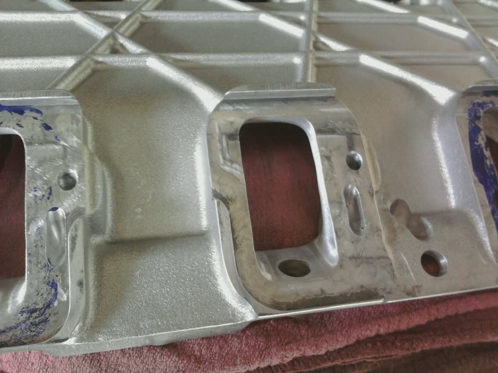

I just had WCCH do my lower intake on my TVS2300....Richard and those guys do an awesome job..[IMG][/IMG]
