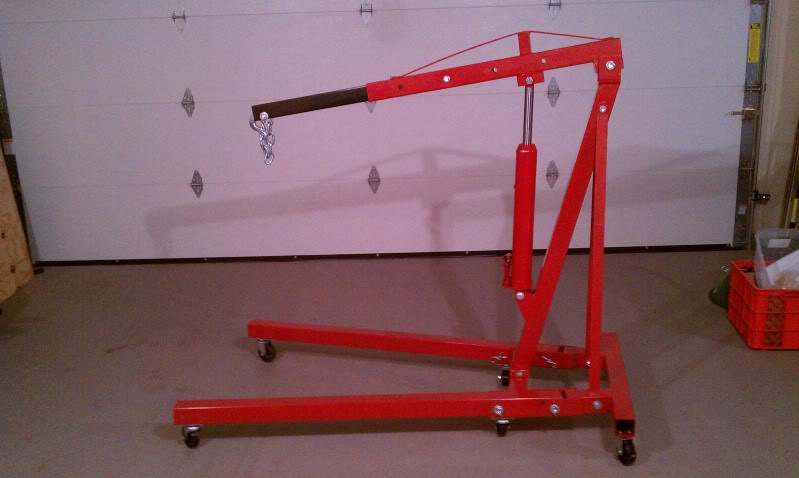

New toy to help me swap

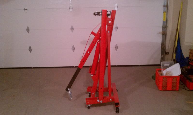

Folds up nice too!

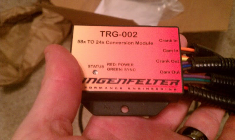

And parts are starting to show up...
Folds up nice too!
I have that same one!!
