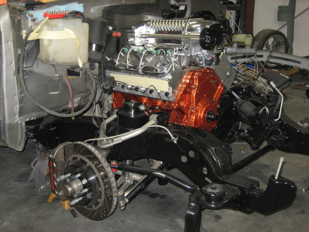

Old Jul 10, 2012 | 09:18 AM
PRO TOUR HOE's Avatar
Joined: Jul 2012
Posts: 159
Dirty Dingo they have adjustment so you can move the motor forward or back to get it just where you want
