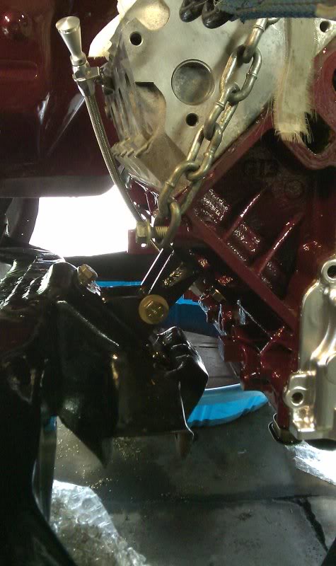

Dirty Dingo here. Going to set them all the way back.
I modified mine to work with some Moroso solid frame pads.
