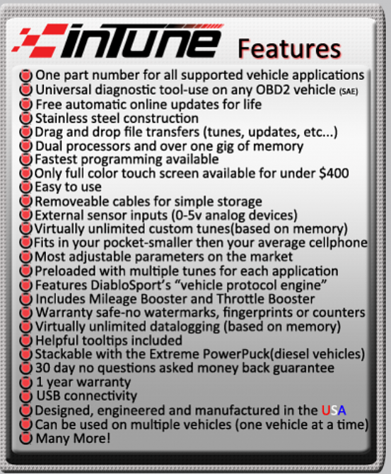

I took this off of Diablo's site. They say "Warranty safe no water-marks, fingerprints or counters". Are they wrong? I would like to tune my 2011 5.3 but not if it means losing my drive train warranty.
DiabloSport :: Gas and Diesel Tuning Systems
