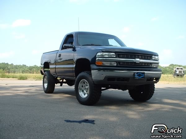

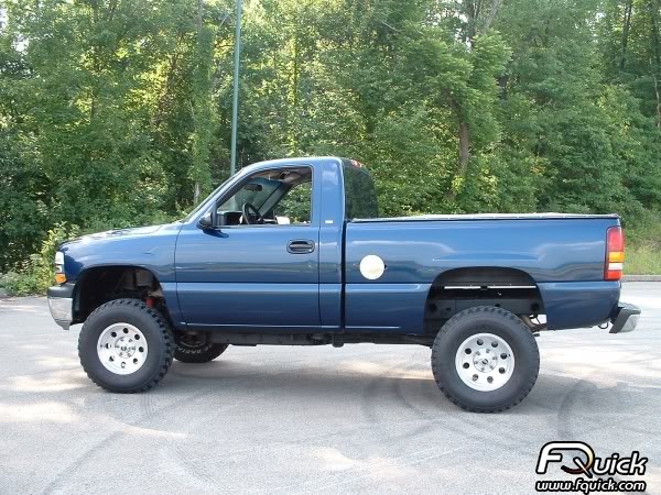

F150 keys - AAL - 3" BL - 285/75/16s - 16x8 AR Baja

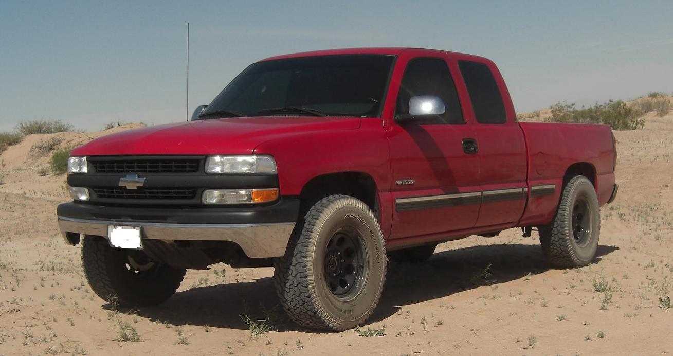

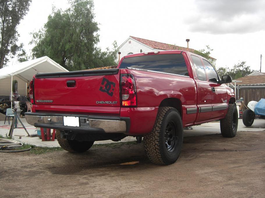

4" spindle, deaver leafs, 315/70/17 5"BS
kinda the baja look just black steel

thats exactly what i want to do with my truck, i have 2 inch blocks and tbars jacked, then the body lift is exactly what i want as well. and im thinking ill go with 33s as well. sweet lookin rig man, thanks.

thats pretty sweet looking too man! thanks, i like those rims,

hey whered you get your kit at? and did u need the steering extension? did u move up your back bumper?

factory replacment bilstiens
i have bfg at's they are ok, toyo ats are good, better traction than the bfg's but they are heavy and wide in compared sizes

Thanks man. I got my kit from a local 4x4 shop, but I would recommend just finding one online... google a company called Zone Suspension.. they have tons of great kits available.
As far as steering ext, yes the kit did come with a little ext that needed installed... was very simple. Most kits will come with everything you need, minus the gap guards and rear bumper brackets unless you spend a little more money for them... I didn't raise my rear bumper because I didn't add the brackets to my lift
If I were to do it again I would have never did the 3" body for the size tires I was running... I would have did the F150 keys (slightly cranked), 3" rear blocks and a Zone 1.5" body lift. I hated the gap my 3" BL had, the frame hung out more than the HDs do... the 1.5" kits look great and are about half the price.

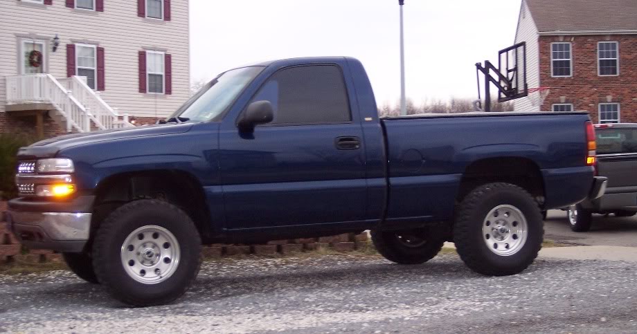

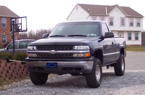

Here are 2 pics of the same wheel/tire setup after I took the 3" BL back off... as you can see I still cleared the 285s w/o any rubbing
