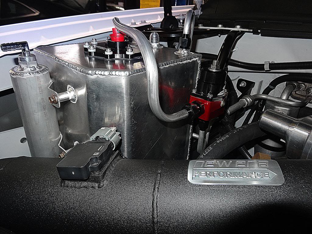

Well, here is a sneak peak picture at what we are working on for the fuel system. We made this surge tank, and placed it where the stock coolant overflow reservoir was, the small reservoir mounted to the surge tank is the new overflow reservoir that we made. We also are installing a new fillerneck in the upper radiator hose. This isnt complete, we are waiting for a few fittings still, which will be here in a couple days so this will sit like this until then. Then we will finish plumbing everything. We created an electric device that allows us to alter fuel pressure report to the FPCM, so we are going to try to use the stock fuel pump and FPCM to feed this surge tank which is equipped with an Aeromotive A1000 fuel pump, which will also utilize a full return fuel system. I hope it works, testing will tell...

So does the stock fuel pump pressurize that tank?

It shouldn't really see pressure. The stock pump feeds this, then the a1000 feeds the fuel rail, then the return line comes off the other rail back into this tank, then another return line feeds back to the stock tank from this surge tank. The a1000 will also have a variable speed controller so its not running full tilt at idle and cruising speeds.

This would allow us to go back to stock system in a breeze too!
