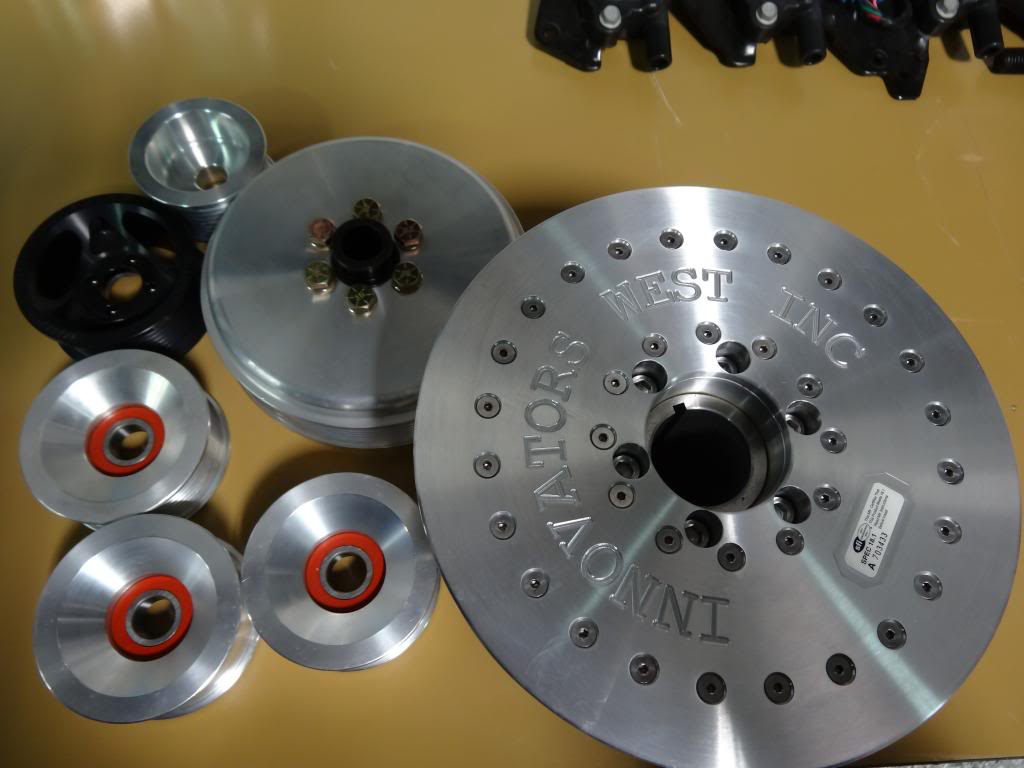

Well, it's finally back in the shop. We are installing the pullies and a custom cam first, then it will get moved over to the other side of the shop to get the fuel system designed. I will get more pics as it goes on.
This pulley configuration will achieve maximum efficiency blower speed at 6500 rpms.

Oh hell ya! That pulley kit looks sick

What psi will this put you at, previous was like 12psi right?

Before this I was running about 15 psi with the 6 rib belt (which I will add, was pushing it with a 6 rib belt, wouldn't reccomend it), this will get at least 18 psi, maybe close to 20 psi.

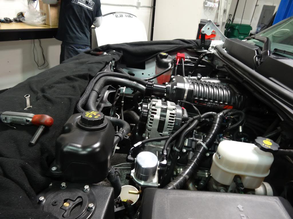

Is that a cup under the catch can? Were u draining it? How much oil was in it and how often do u check it?
U guys think it's a good investment for any boosted truck?

I have a catch can on my truck now, basically stock, and its great to have. I say I empty an ounce or two of oil every oil change.
Yes, that is a catch can, and yes we were draining it. I check it once every month or 2, generally 1-2 ounces of oil. Yes, I think it is a good investment.
