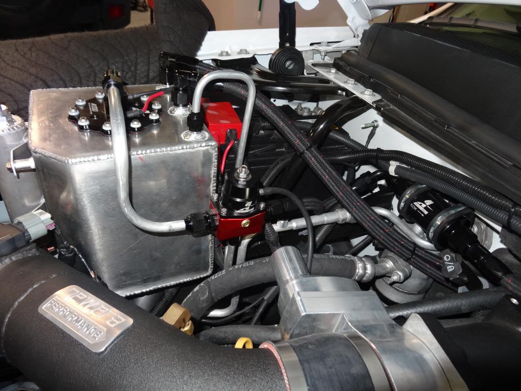

The surge tank idea is neat, I thought about this more than a year ago as a solution to our truck's fuel system limitations however I didnt think it would be this involved until I spoke to Mike about it, if you were doing this on a truck with no FPCM it would be pretty direct, but the FPCM is what makes stuff tricky.
The stock pump has the capacity to keep the surge tank full at all times, since you do not require it to pressurize. The big pump can pressurize the rails all you want, and the variable pump speed controller on the big pump makes it run quite and cool and increases the pump life = win.
Surge tanks are famous with roadcourse racers and extreme offroaders and who are worried about fuel sloshing and jumping around in the tank, this solves all those problems for good.

Originally Posted by Mike @ New Era
My battery is in the stock location still, untouched.
Ok. I guess your 2012 Sierra has the battery in a different location than my 2011 Silverado, unless I can't see it behind the surge tank, it's hard to tell in the picture. It appears your meth tank is in the location of where a 2nd battery would go in my truck.
And I fully agree, that is a genius idea to solve the fuelling problem so common for high HP set ups in these trucks. If you had the means to make it a kit, I'm sure it would sell very well. This reminds me so much of how we design fuel delivery for emergency back-up diesel generators, with a large main tank and also a smaller day tank near the engine, with seperate pumps for each tank.

Here is a picture showing the stock battery location in reference to the surge tank.

Well, this fuel system certainly worked flawlessly on the dyno. Made 628 rwhp staying conservative in the tune, without any fueling issues whatsoever. I am going to try swapping blower pullies tomorrow, the boost maxes out at 16.9 psi currently and is at 16 psi at peak hp (6400 rpms).
