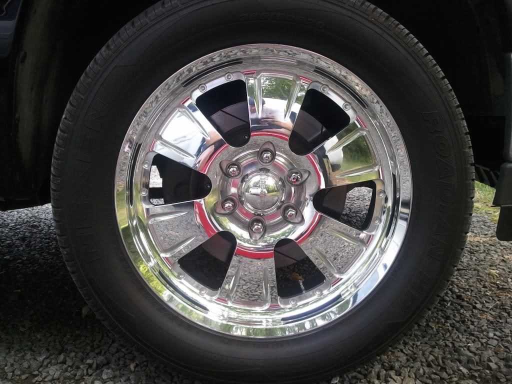

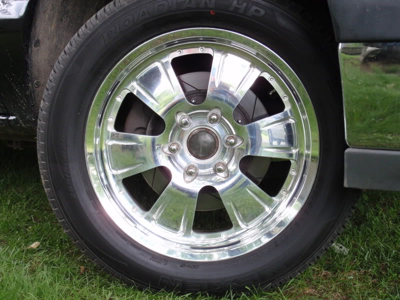

The Adams stuff couldnt be easier to use. You hardly have to put any elbow grease into it to get it to work good. Here's how it did on my Centerlines...
Before...
After

No offense.. The wheels you posted are far from being gone, have at a best some minor oxidation that a decent polish should take care of, but even by hand is going to be a bitch.. If you have rims that are pitted, actually have hard blemishes, hard oxidation, no wheel polish will bring it out by itself. It needs to be cut down, then finished first.. TO THE OP POST PICS ..

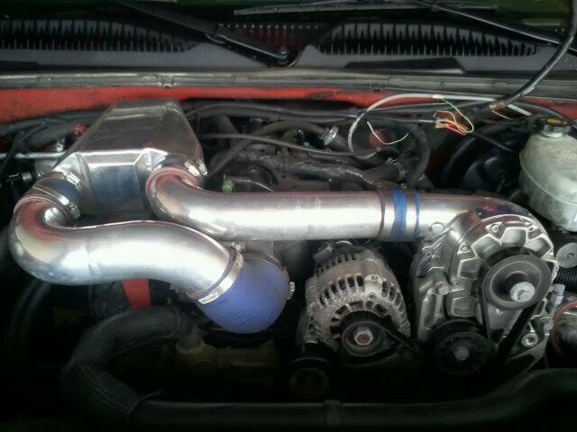

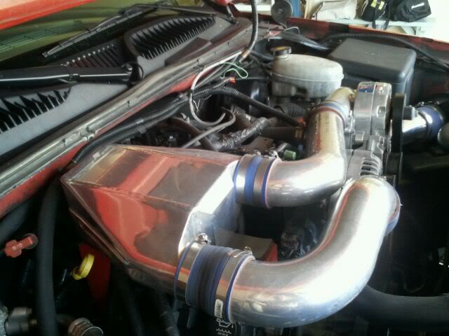

Here are a couple of pics. I guess it's been 6 or 7 years to get this bad.

Doesnt look that bad to me at all. Take some scotch brite to it first then hit it with metal polish.

Doesn't look horrible, before doing anything else. Hit it with some metal polish real quick and see where that gets you. Then if needed, can go to coarser materials.
