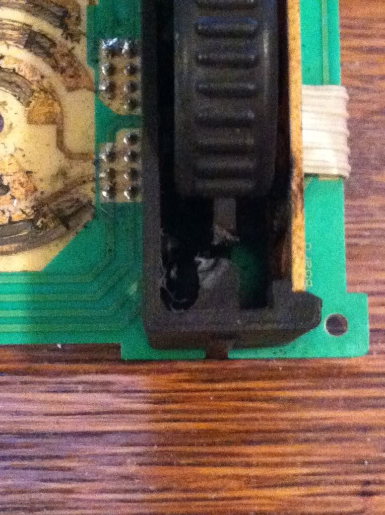

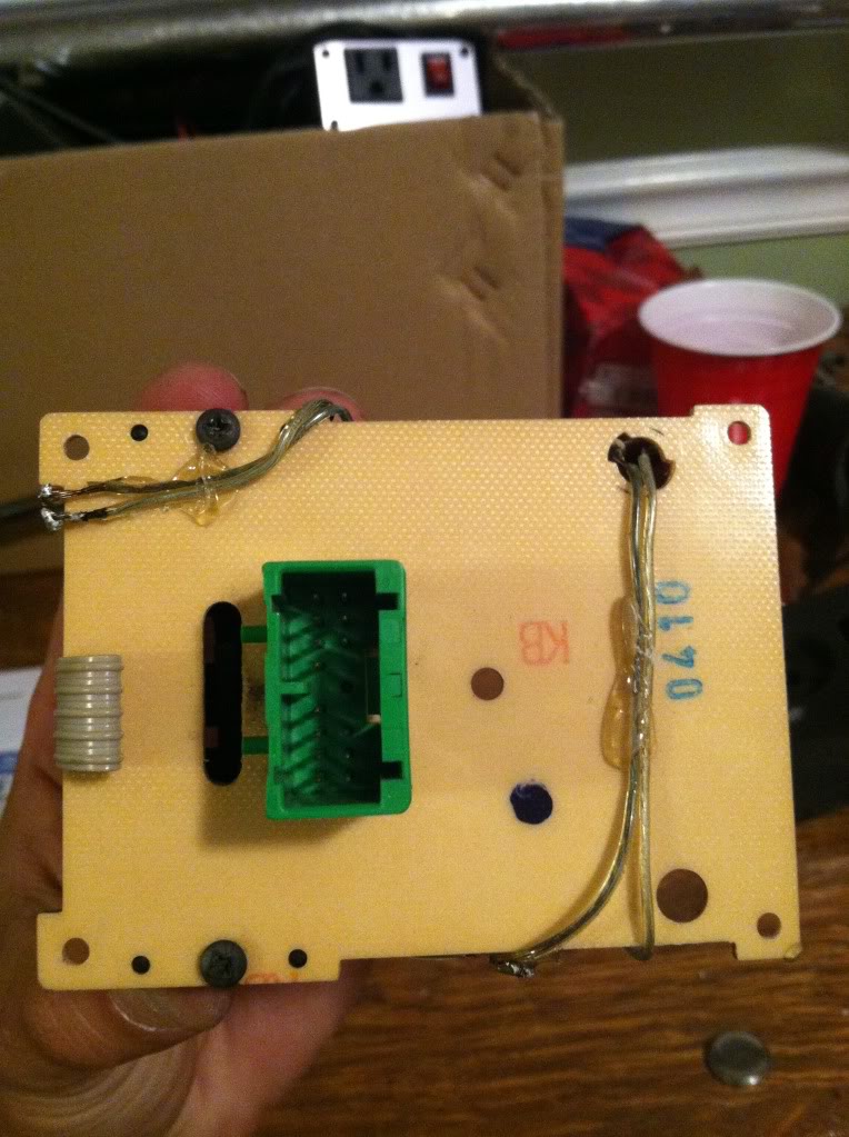

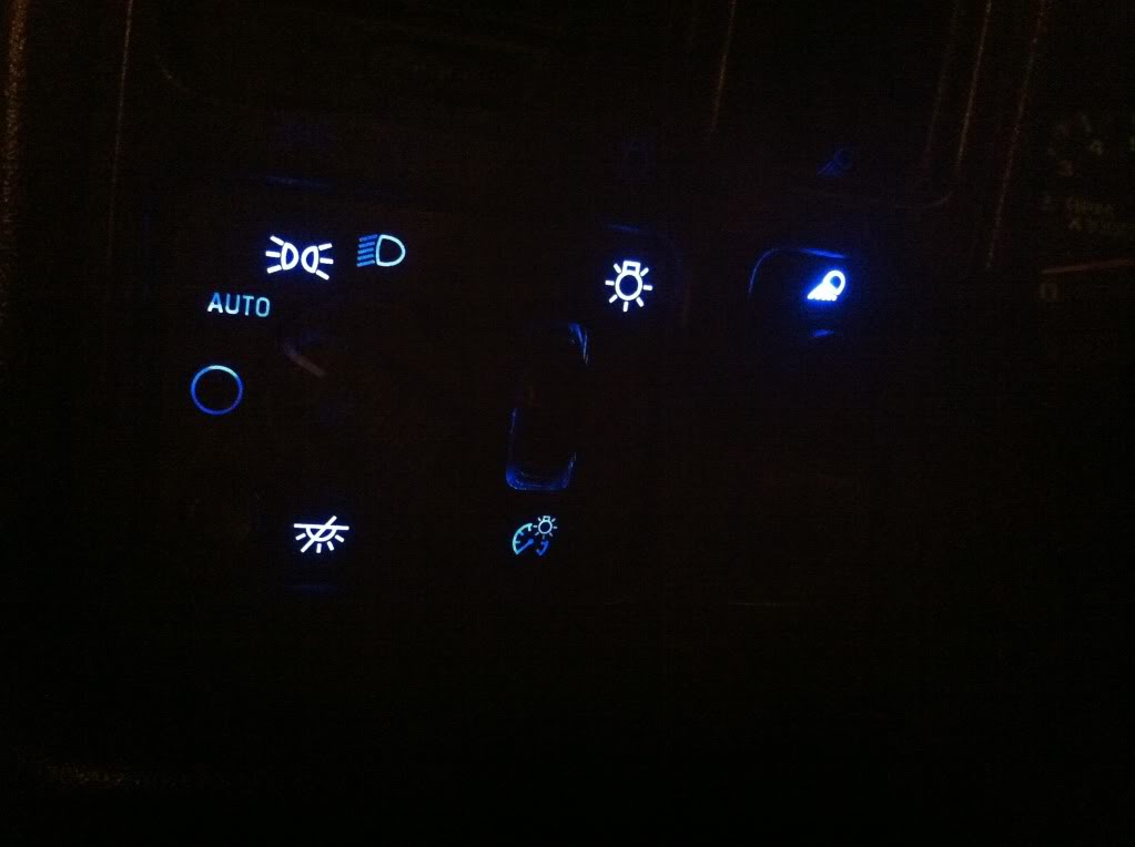

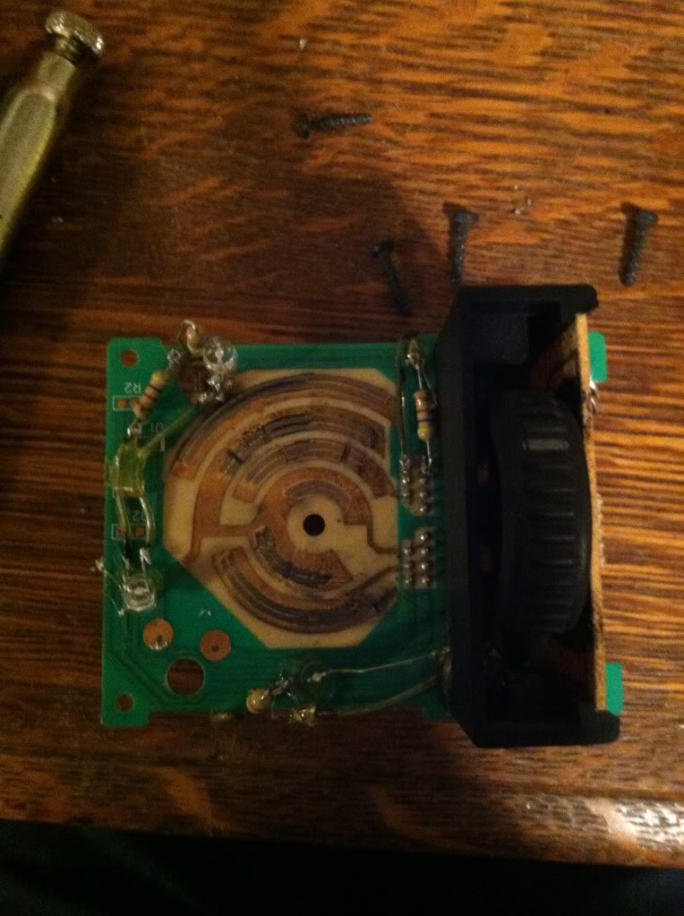

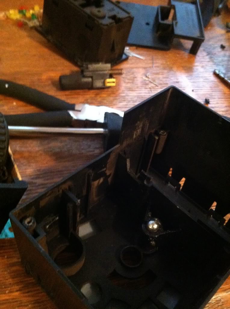

Finally got around to finsihing up the headlight switch and the cargo light button. here are some pics showing what I did. Ended up with 5 LED's on the headlight switch circuit board. There are some hot spots but overall I can live with it. I was able to get the dimmer switch icons to light up as well.

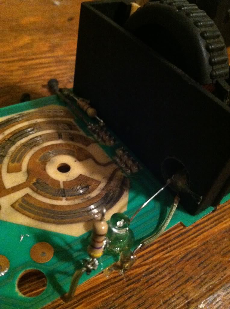

had to modify the housing so it didnt pinch the wires going into the dimmer switch, also had to drill out only part of the dimmer roller stop at the bottom of the dimmer roller so more light would come through.

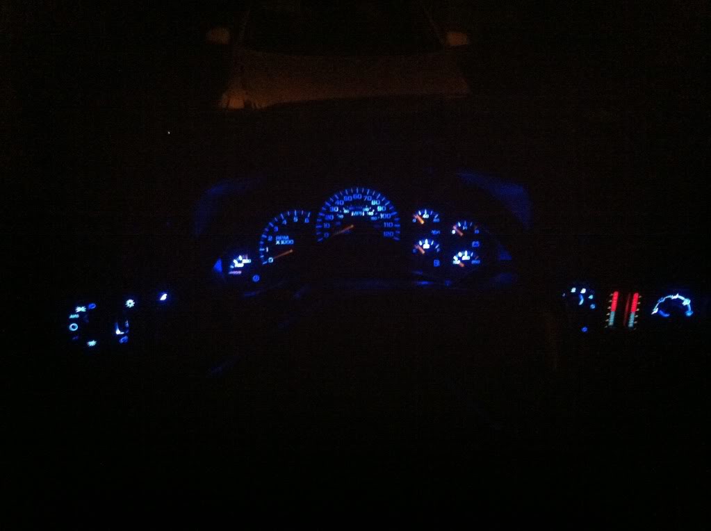

and the final product looks like this
