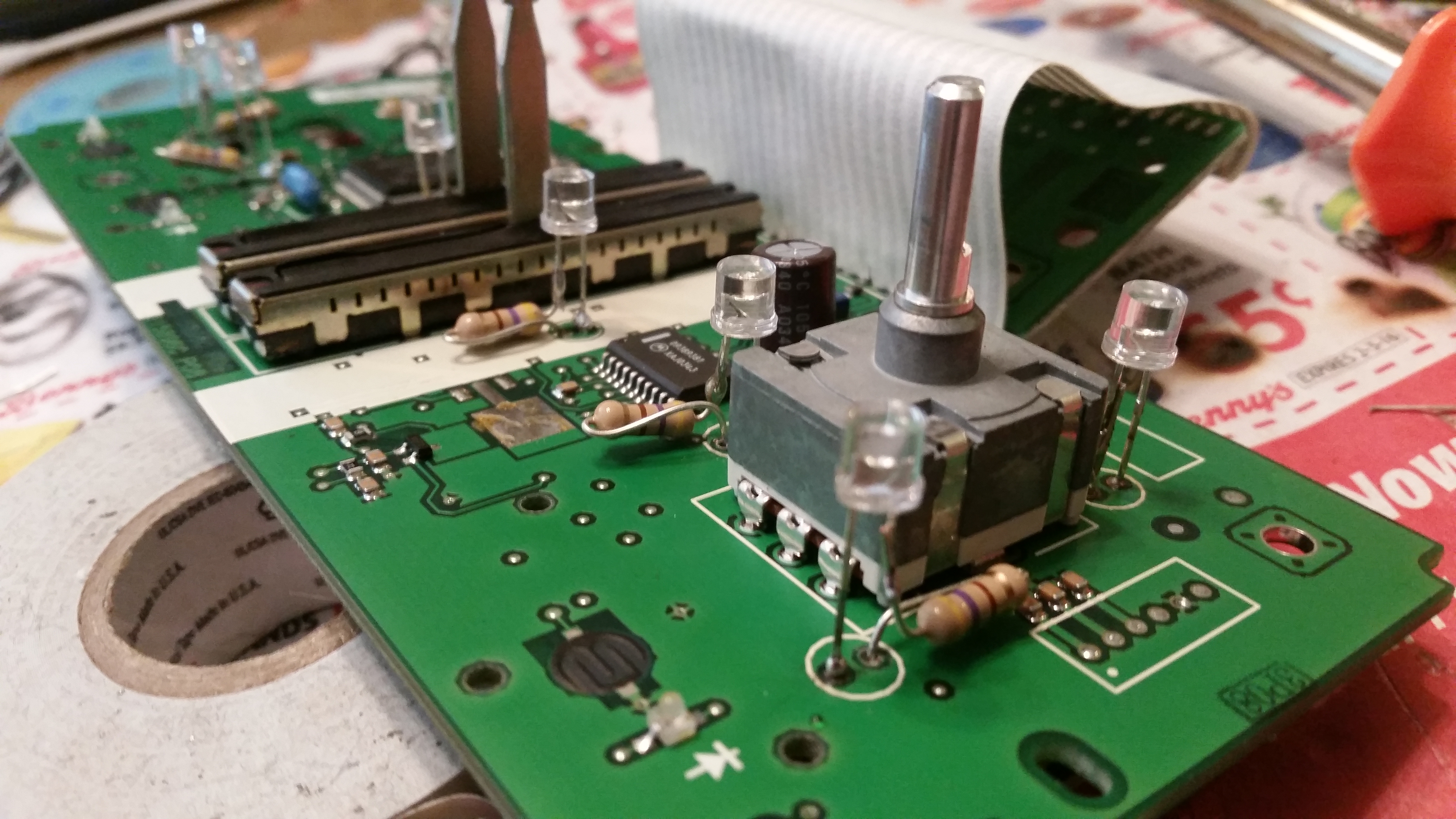

Does anyone have any ideas or info on finding polarity of the 10 bulb contacts on the stock radio board. I didn't want to take the circuit board out, have it loose and replug it into the radio harness risking damage to it. I finished climate control with no problems and want to do the whole show.
a volt meter is your friend
The board comes apart pretty easy. The manual ***** were the hardest to do.
So you're saying I should plug the board back in to truck, power and meter it out? That's all good. I was just hoping for a way to do it in the comfort of my living room. Thanks
I took the whole radio apart.
installed the radio back in the dash with the board plugged into the ribbon cable
I used a body ground, and then used the positive side on the meter to tone out all of the positive sides on the board.
I marked each one with a sharpie
took the board back in the house and started the solder work.
