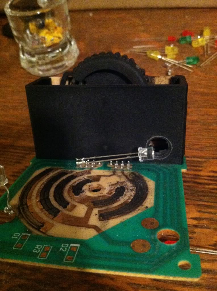

Old Jul 25, 2013 | 12:32 PM
  #150
splash07s's Avatar
Joined: Jul 2013
Posts: 14
OK got em on and they are superbright and awesome! I also think I may have figured out how to light up the dimmer symbol at the bottom of the dimmer wheel. I drilled a small hole in the dimmer plaastic housing, then soldered in an LED to the posts the orginal bulb ran off of. I forgot to put a resistor in and I would recommend it cuz I blew the first LED out when I hooked it up to power. I need to extend the LED just a bit to get it in the hole though, but you guys get the idea.
