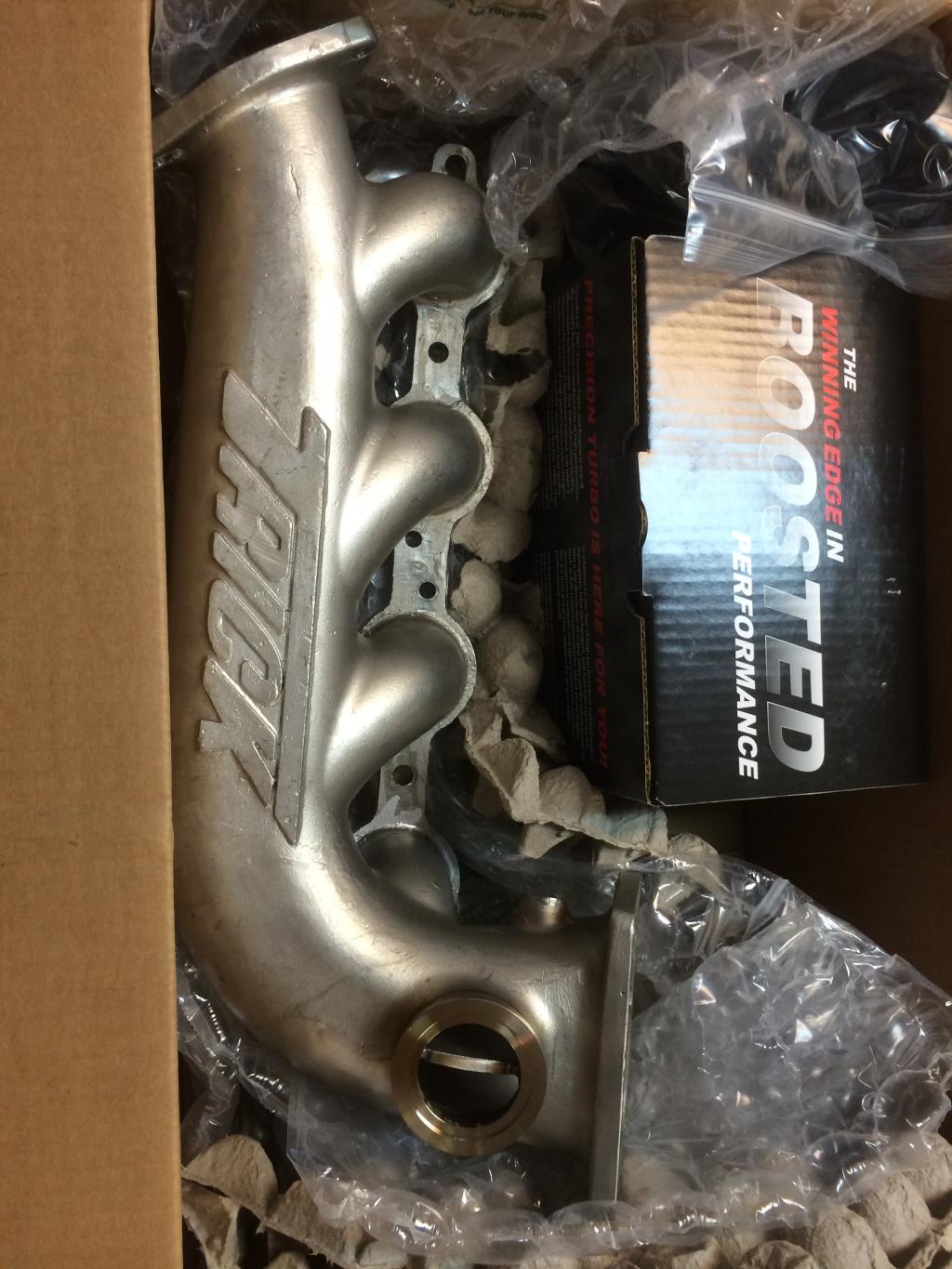

Few more parts trickling in. Big thanks to Rick for getting this awesome manifold and WG to me so quickly!

Woooo that looks nice.
