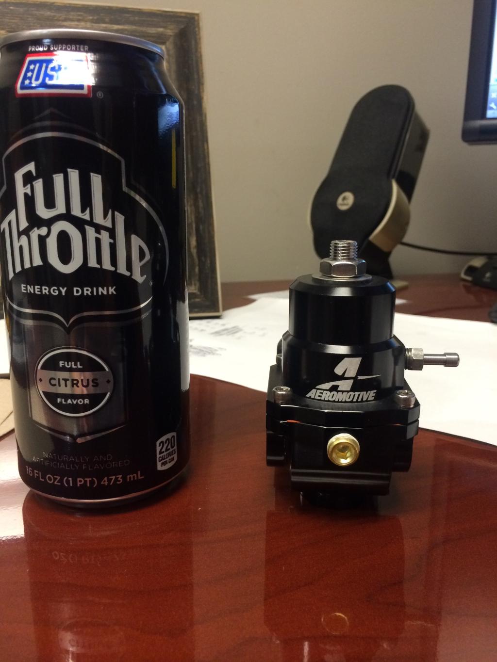

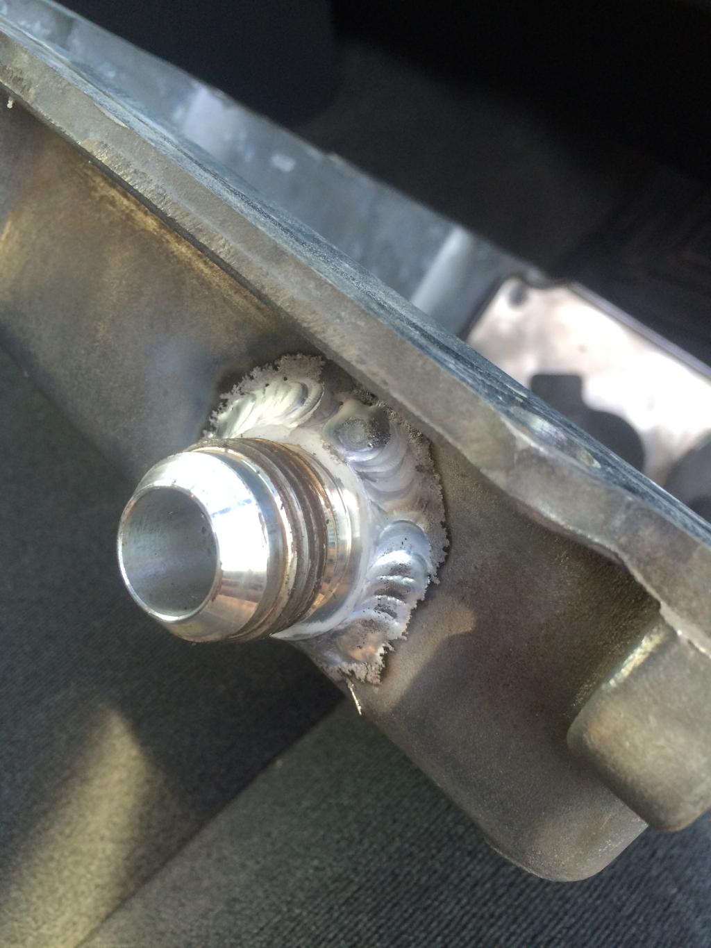

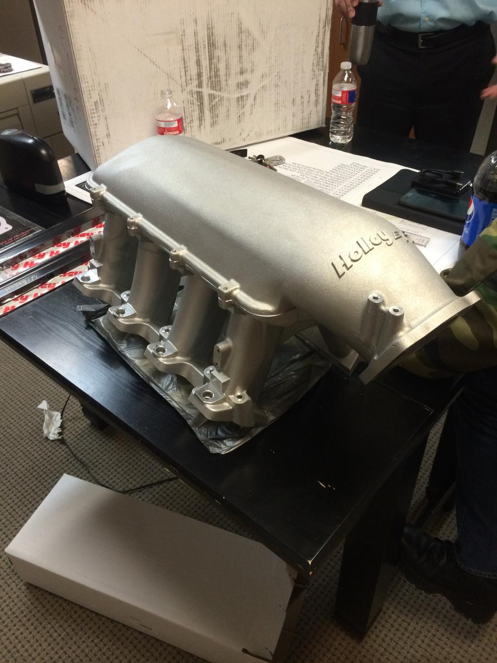

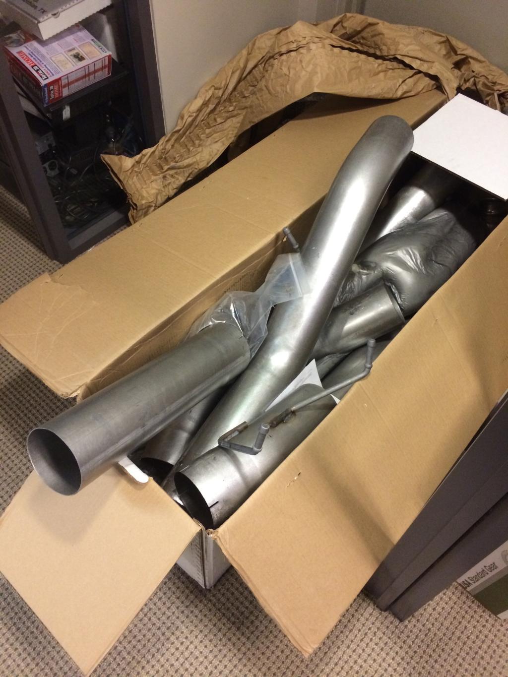

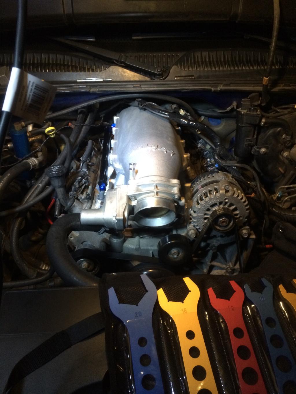

Not for the turbo build but figured my tow rig could use an exhaust upgrade!
