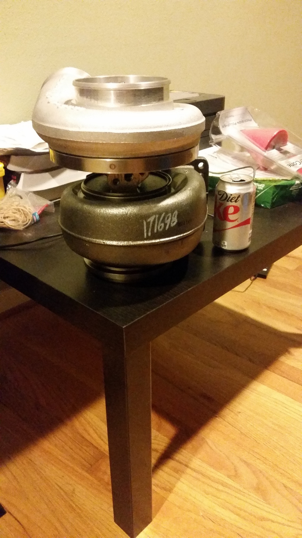

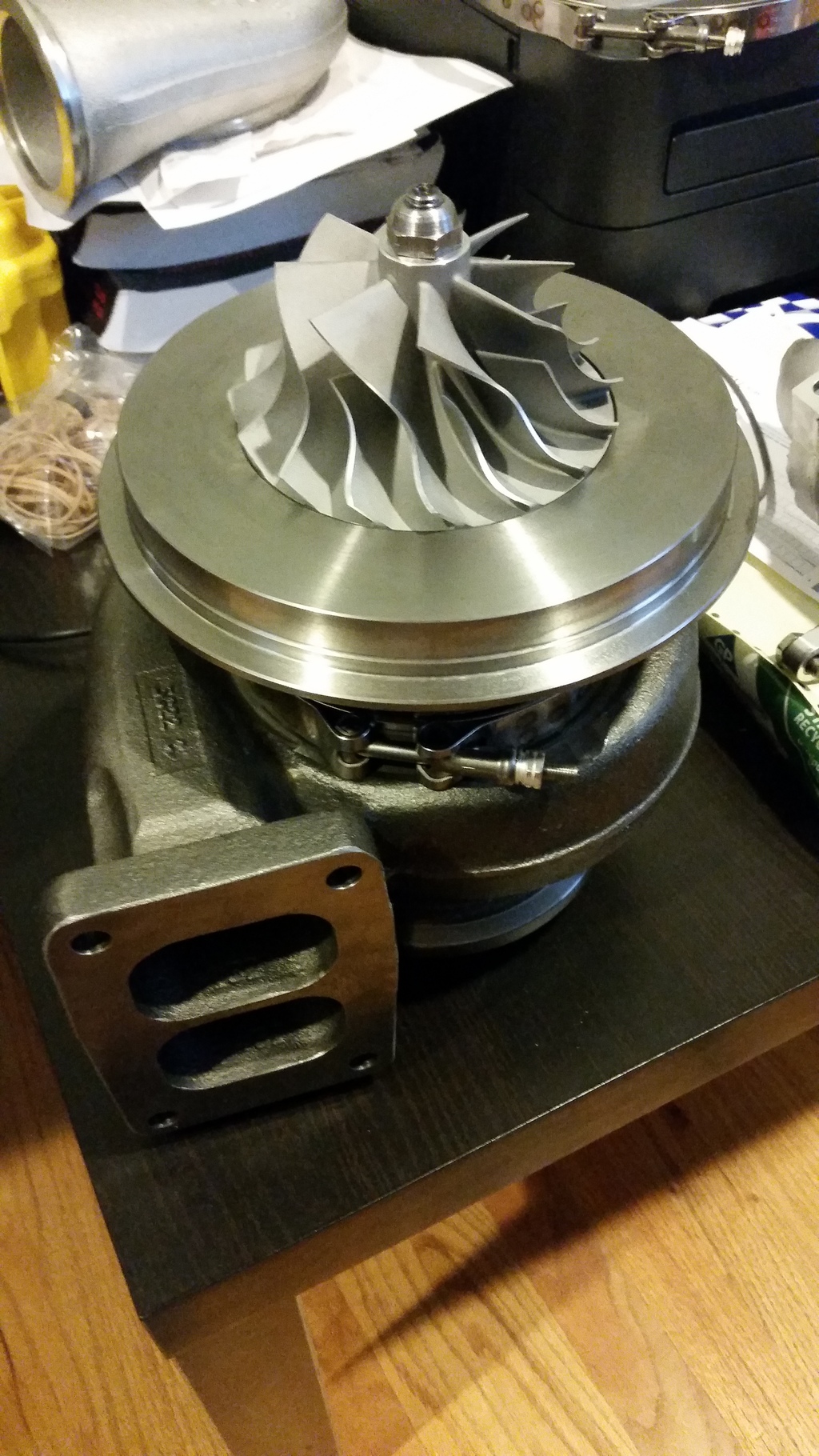

Thought I'd update this. Truck is down for big modifications.
As the saying goes, anything that can go wrong will go wrong!
For some reason I thought it would be a great idea to pull the torque converter without draining the trans (I wanted to conserve the fluid). Well, the second I pulled the dipstick tube out it was a blood bath. Trans fluid everywhere.
Got that out pretty uneventfully otherwise and had the converter restalled from the 2B to 1A. Goal is to go from a 550 shift extension to 800-1000.
Re-installing the torque converter was another joy. I knew the combo of the billet input shaft and aftermarket TC was a bitch the first time around, but this time I said screw it and took the rubber mallet to it while spinning the converter. Go it seated fully in verifying by measurement (~1" from bellhousing). Converter still pulled out easily so no damage done using the mallet and I also asked CircleD about this they said it was fine.
I've got the harbor freight scissor trans jack (chinese POS). So I get the trans all the way up but then had to bring it down to re-align it. Mind you, the truck is on jackstands so I'm working on my back here with a fully loaded 80e. The combo of the trans fluid coating everything and next thing I know the trans was slipping off to the passenger side. The way this jack works, the sides go up and down asymmetrically so it automatically causes tilt. I knew this wasn't going well so I started bringing down the trans from a height of about 12" and next thing I know the trans slides off the side and comes down on the ground. No damage done externally but now I had to figure out how to get a 250lb trans back on the jack under the truck. Somehow after much cursing I was able to lift/pull the trans back up on the jack and install it. But, not after I forgot to put the dipstick in. Note, the dipstick CANNOT be installed after the trans is in place. So I get the trans in, dipstick located. Trans fully bolted up and then I cannot get the rubber grommet seated in the dipstick hole! Had to pull the trans off the engine again, remove the dipstick fully, push the grommet in and re-install. After that fiasco I got everything installed, driveshaft back in, and all electronics reinstalled to the trans.
Note, converter to flexplate spacing was 3/16". Interesting tidbit from Brian@CircleD. Spec on the flexplate spacing is 1/8" - 3/16" however, if the spacing is too close it can cause the clutches in the converter to try to apply in park, idle, reverse. This may be the cause of chattering that some get with the triple disk, I'm not sure. The cure to this is to open the converter gap up on the bigger side and in fact, a gap up to 1/4" is acceptable and promotes more flow to the pump.
So, Now all I'm waiting for is my DEI titanium wrap to arrive. I wasn't going to wrap my hotside, but KB convinced me with his anecdotal evidence with his rear mount setup.
The new turbo is a hoss to say the least, and the 80mm wheel looks sweet compared to the 75. The workmanship on the new kit from Kyle is incredible. He's made some tremendous upgrades to the kit compared to my old one. I should be up and running by the end of this weekend and I'm really just hoping when I fire this thing up there's no issues, no leaks and it runs just like it did before I tore it down.
