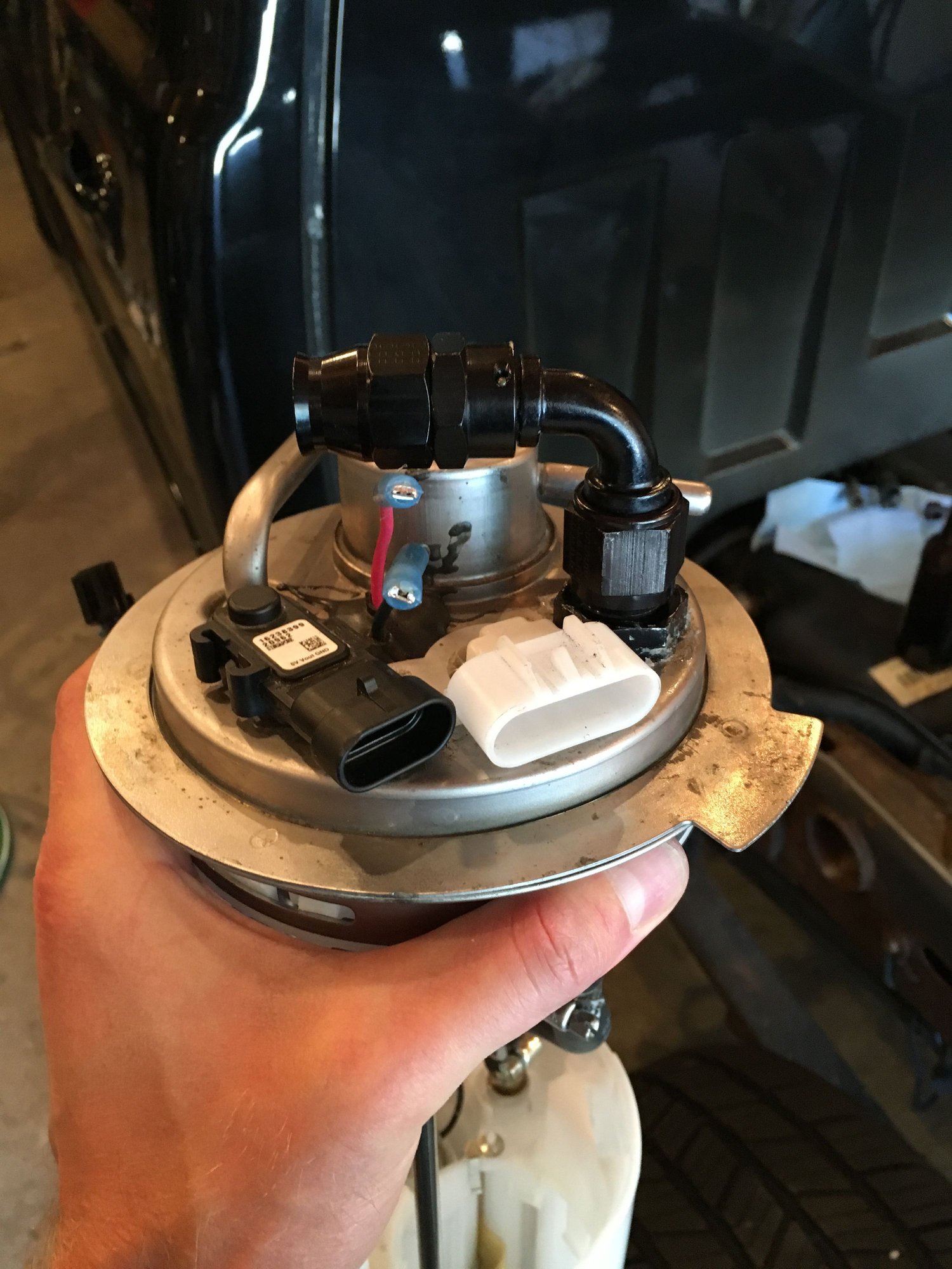

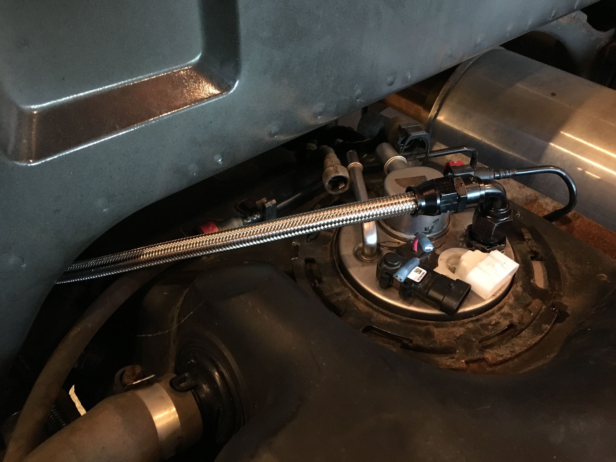

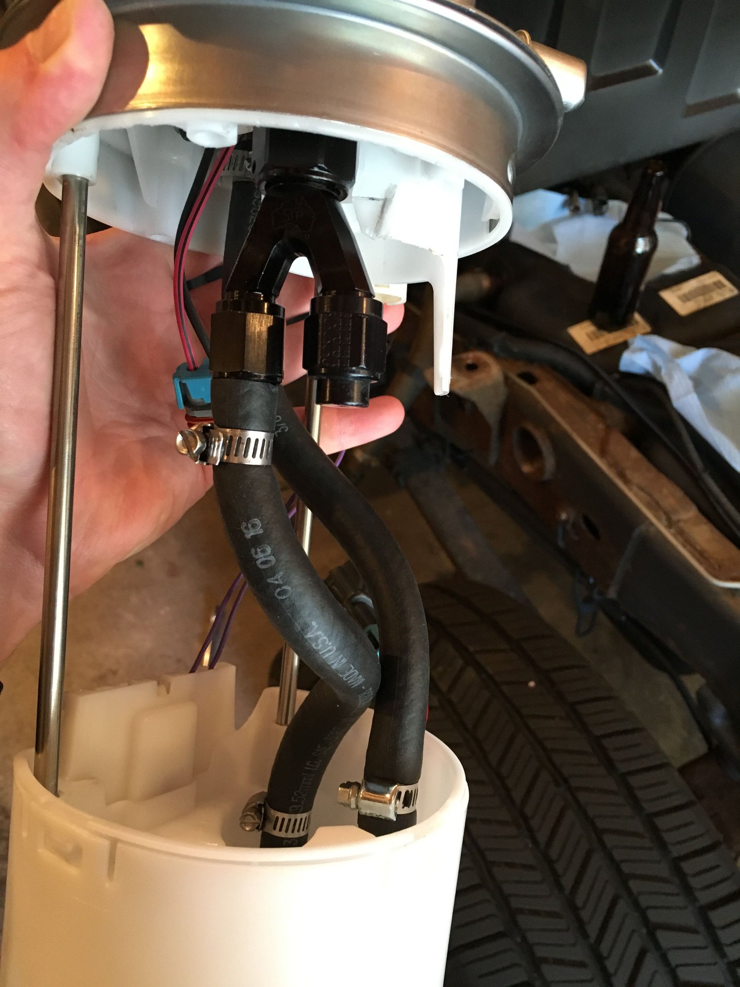

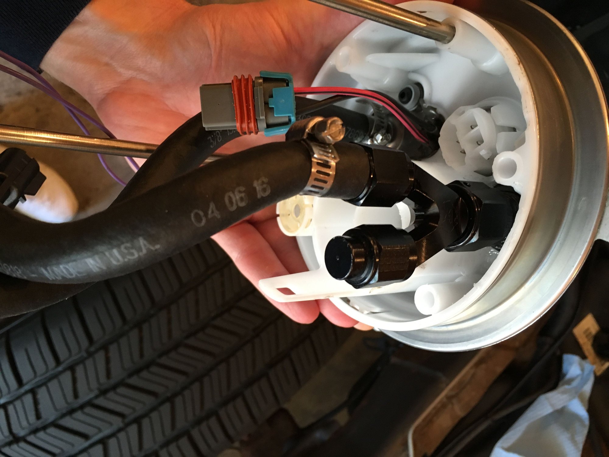

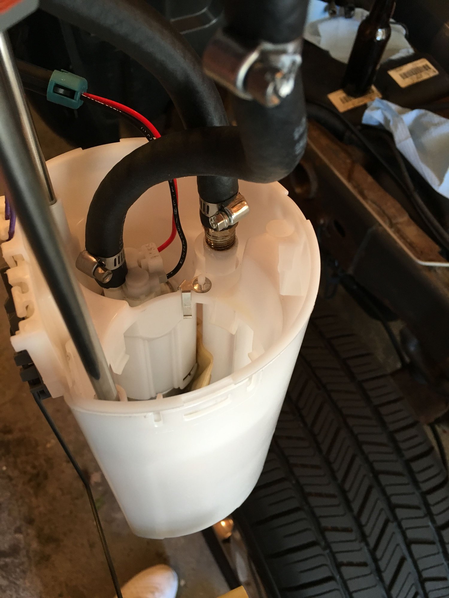

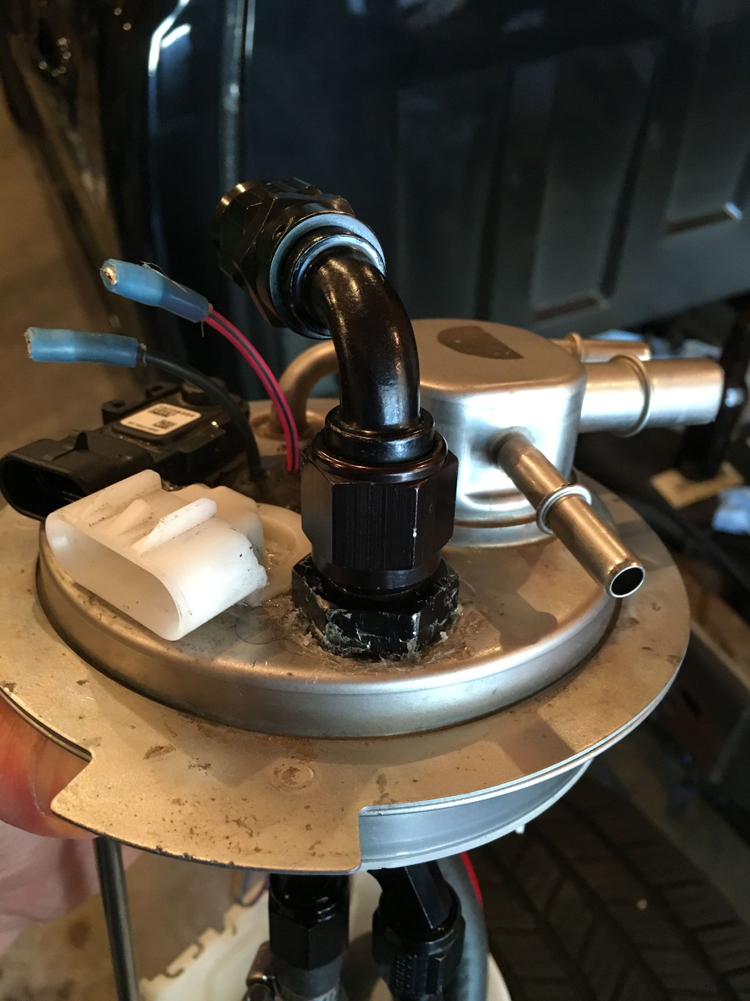

Didnt get many pics during the process. I never really do lol.
I screwed up one connection but otherwise there are no leaks and its holding pressure just fine.
I used a dual fitting inside my bucket to make it that much easier if I do decide to go to dual pumps.
I'll get more pics this week of the regulator and lines under hood.

Agh rob, worm gear clamps.... Really...

I know. I bought the others and everything. They were too small and I was too pissed to leave again. I've never had an issue with them in the past... who knows.

Remember this moment when you stranded in the middle of no where and you have no fuel pressure because of the worm gear clamps.

Dude, pull that assembly now before it fails. I see in at least 1 pic where the gear clamp cut thru the hose. Bad stuff.
