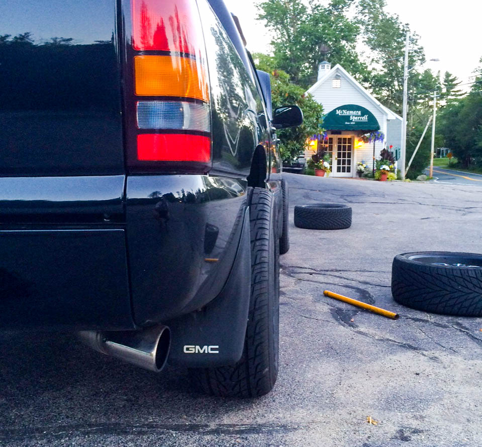

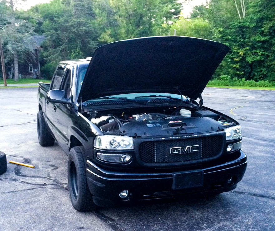

Old Aug 16, 2015 | 04:17 PM
  #299
GM1697's Avatar
Joined: Oct 2014
Posts: 1,568
Likes: 12
From: in MA or SC
Old Aug 16, 2015 | 04:40 PM
  #300
FFDP's Avatar
Joined: May 2014
Posts: 5,282
Likes: 600
From: Rogers, MN
Rear tire is on backwards.
