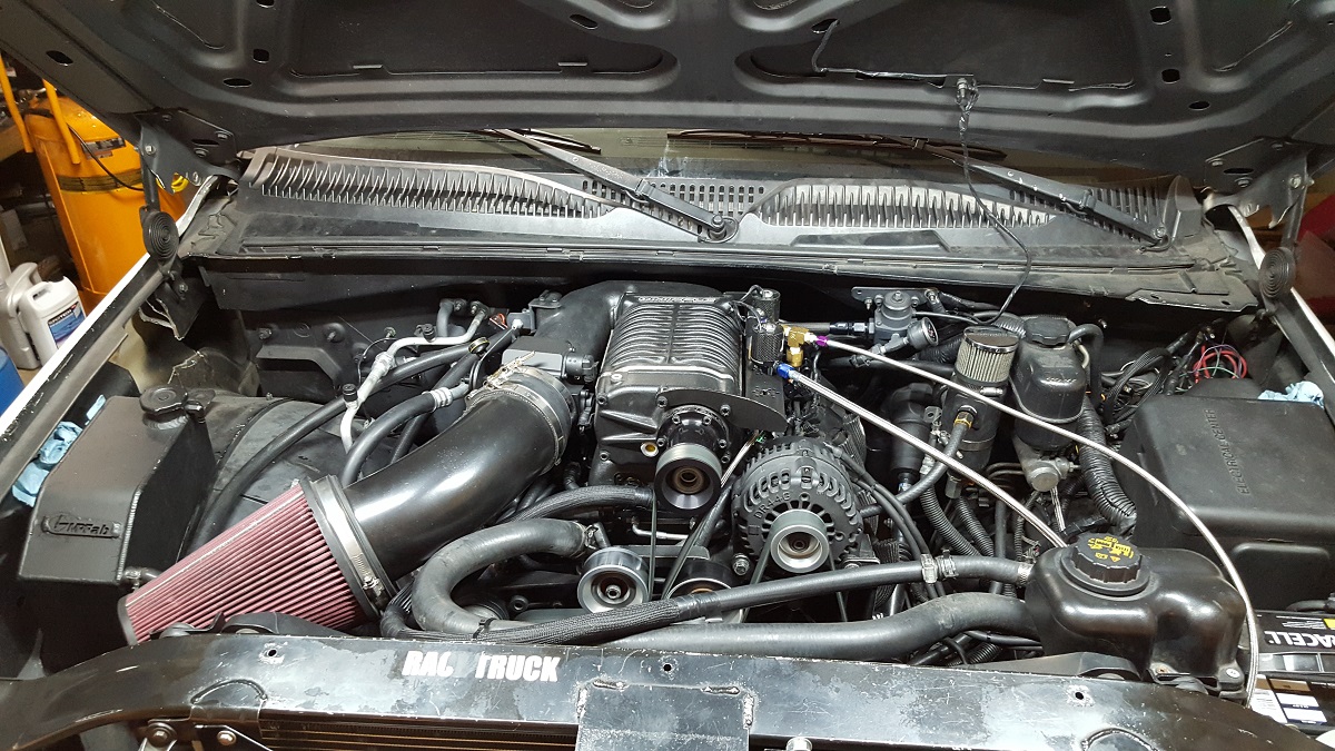

Thinking about adding a second catch can tonight and running both valve covers to vacuum. I'm sick of dealing with small drips from pressurizing the crank or filling a catch can super fast with one to vac and one to fresh air.
Any reason I should proceed with caution?

Get rid of the vac source and problem solved.

Yes and no... I drip oil every now and then without vacuum on it.

I agree, run a big line (-10 or bigger) from each cover to its own tank. Problem solved......if not you have engine trouble.

I am having trouble figuring out exactly where I could mount it. I think I may try on the brake booster but its all a very tight fit on that side. We will see tonight I guess.
Does anyone have any creative ideas? I already have one on my pass side head.

your hydroboost will free up space ...

On the brake booster...
Attached Thumbnails Vortec350ss 2005 Sierra Denali - Forged 370 and cog driven TVS2300-20160514_215017.jpg
