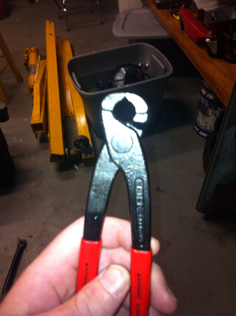

Old Jun 21, 2016 | 07:27 AM
  #807
Smokymance's Avatar
Joined: Feb 2012

Old Jun 21, 2016 | 07:47 AM

Go to your local hardware store and get PEX clamps. They cannot vibrate loose like a worm gear can and the way they clamp down they apply equal pressure.

I thought they were called oteker clamps or something? Dont you need the special crimper for those?
Your supposed too. I used this. Worked like a champ.
