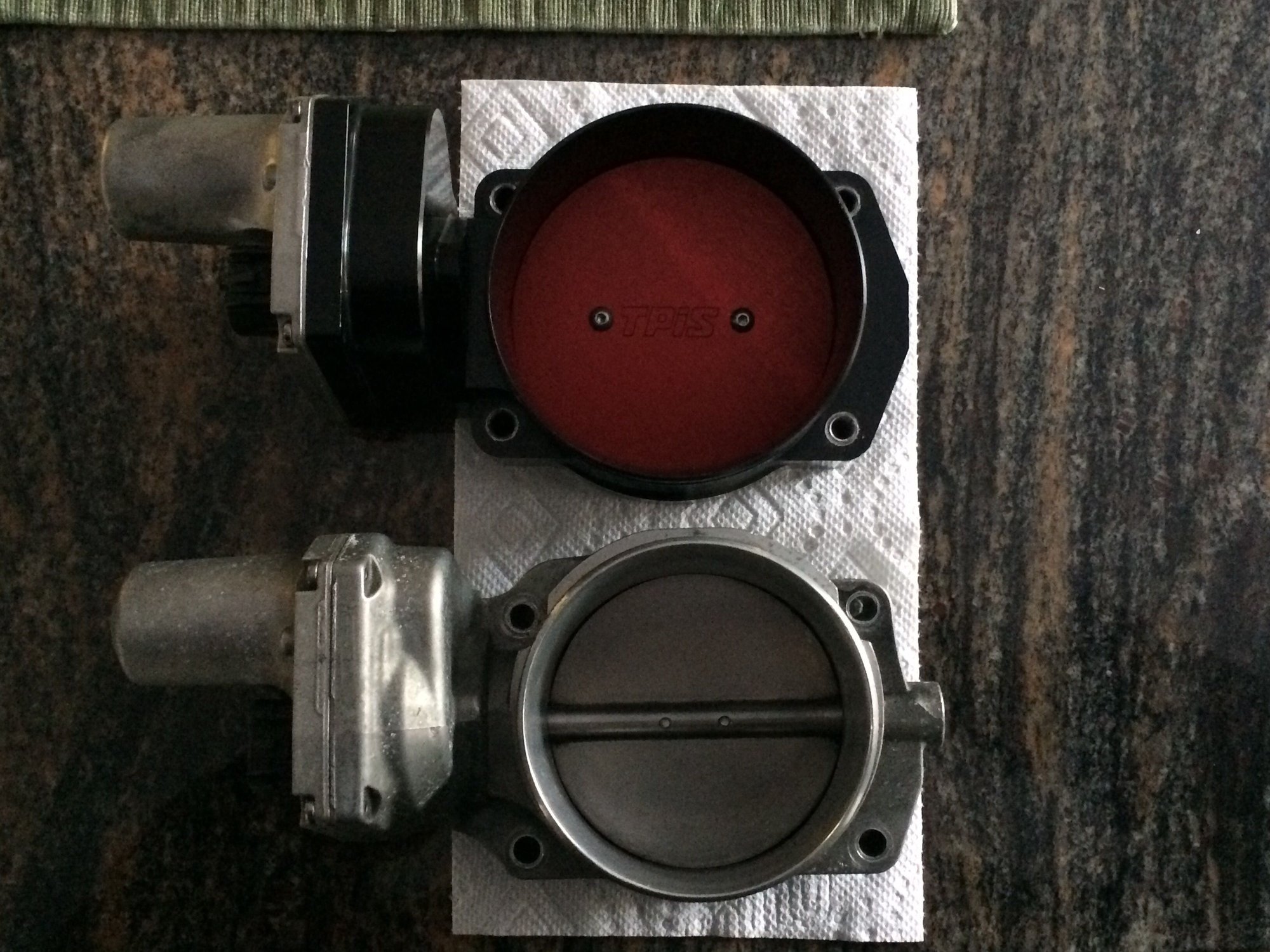

Quick update.
I have a 102mm throttle body that I just put on. In this picture its sitting next to a 90mm ported LS2 throttle body. Fairly big difference. The difference in potantial CFM between the 90 and 102 is huge... That being said it's in desperate need of a tune, but it seems to be working well. I was very afraid of plugging this bad boy in and having the truck go into REP mode as soon as I started to drive it. On the Gen 3 PCM this is a common problem. Going from park to drive the revs flare way up as the PCM tries to increase its airflow. With the 102mm blade a slight crack lets in way more air than the 90 did...
Obviously the running airflow will need to be adjusted as well. It seems the 'seal' around the throttle body blade is only OK... factory throttle bodies seem to be better. I hope that doesn't effect my ability to lower my idle as low as I would like to. Time will tell.

Woah... Big difference
Get her tuned, I wanna know the butt dyno's results
