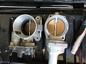

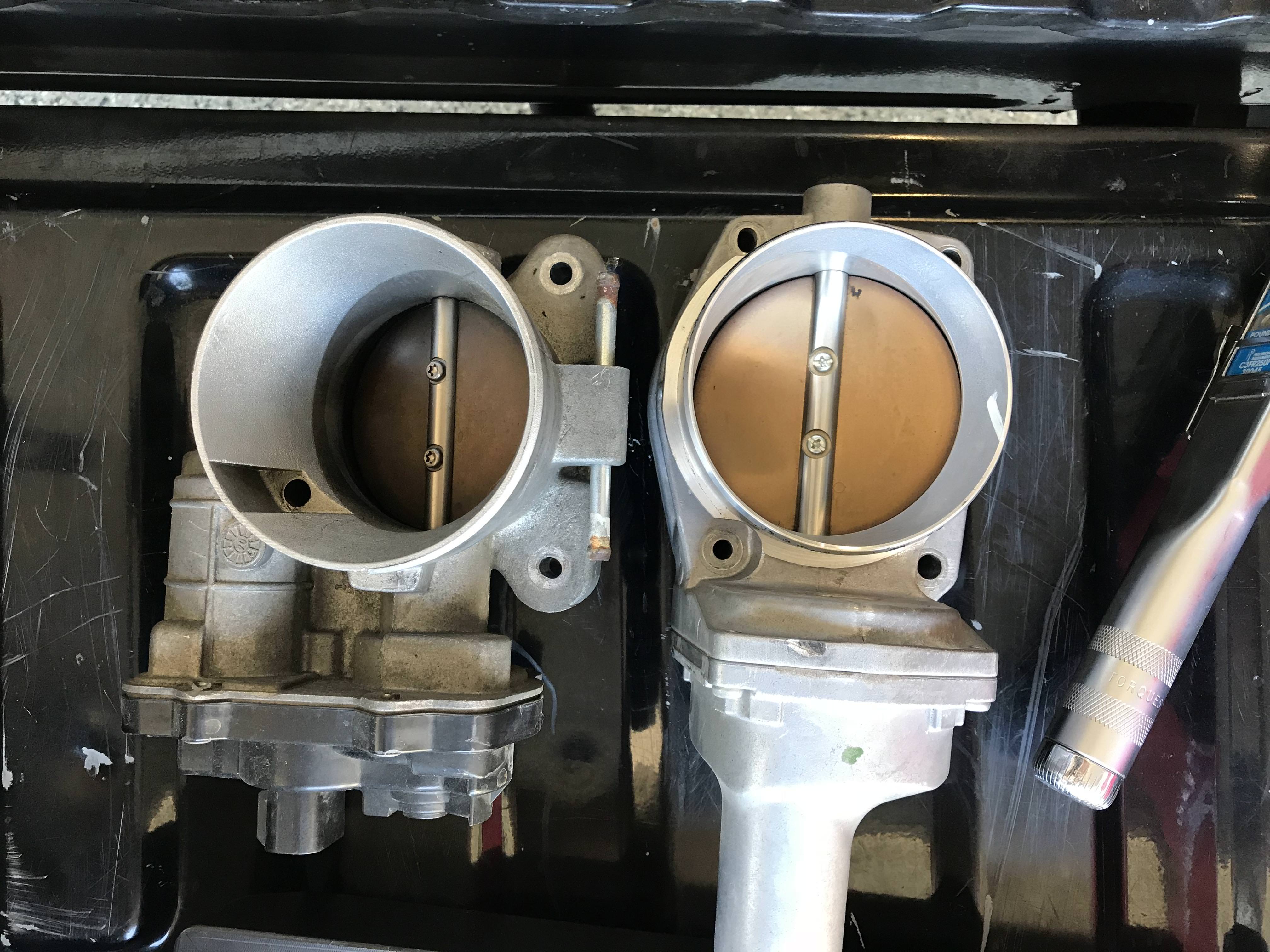

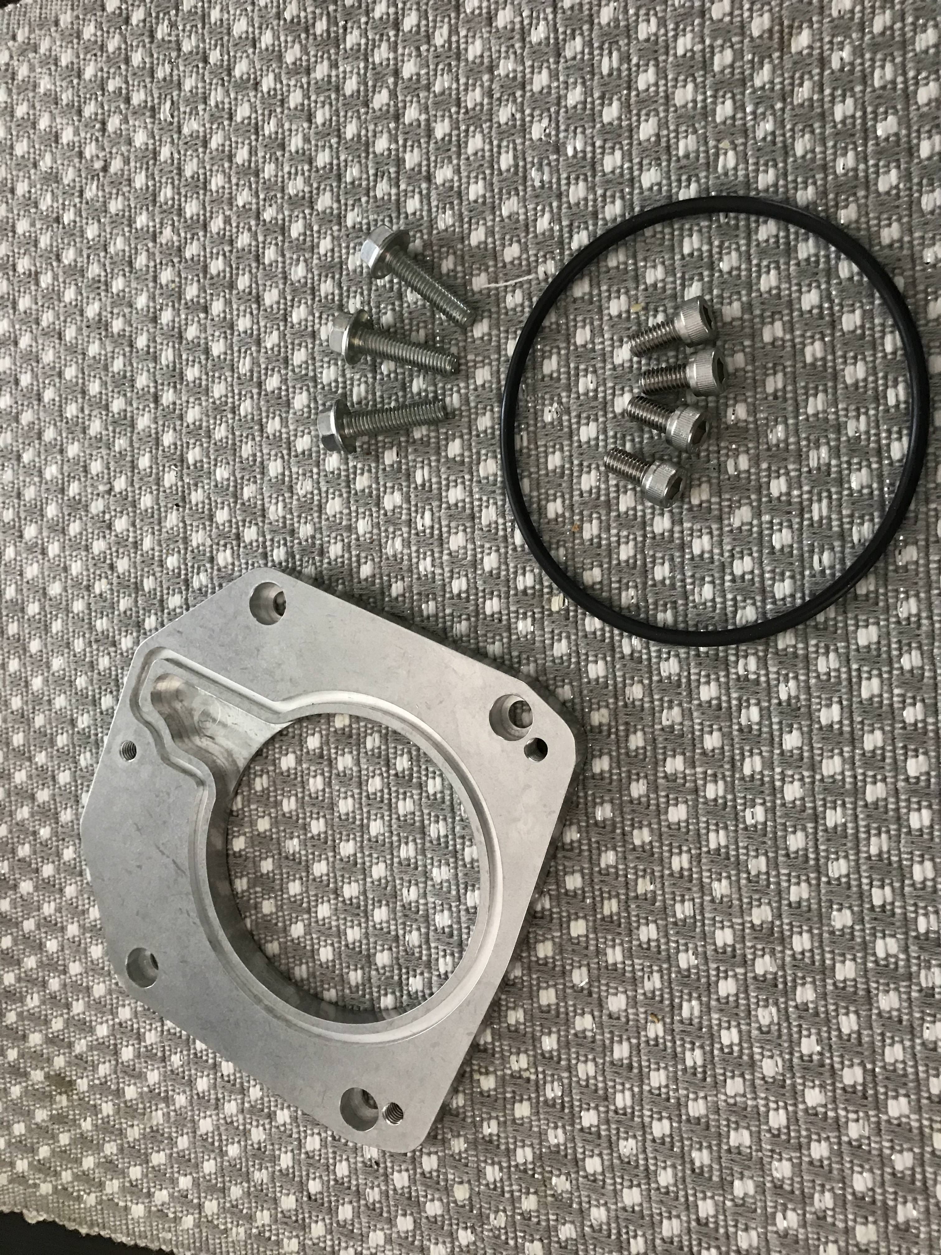

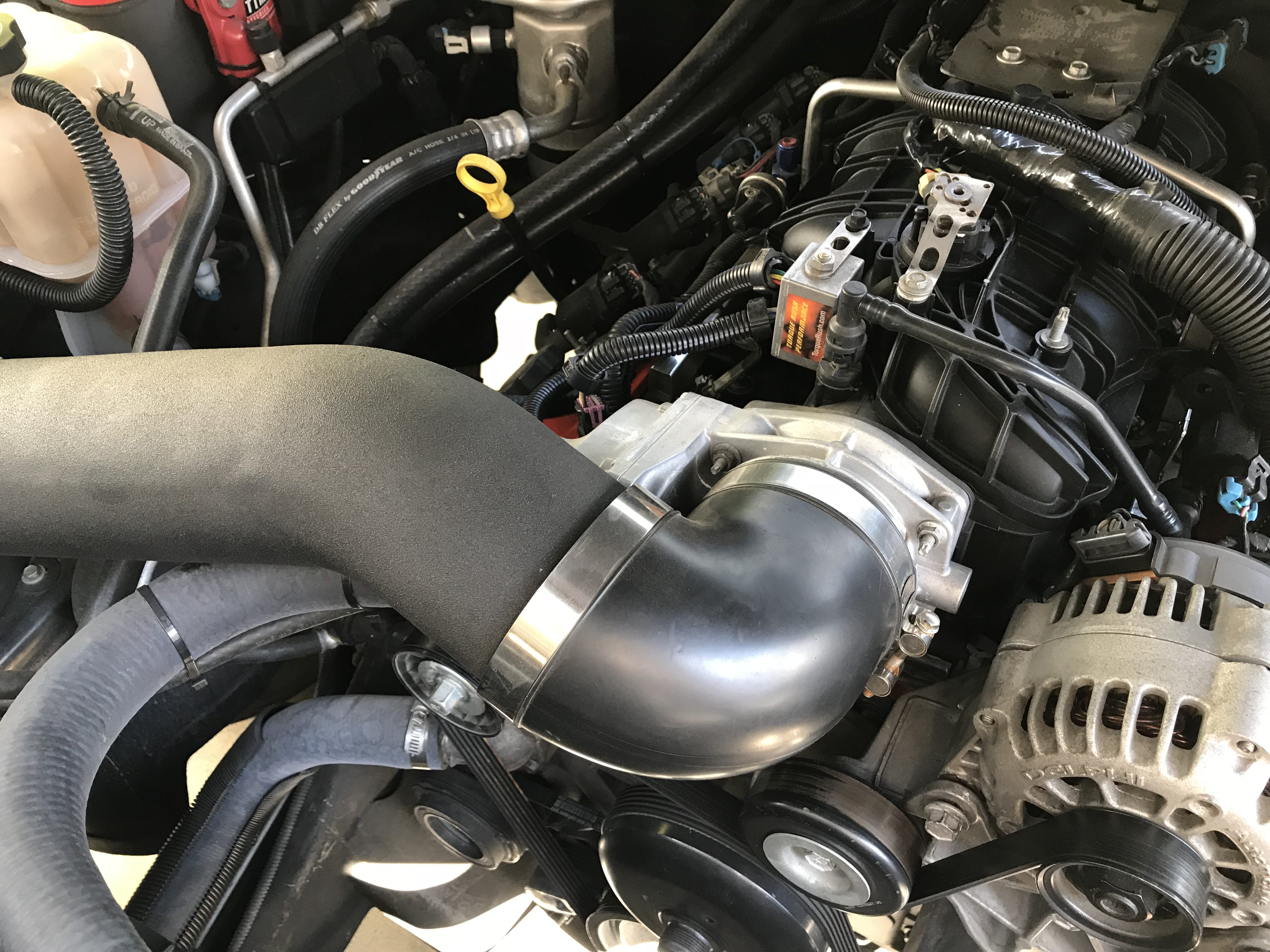

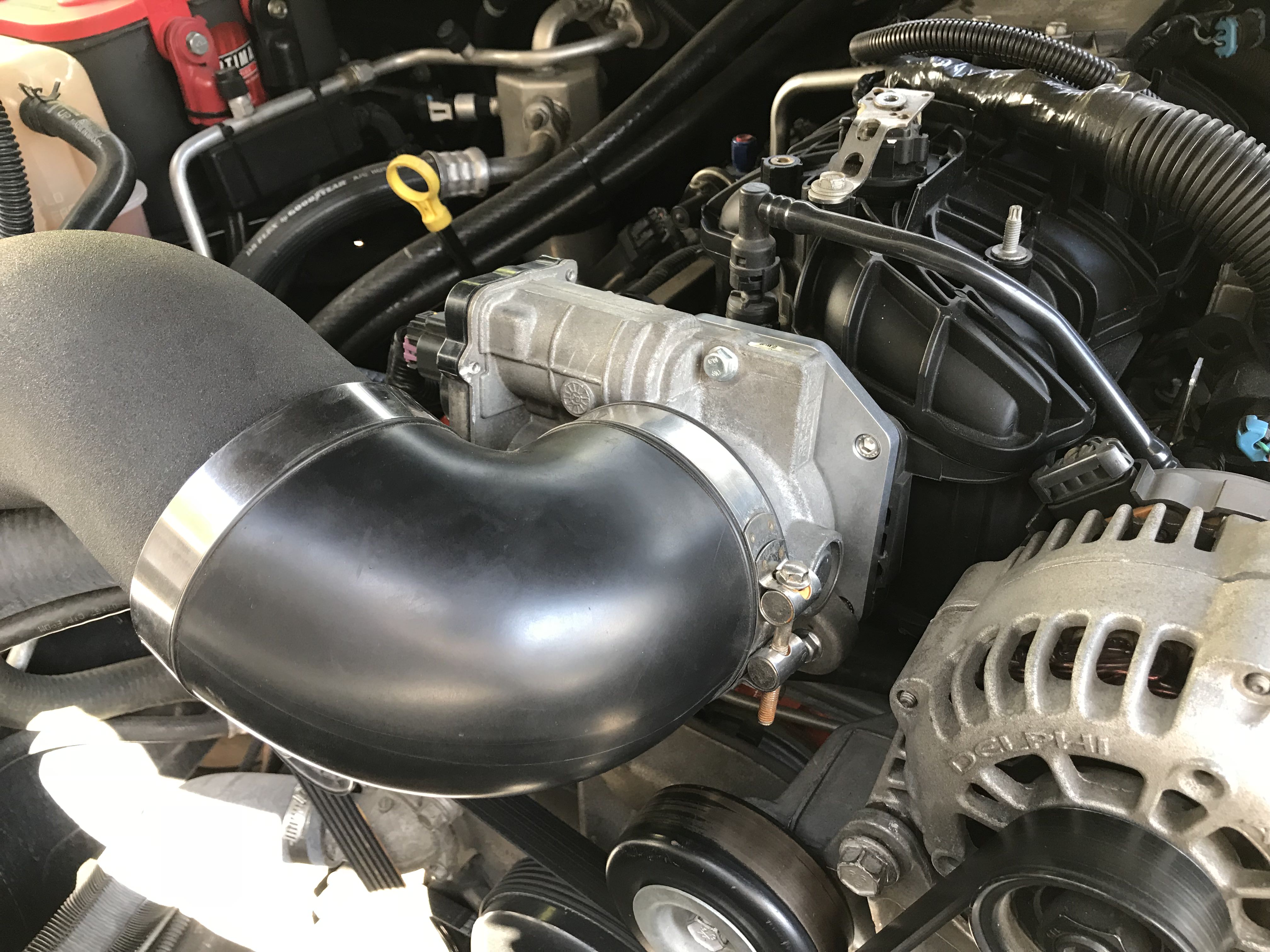

Figured I better update this thread. Had a few issued with the truck after the transmission swap. I was having a throttle issue where the truck would go into limp mode on a long second gear pull. To try and narrow down the issue I swapped the 90mm LS3 and X-Link out for a stock throttle body. This ended up not fixing the issue and kept me from running the truck at one of the autocross events I went to. After looking at the tune file for the 100th time I realized the problem was with the Calculated Airmass vs TPS vs RPM table and Part of the segment swap. Made some adjustments and the problem was fixed.

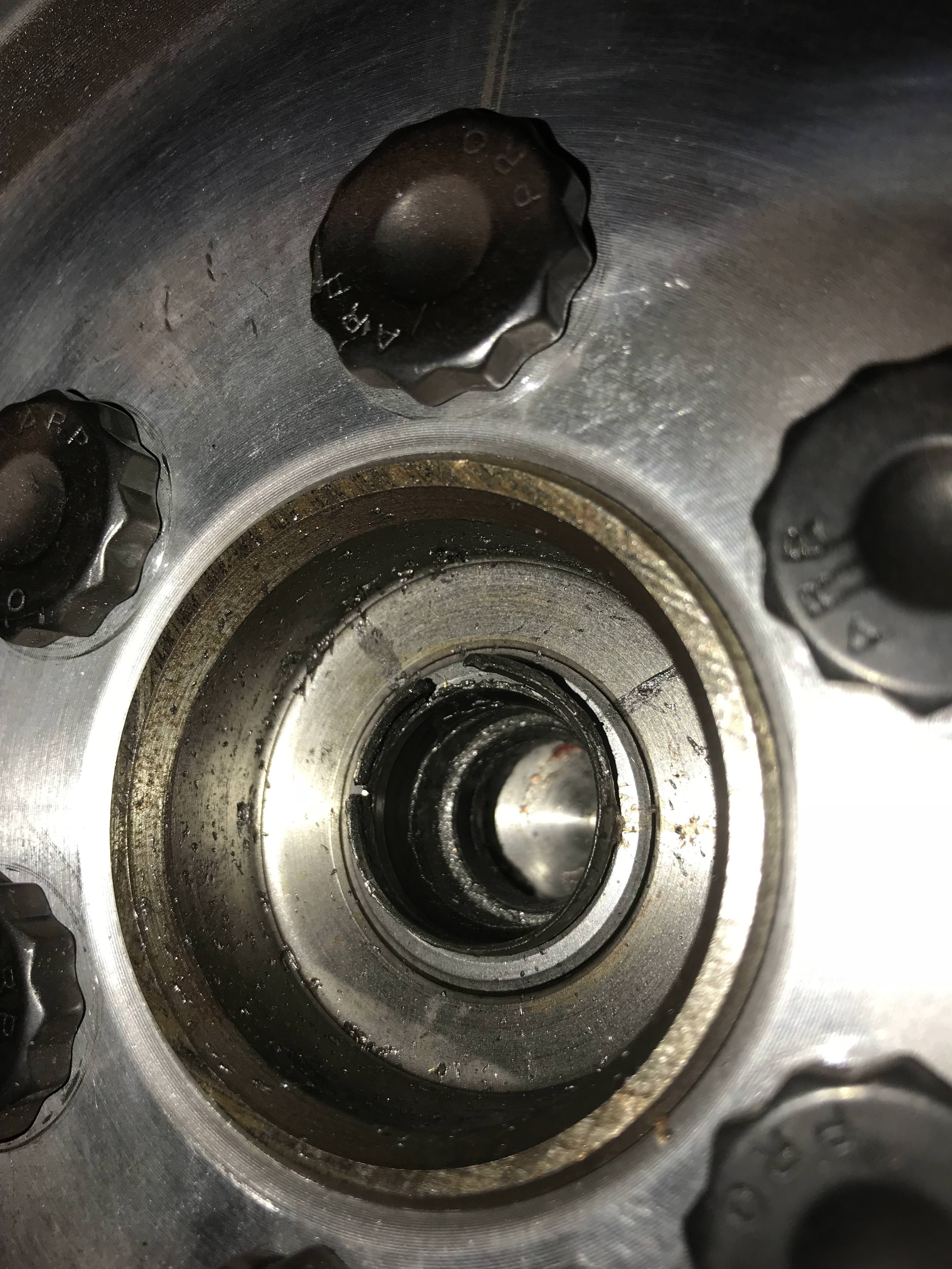

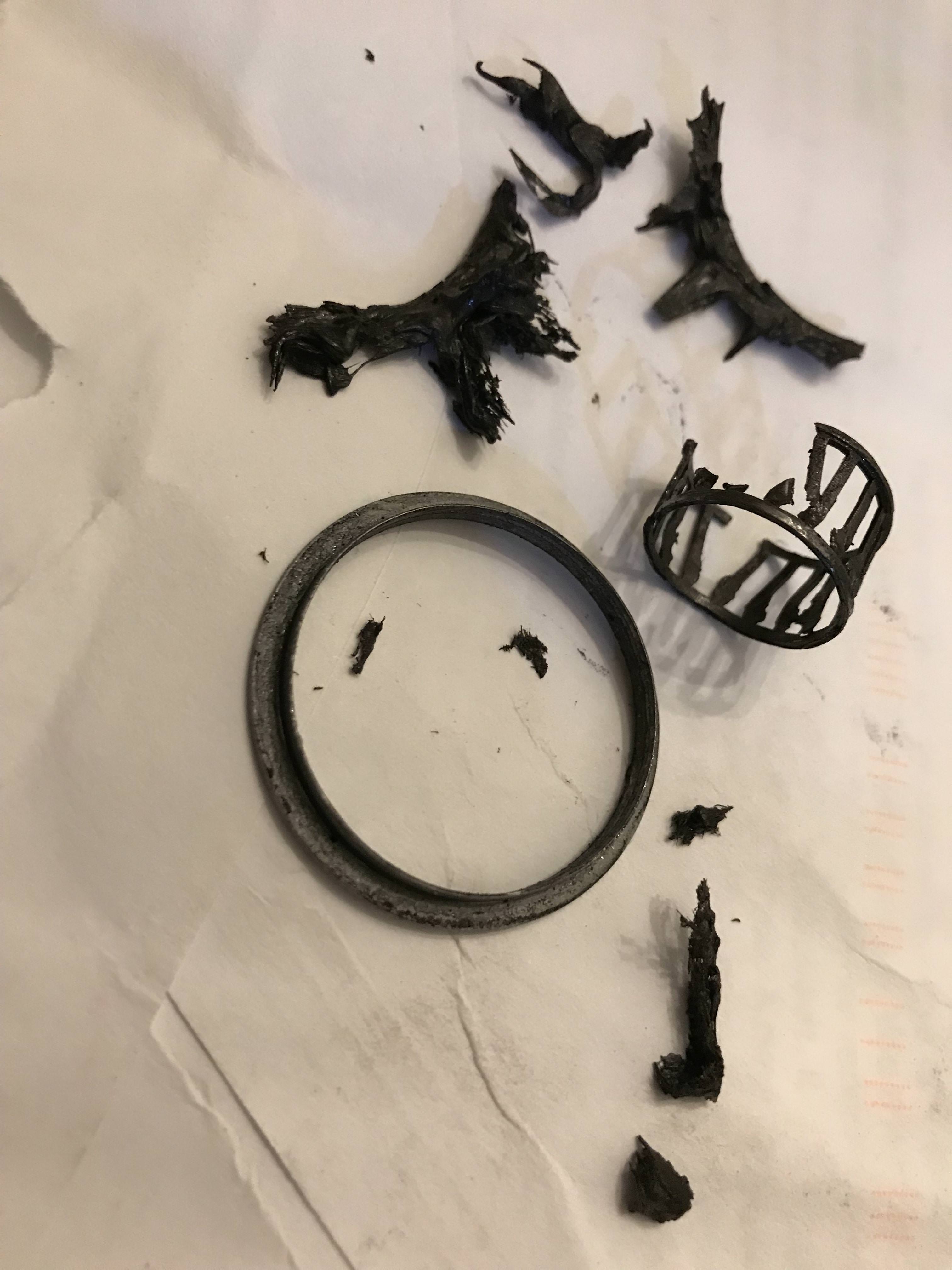

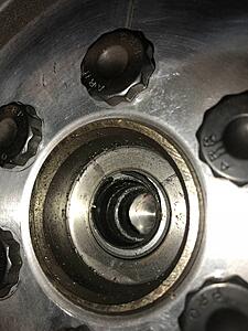

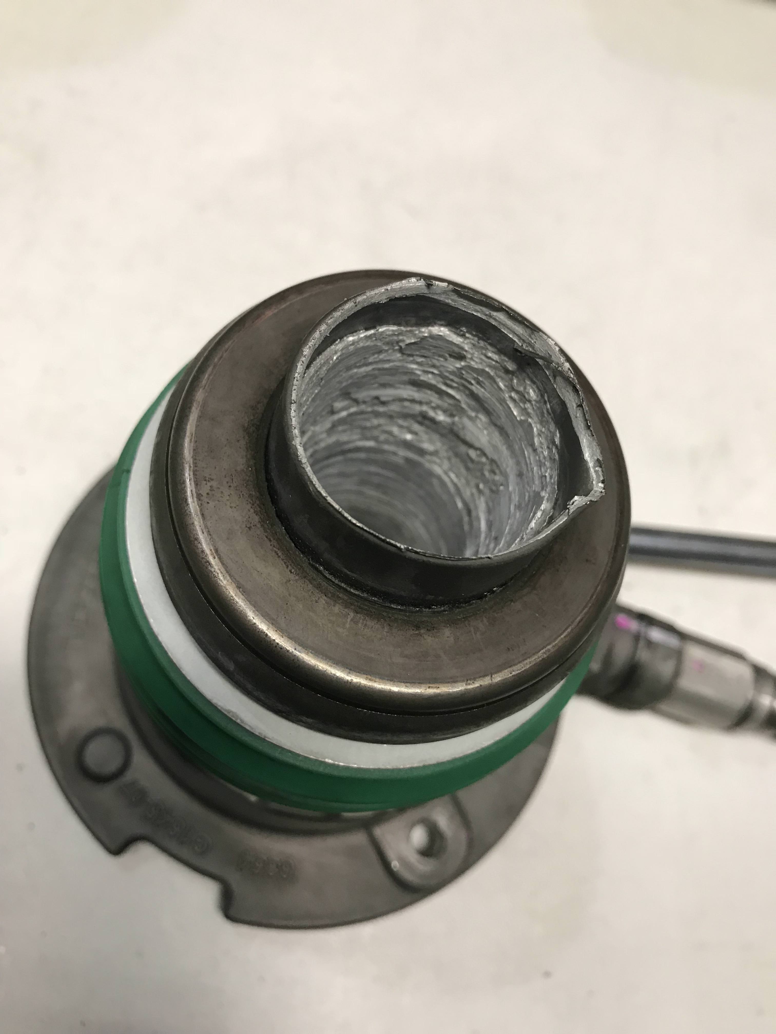

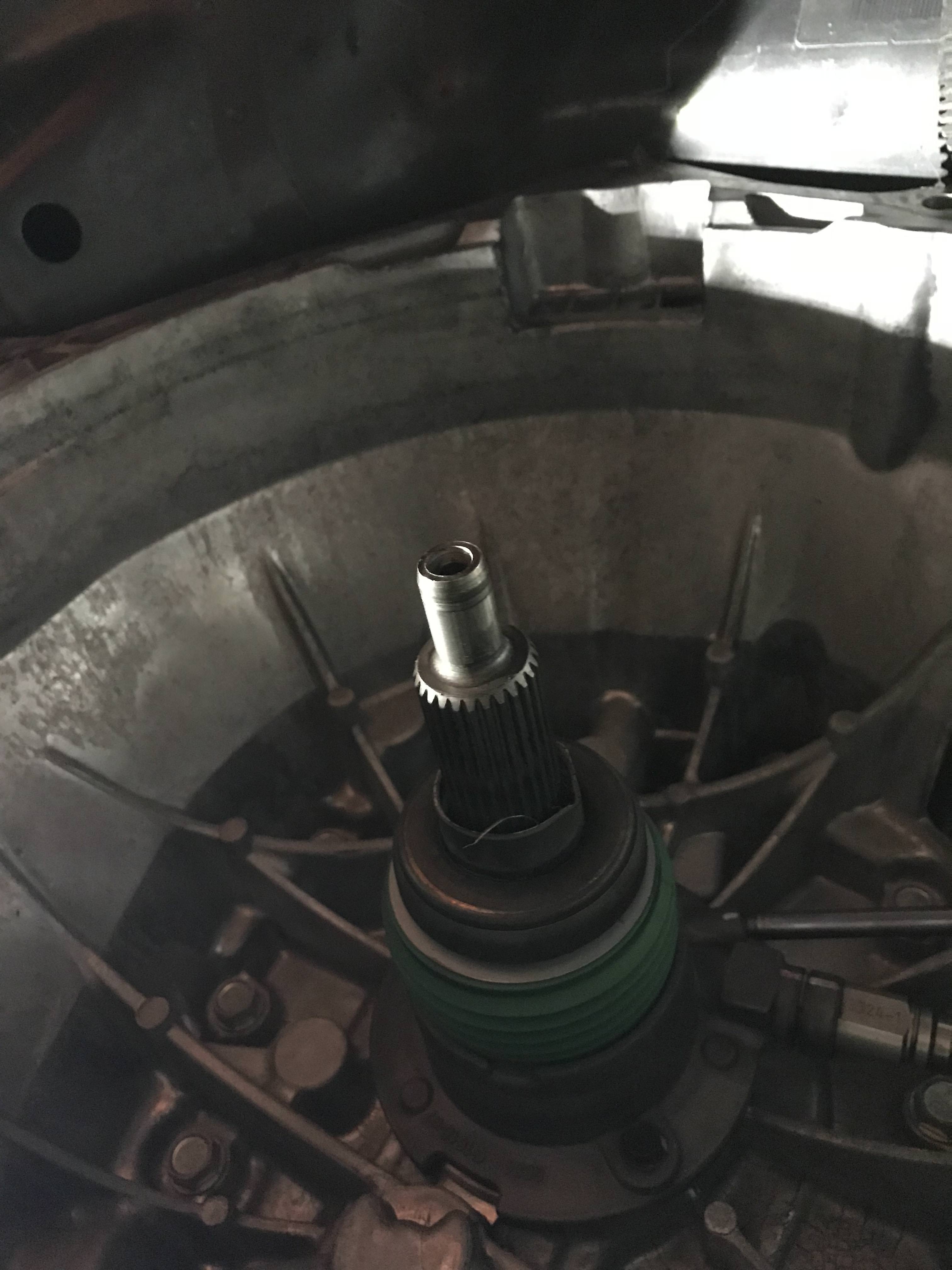

Then at the last NMCA event of the year I got a few runs out of the truck before I lost the clutch. At first I thought it was the throwout bearing locking up, but after towing it home and tearing it apart I found out the pilot bearing failed. Part of it hurt end the sleeve that the throwout bearing rides on and kept it from extending completely. Unfortunately with the pilot bearing out, the input shaft of the trans chewed up the inside of the pilot bearing and now there is a slight amount of play in the input shaft. Going to swap out the input shaft and pilot bearing for a bushing and get the truck back out and get it dialed in.

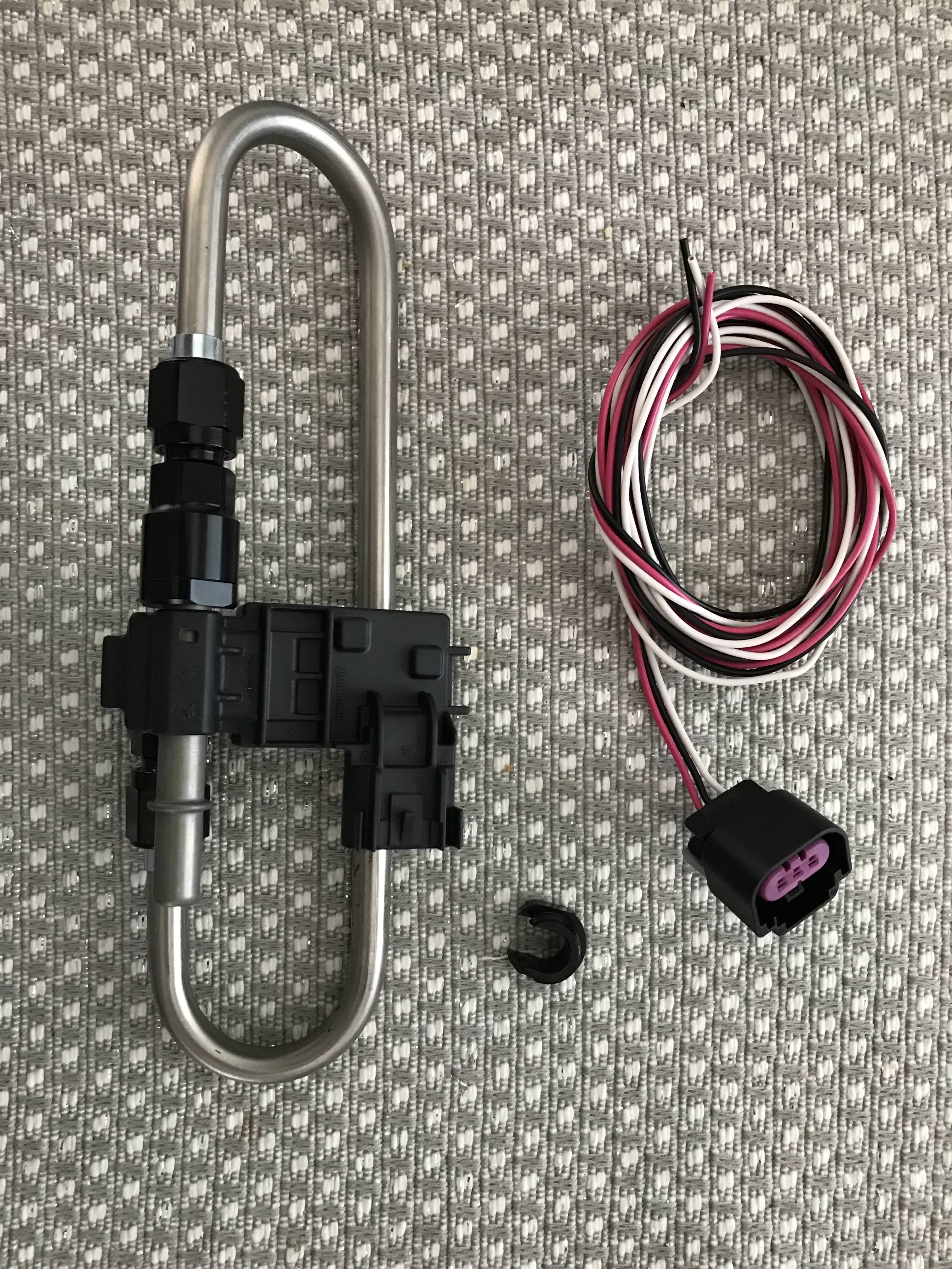

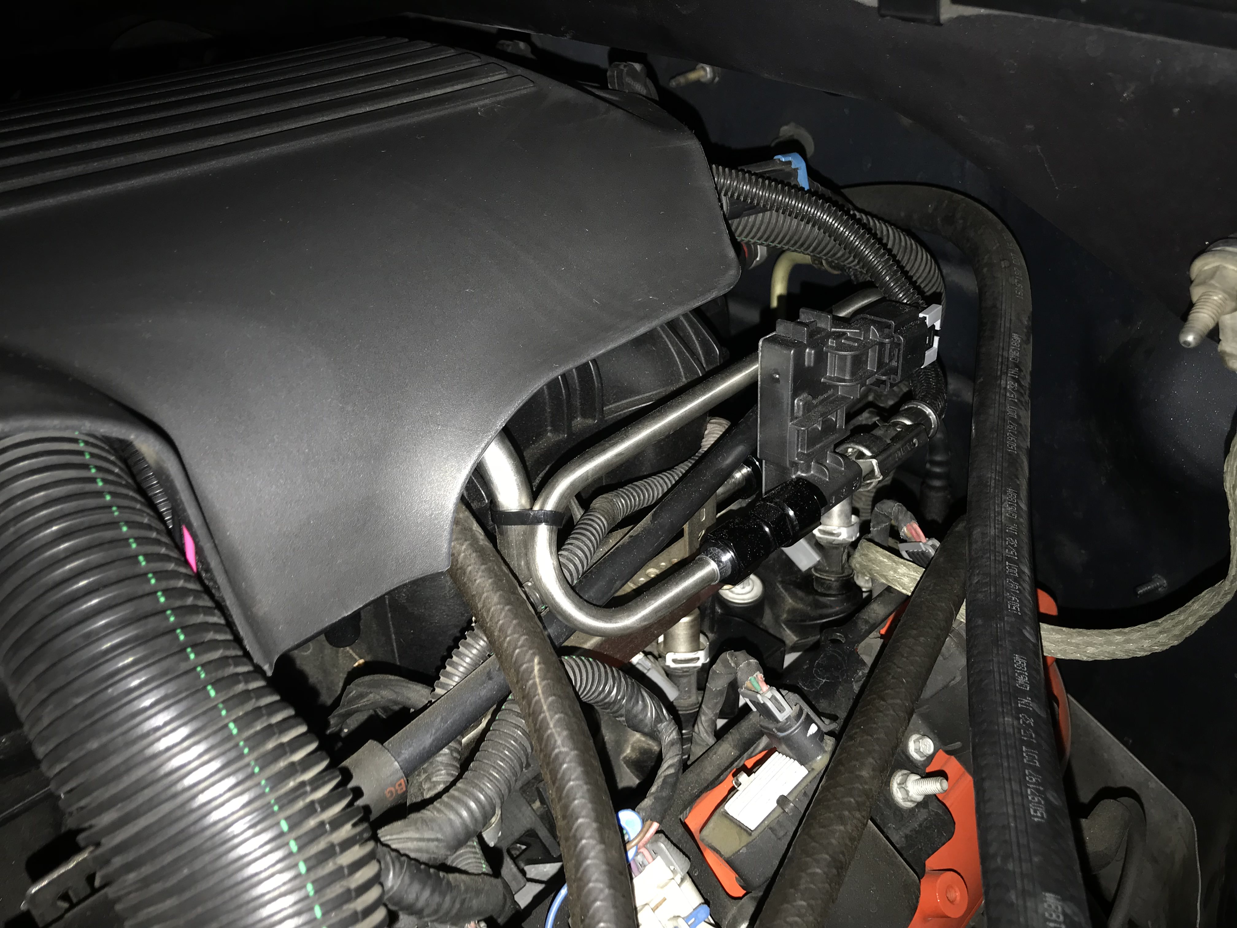

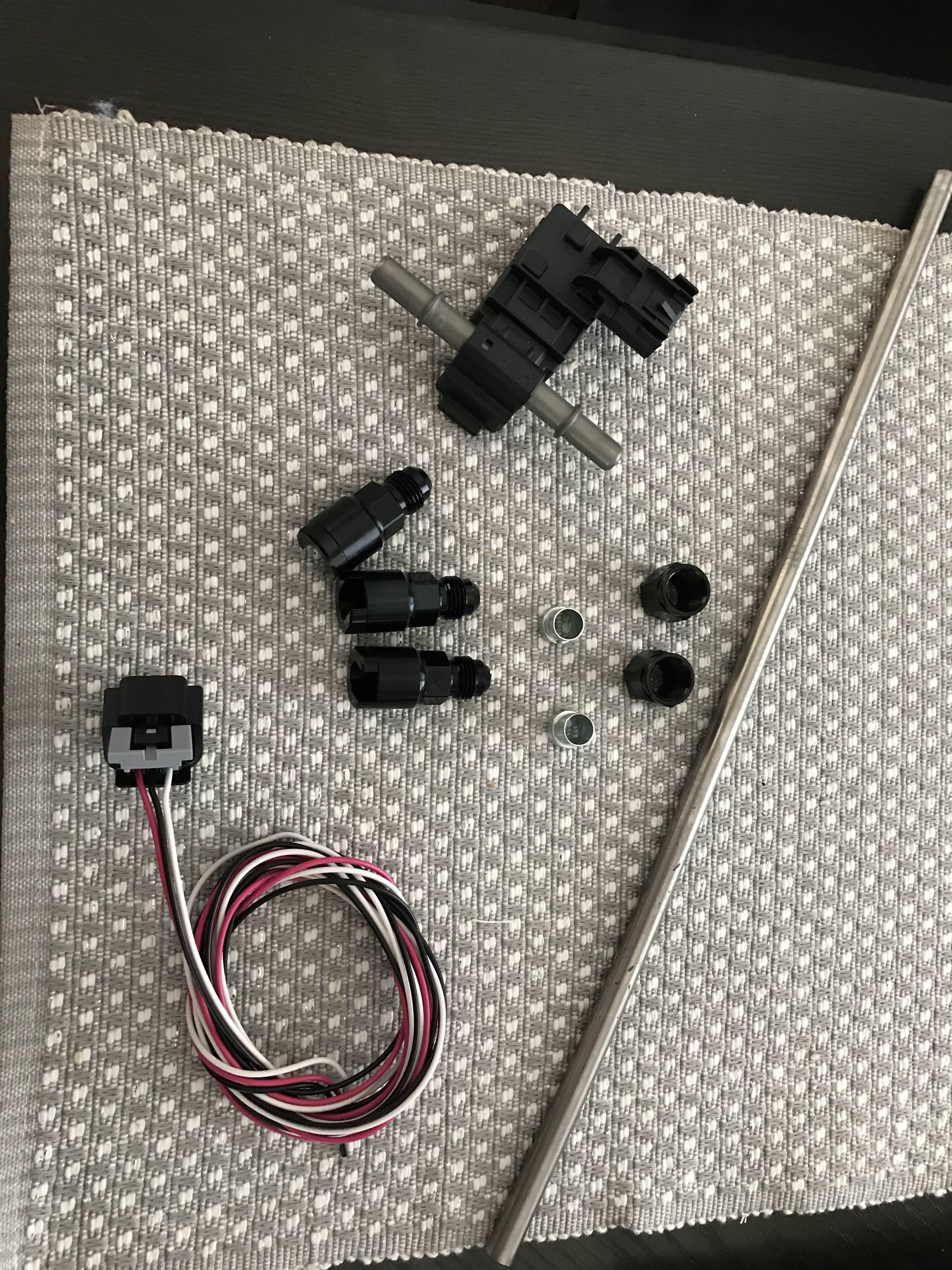

While the truck was dawn I also started my own Flex Fuel conversion. Which I had wanted to do for a while. After seeing a few companies' setups I realized I had almost all of the pieces leftover from other projects to build my own. Not bad for less than $100 in parts. Haven't messed with the tune part of it yet, but I will when I get the truck back up and running.
